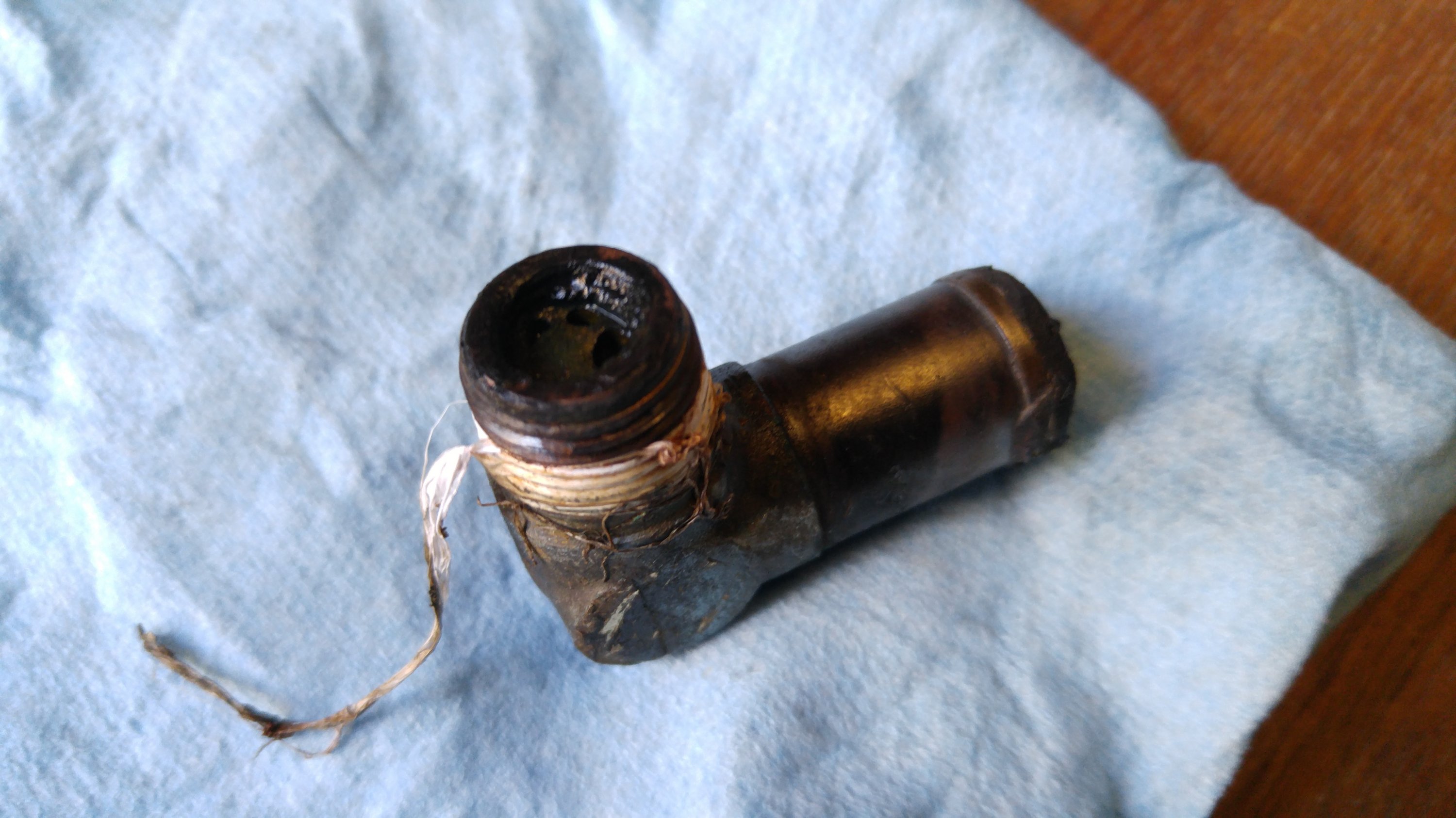

542
klidescope 30t norfolk
I had one looked just like Allen's something about the heat and salt water my mixing elbow was clogged 50% as well I put a wire plumbers brush on drill to clean out to get thru season then replaced elbow over winter
