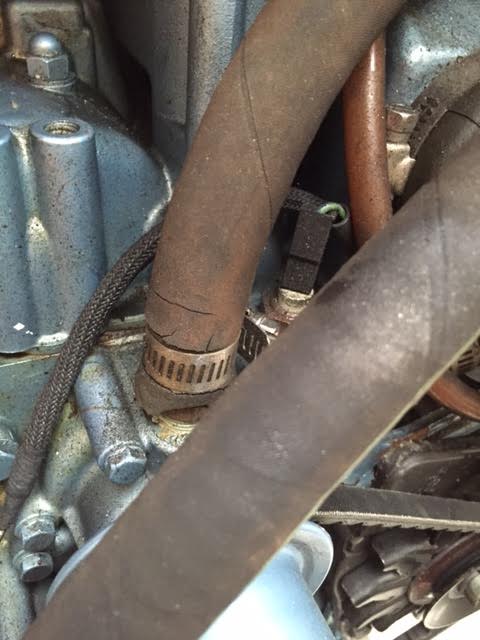

Hi everyone! I just bought a 1994 Catalina C270 LE and the surveyor said I should replace a hose on its Perkins M20 103-06 before they start leaking. He also sent me a picture of the cracked hose. I have not yet taken delivery of the boat but am trying to queue up parts for when it arrives on May 10th. Can anyone tell me what the brownish colored hose (with the cracks) is for behind the water pump hose? I cannot find it on any diagrams or in any pictures I look at on-line. Sorry that I do not have a more distant photo but it is the only one the surveyor took.
Thanks for your help! Scott

Looks like a coolant hose to/from a water heater. The other one in the foreground is probably the other hose to/from the water heater. A good high quality automobile heater hose works there..

To all, thanks for your help. The hose I had a question on indeed looks like it runs to the water heater.
