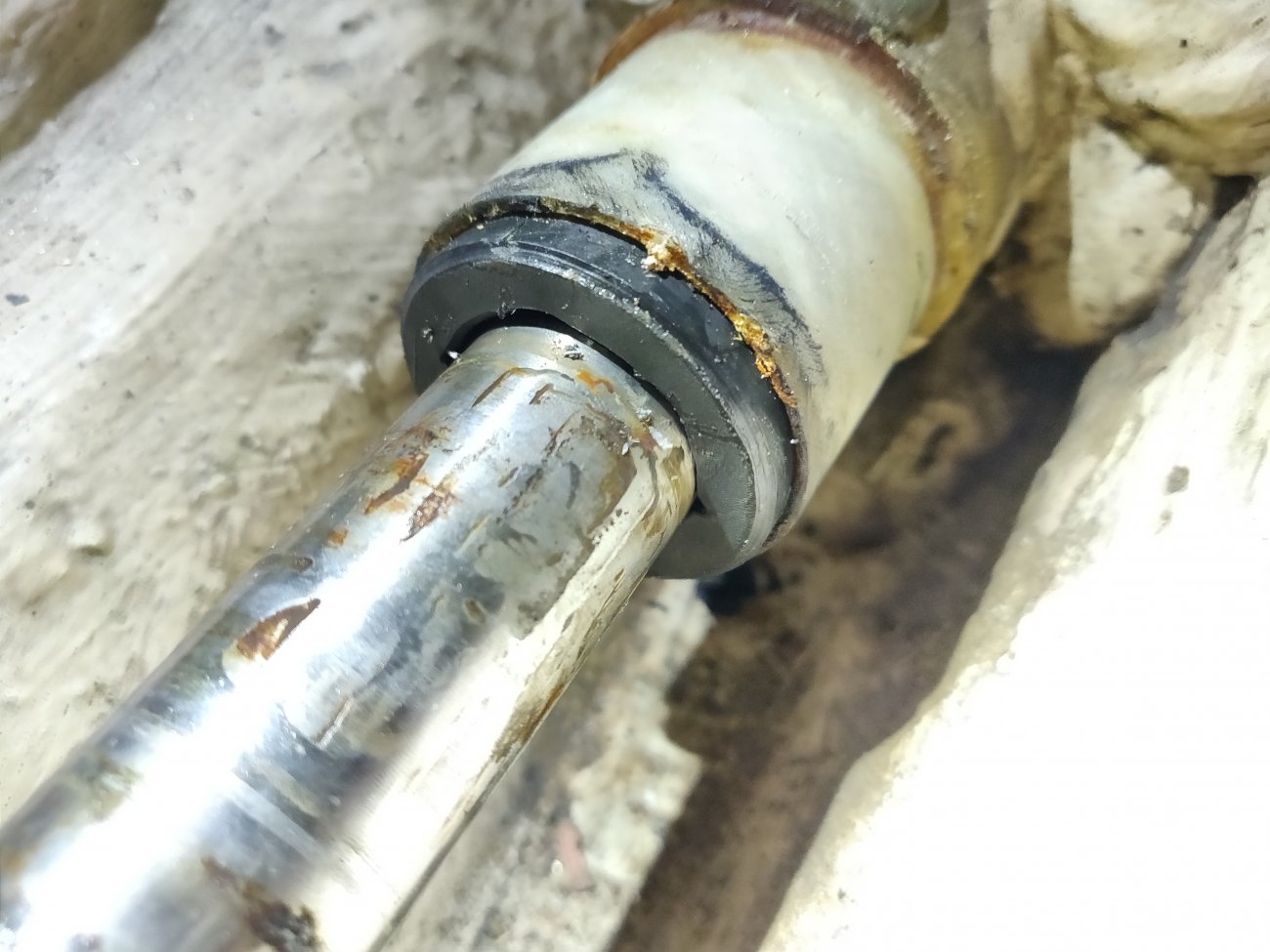

The shaft appears to be too scarred to establish a seal.

Interesting. I haven't replaced my shaft seal yet, so not quite sure what's inside. I lubricate the seal annually with Volvo seal grease and it doesn't leak a drop. Gunni, I agree with you, looks like the shaft is too scarred for the seal to function without leaking. Looks almost like "pipe wrench" gouges. Mechone, Do you have a part number for the Volvo seal installation tool? This is the first time that I have heard about the tool. Will likely change my seal & cutlass bearing on next haul out,
The seal is presently 12 years old; however, motor only has about 300 hours on it.

Those shaft marks make this job a good candidate for a PSS type seal.

The marks on the shaft seem to be dried grease. I'm launching in two weeks as I need this boat in the Hamptons to sleep on. Soooo.... I'm going to clean up the shaft, grease everything up and hope for the best. I can't be without a floating bedroom near my work. Will tackle this job next fall . I motored 150+ hours last year without leaks.

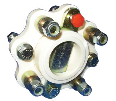

My shaft looked like that it,s not a pipe wrench , it's galvanic corrosion, where the seal sits. Instead of buying a new shaft ,I added a flex coupling moving the shaft back onto a new surface, and then added a galvanic isolator from England ( safeshore marine UK) a lot cheaper higher amp rating, life time warranty with display off ebay . It also allows you to add a bigger anode, rope cutter,RD%20Shaft%20Coupling.jpg between prop and cutlass. R&D coupling

Great recommendations to add the flex coupling to move the shaft aft. I really like the additional advantage of being able to use a larger shaft zinc. Did you notice a significant difference in anode depletion after adding the isolator? I really don’t have much, if any vibration in the drive train at cruising RPMs. Did you notice any reduction in vibration after adding the flex coupling?

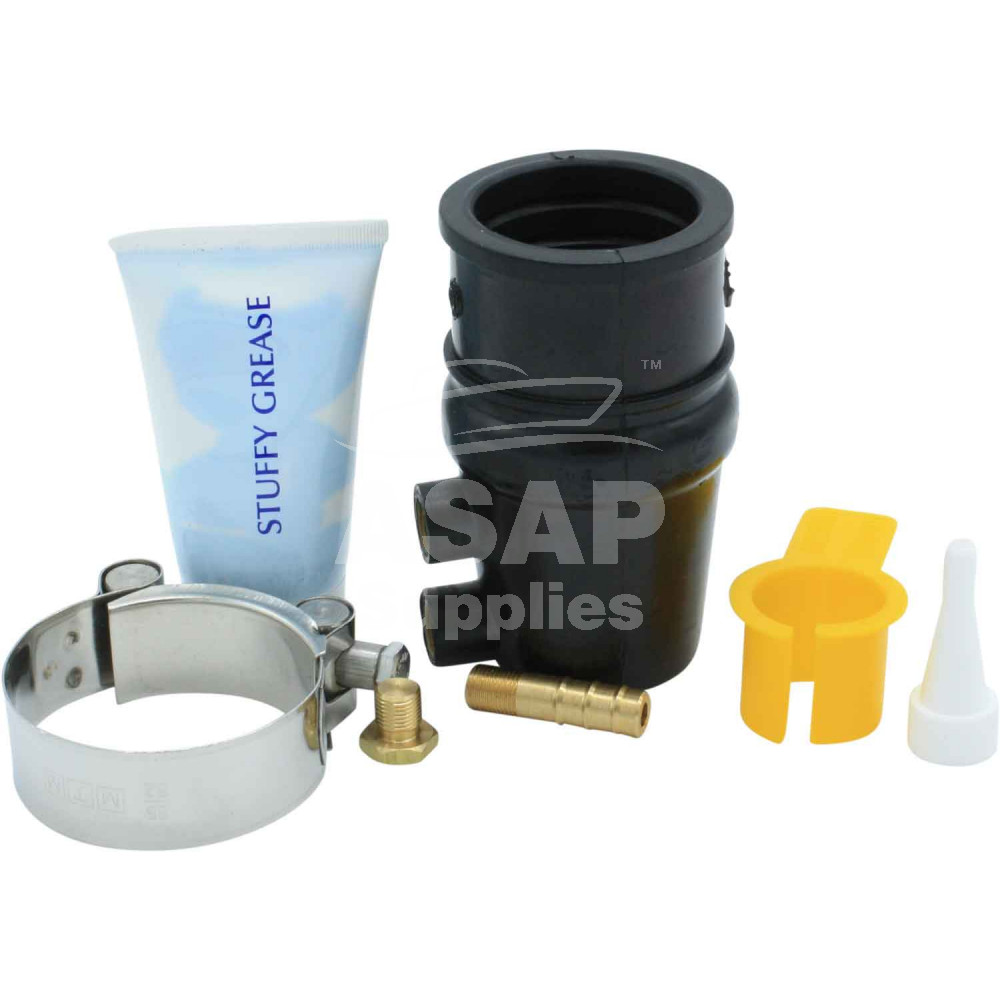

For those who contemplate replacing Volvo-Penta shaft seal on their boats, check improved design by Orbitrade, sold in UK by asap-supplies.com. Flexible shaft seal has port for greasing and removable barb fitting for water lubrication. However not all shaft seal dia are available with this features.
ASAP Supplies will put other stuff in the box for one shipping cost. Ask for hard copy Catalog of Marine Products. Prices on Web Catalog.

One more comment to a discussed subject. I also installed on my sailboat R&D flex coupling for absorbing some shocks when shifting and very easy and convenient check of shaft/transmission alignment. Adding this coupling without shortening the shaft, however, moves propeller further away from the cutless bearing support.
General rule is to have propeller located at approx distance of shaft dia. Incresed distance with not properly balanced prop may increase vibrations. Prop striking floating object may also result in bent shaft.
