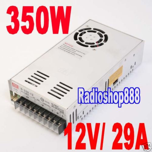

For a long time I used my marine battery charger to run my 12v Adler Barbour freezer. 24/7 off the battery house bank. With a constant draw on the batteries. The battery charger would monitor and charge batteries as needed. This means that there was a constant working load or draw down on the house battery bank. Which the battery charger had no problem doing . But after having a ground failure on circuit board of 10 year old battery charger and freezer as well as other loads that totally depleted my battery bank 2 down to about 3 volts. When boat was left unattended for a few weeks.
After I repaired the grounding issue on battery charger I decided that the continuous 12 volt power supply was the way to go for me.
By using a 120 volt to 12 volt regulated continuous rated power supply while on shore power at the dock I believe this may help extend the life of my charger as well as house battery banks. The power supply I found is marine rated and is large enough that it can take and run other 12 volt loads.
So for me.... and my needs the new setup is working great and I have been quite pleased.
