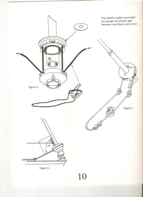

Time Out . Jul 28, 2009 38 Catalina 27 Lake George NY Jul 22, 2010 #3 The manual for my Hood model 810 says to use a loop of 7/16" line. I attached the pages out of my manual that refer to the line size. Attachments scan0007.jpg 21.5 KB Views: 449 scan0006.jpg 27 KB Views: 1,796
