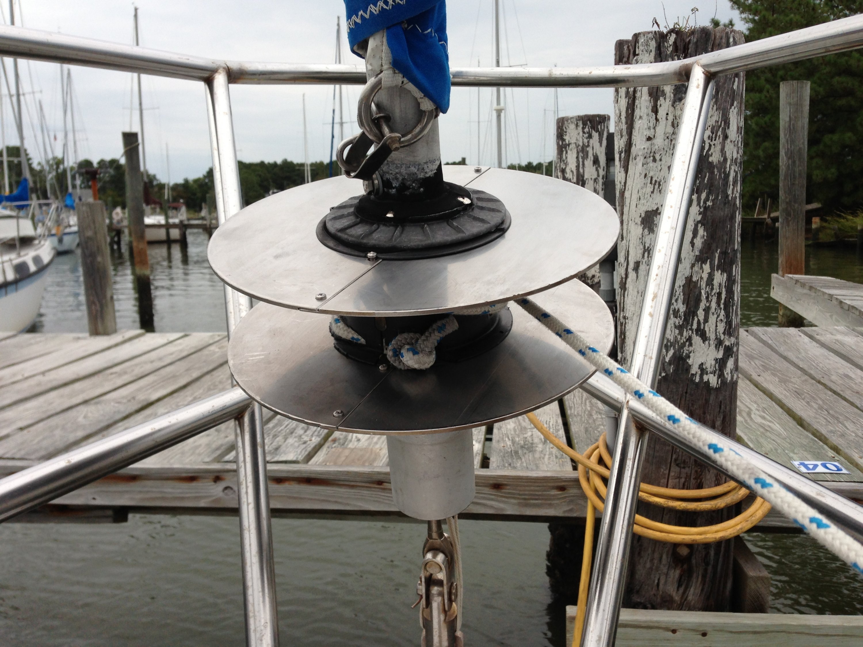

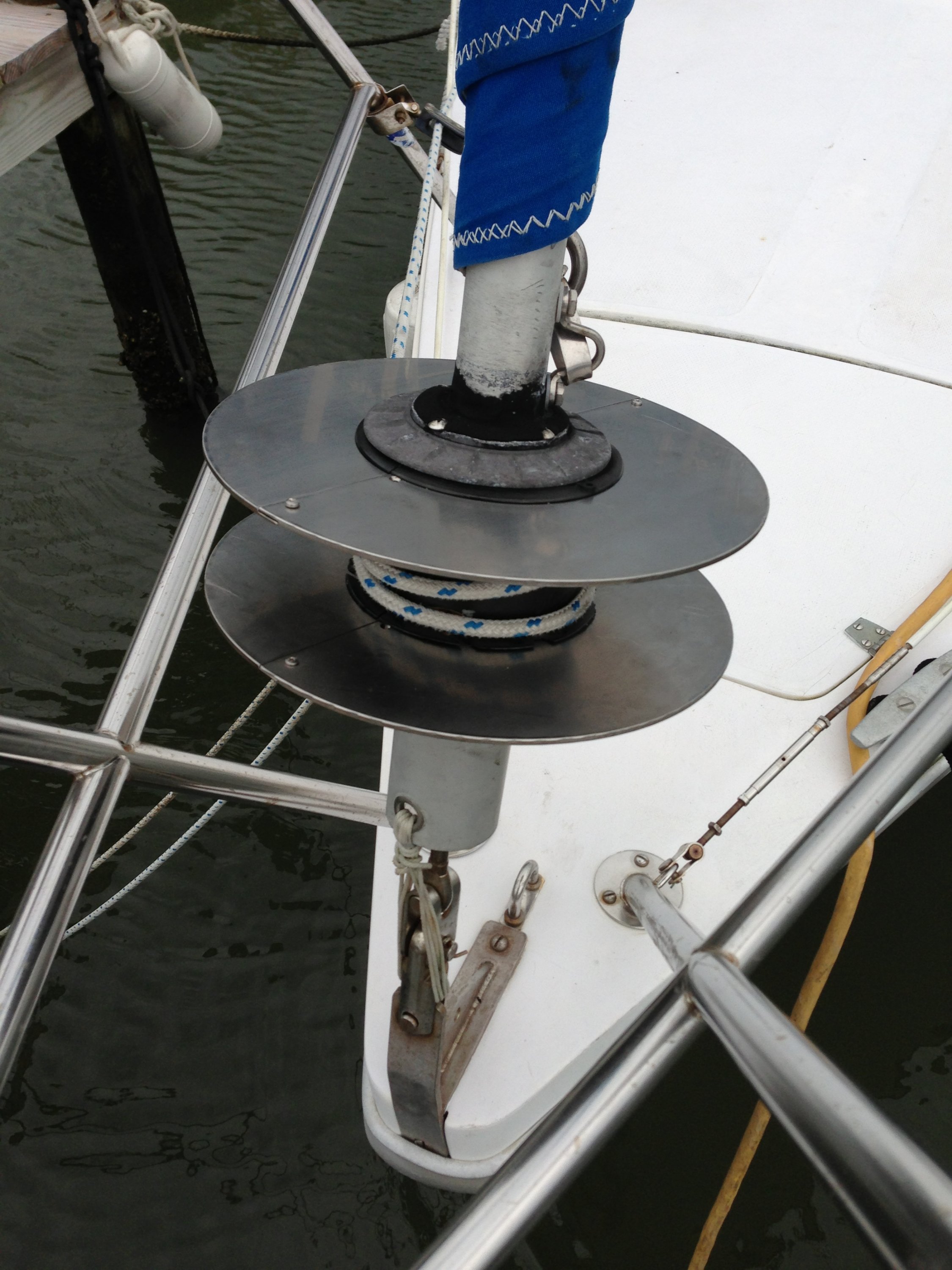

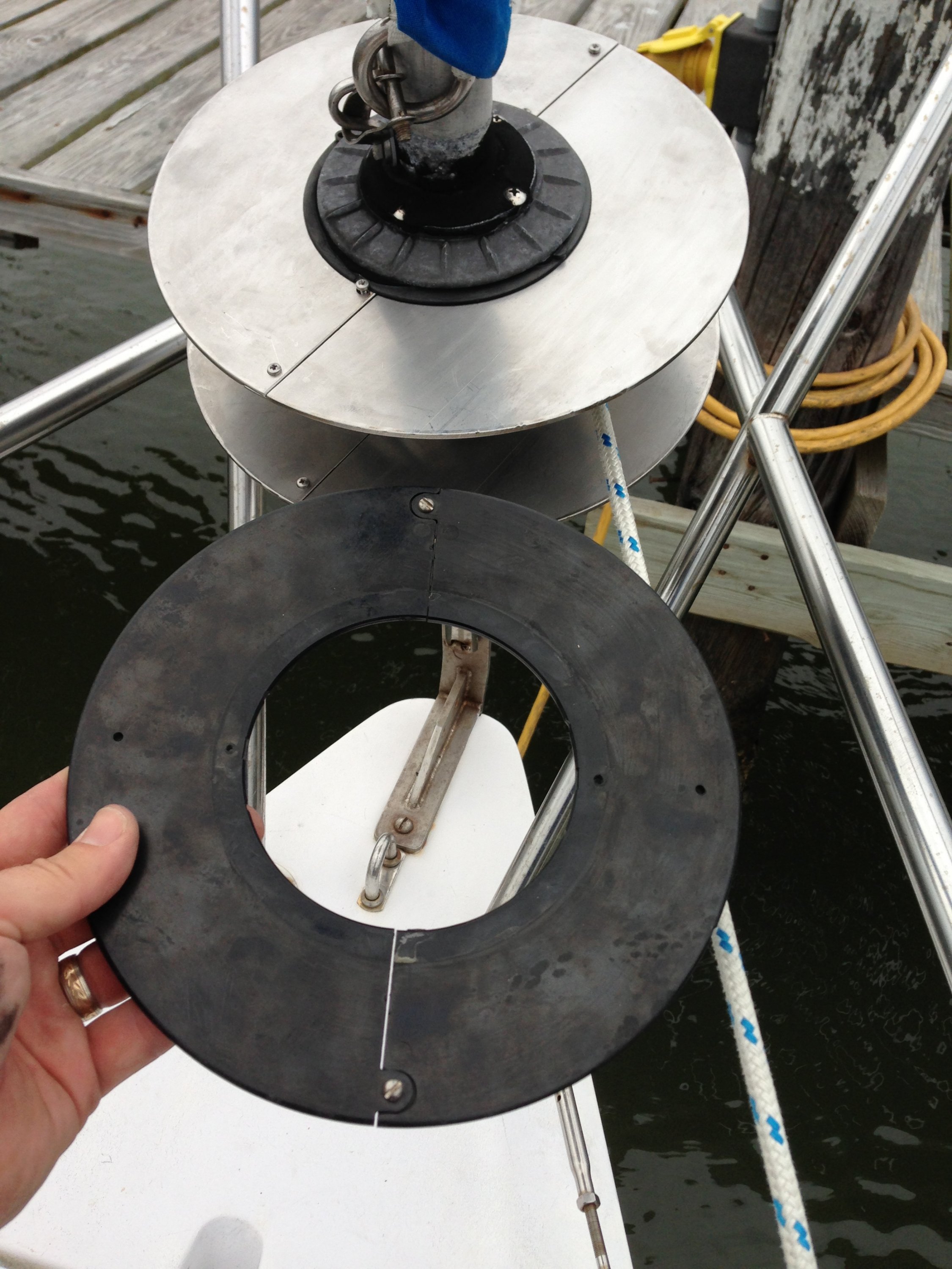

1,294
I also have a hood Furler. Mine was a single line furler, converted to an 800 drum type. My advice is don't drill out those pins unless you really have to. Most of the parts for older Hood units are considered obsolete by Hood, & they no longer manufacture many of these parts. I had the upper plate on my furler break in half while under a heavy load in 25 knot winds. It was an ABS plastic plate & met its maker. I contacted Hood & all of their subsidiaries only to hear that most older Hood parts are no longer made or sold. This is because they don't support furlers more then 10 years old anymore, cause they want to sell you a new one. Unfortunately not everyone is as friendly as Catalina Yachts to do business with. I had my Hood furling drum plates replaced with heavy gauge stainless steel plates that kick the ass of the original Hood ones. Now I could stand on the furler, if I wanted to.
