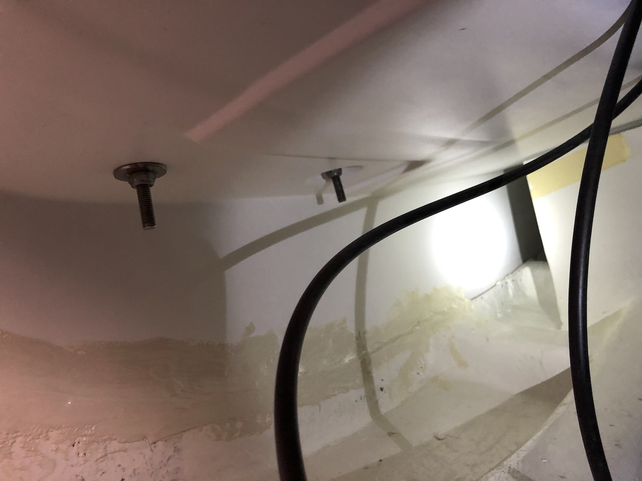

A few pics.

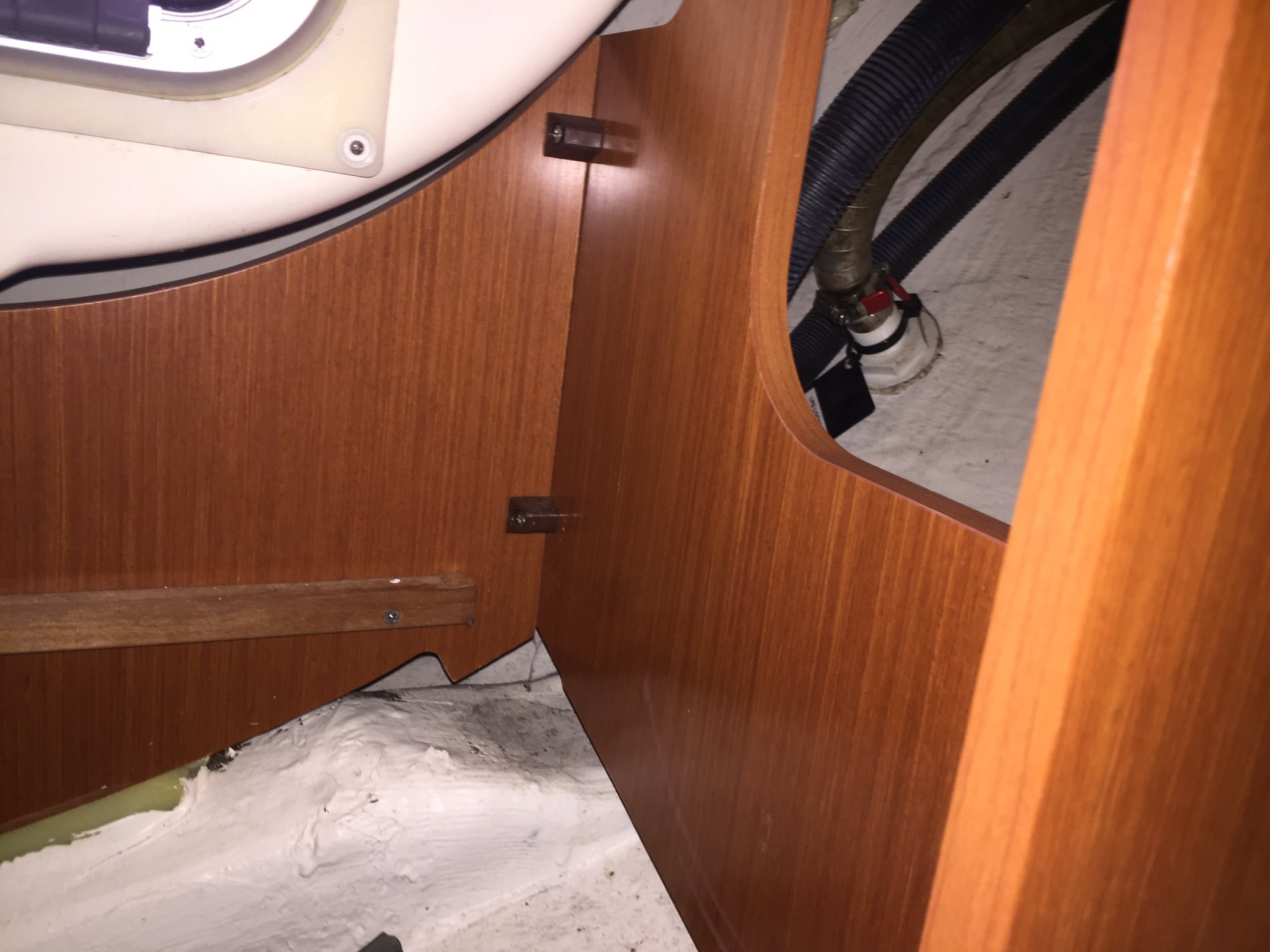

The panel in the photo above, how is it attached to the side panel, farther outboard (below the access panel located inside the life raft locker)? Beyond the right side of your photo. I suspect that I have at least one fastener that is covered in epoxy or some other wood colored cosmetic cover-up... who knows why. I cannot get the panel in the photo to come out, it's still secured to something.

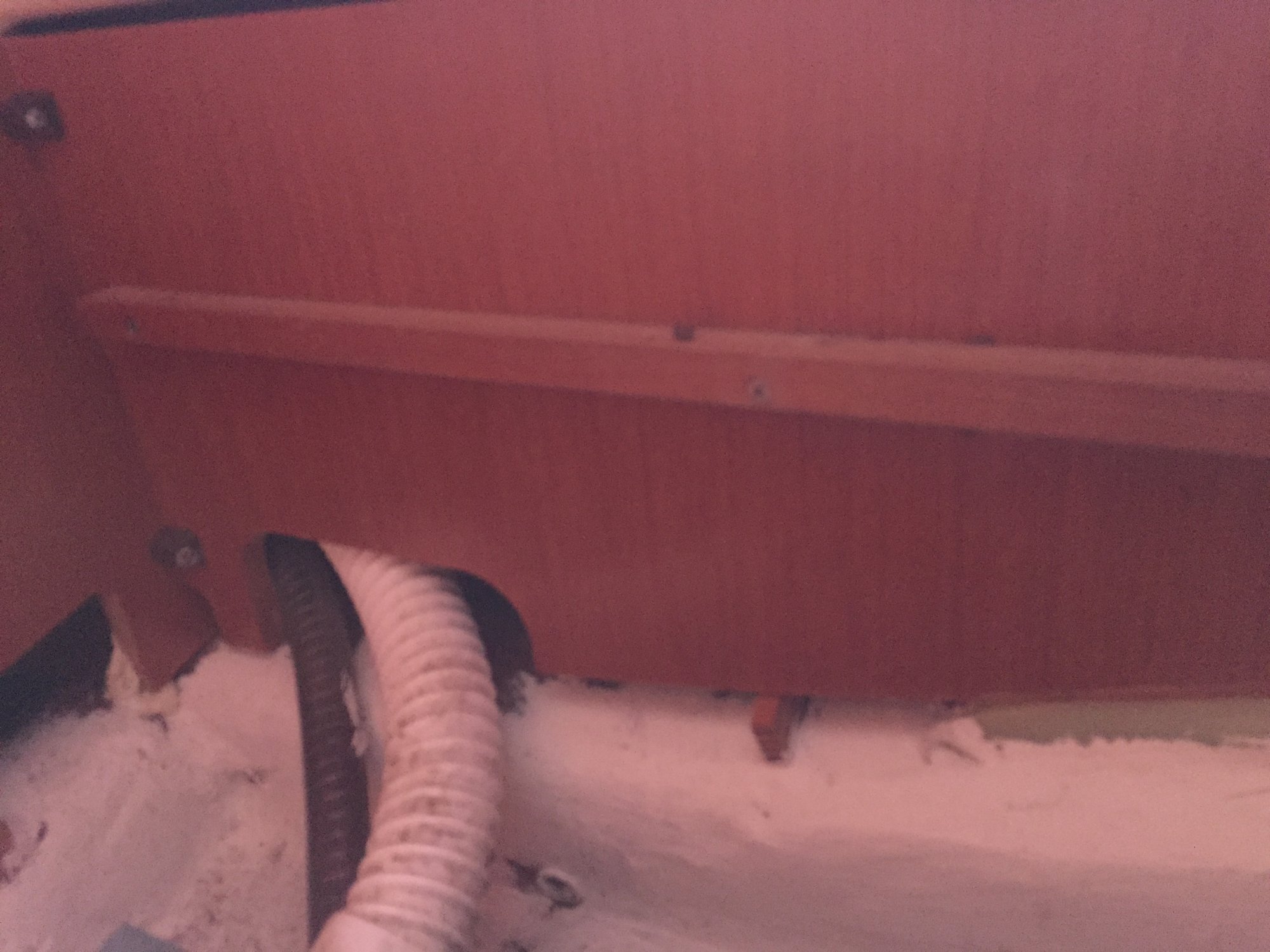

Your other photos;

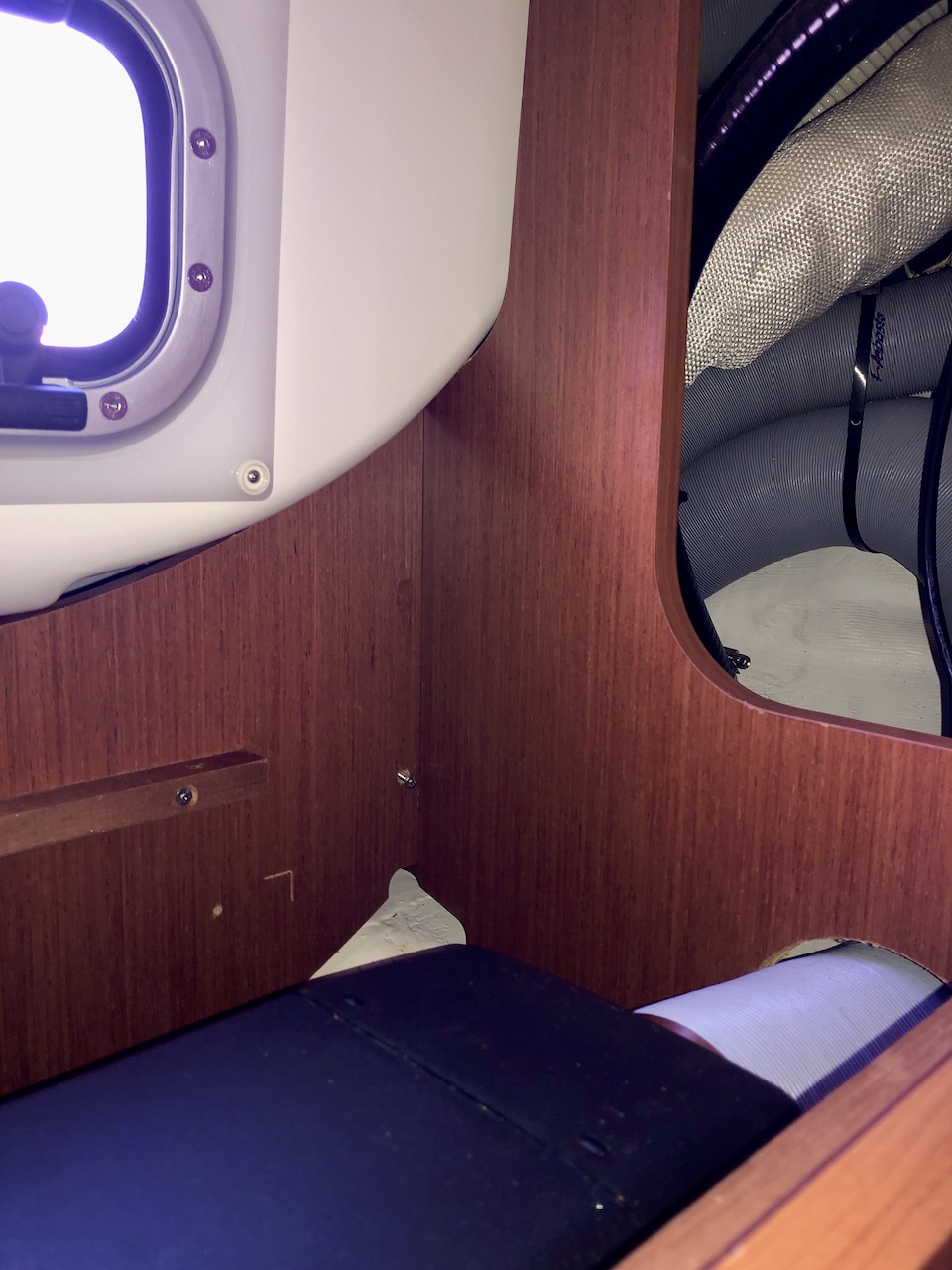

Nov 21, 2007
673
You can see one screw in this photo, but the two panels remain connected. There is a dark spot, a couple of inches above the obvious screw, I just have attacked it with anything to try to see if it's a cosmetic cover-up, yet. Also, the heat shield sleeve in the photo is from our Webasto heater, it's also attached back there somehow, but I think it's attached to the lower (left) panel and not the one that's open for access.

Even worse, there is a quick access panel inside the lazarette, which allows entry into the area beneath the swim step, but then they cut that space in two with a panel on the longitudinal axis... I guess plywood is still cheaper than additional layers of fiberglass to help keep the swim step from flexing...

If you don’t have the top screw & attachement, there might be a wood screw from behind the side-panel instead. You couldn’t see it; try taking a picture from behind the side-panel. If I remember well, the panel was lightly glued to the bottom also. Not an easy job.

@Caboteur , thank you! Now I know that they've either screwed from the side panel, or covered up a screw in the one where you have the two anchors. I only have the bottom one. It will probably be a while before I get to this again. I'll try to remember to post an update when I do. Thanks, again!
I need to post a correction. There is no plywood partition inside the transom, at least not when I look at it from the port side where this problem panel is located (I think I screwed up port and starboard early on in this post too...). What I see from the port side is a large structural fiberglass element located just behind the interior finish panel in the aft berth. It may be housing the rudder stock (tube, shaft?).
