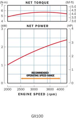

You have to click the specification tab for the generators and then go to the engines and the specification for the engine. Alernators have a speed limit above 10,000 rpm.
I disagree. IC engines have different HP for different RPMs.I think you have to check the rated HP for the generator it's self. Because it could very well be running at a different rpm than what the stand alone engine was rated at. Look at the power curve for this engine as a stand alone.

The coupling is direct drive. The engine is specified as GX100 for the EU2000. the system runs at a factory set governed speed to provide the power needed to maintain the rpm numbers needed to meet the power demand. It would be poor economics to install an oversize engine and the GX100 meets the KW needs for the EU2000 unit.
