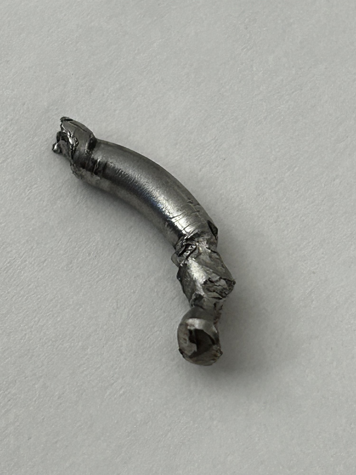

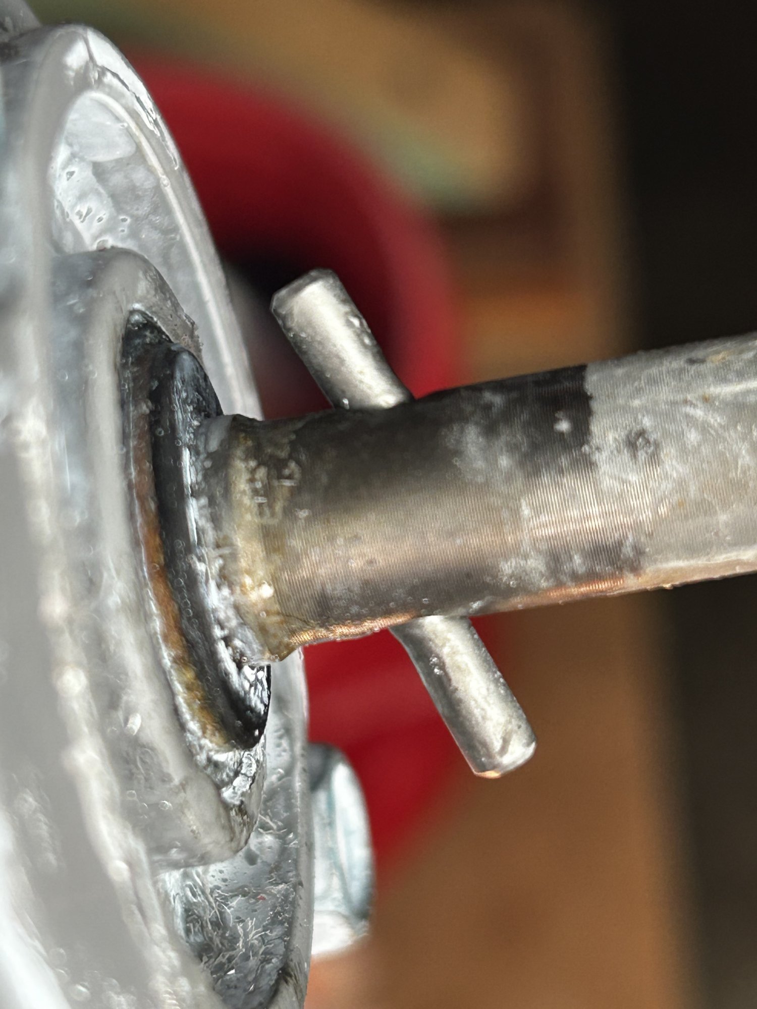

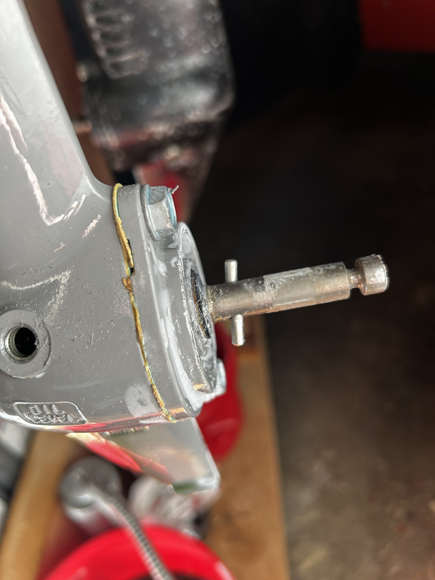

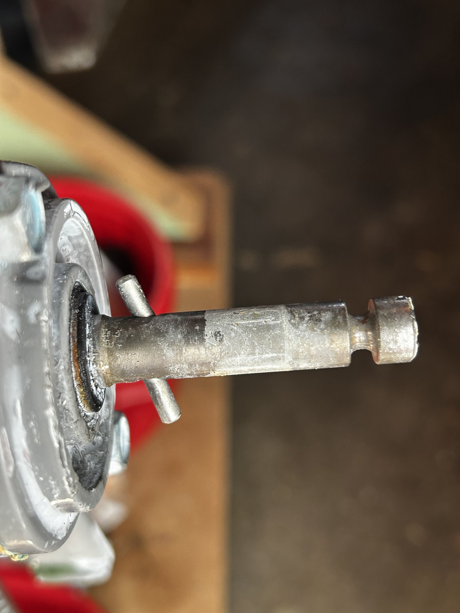

While changing the fluids I tried to get the prop off but it would not budge.
I ended up having to cut a notch in the propeller to get a puller in place.
Finally got it off but found that the shear pin was bent and jammed in the metal insert housing in the propeller.
I never had a shear pin so bend drastically and not break. I would have welcomed that. Not to mention I am having a heck of a time trying to get the shear pin out. It won’t snap with pliers or cutters. I’ll end up cutting that off as well.

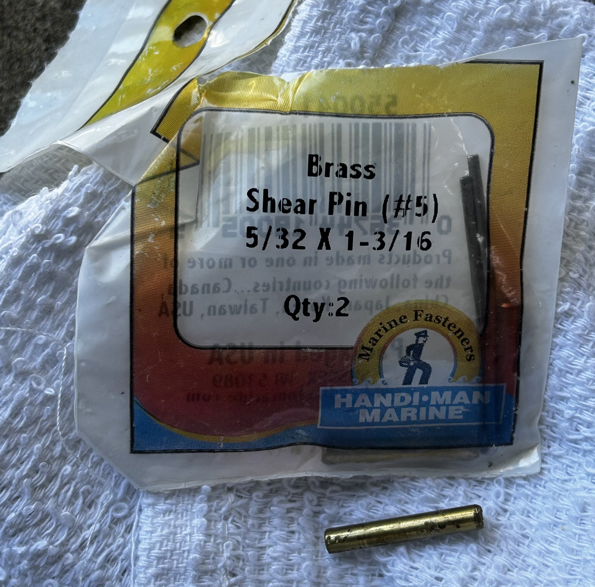

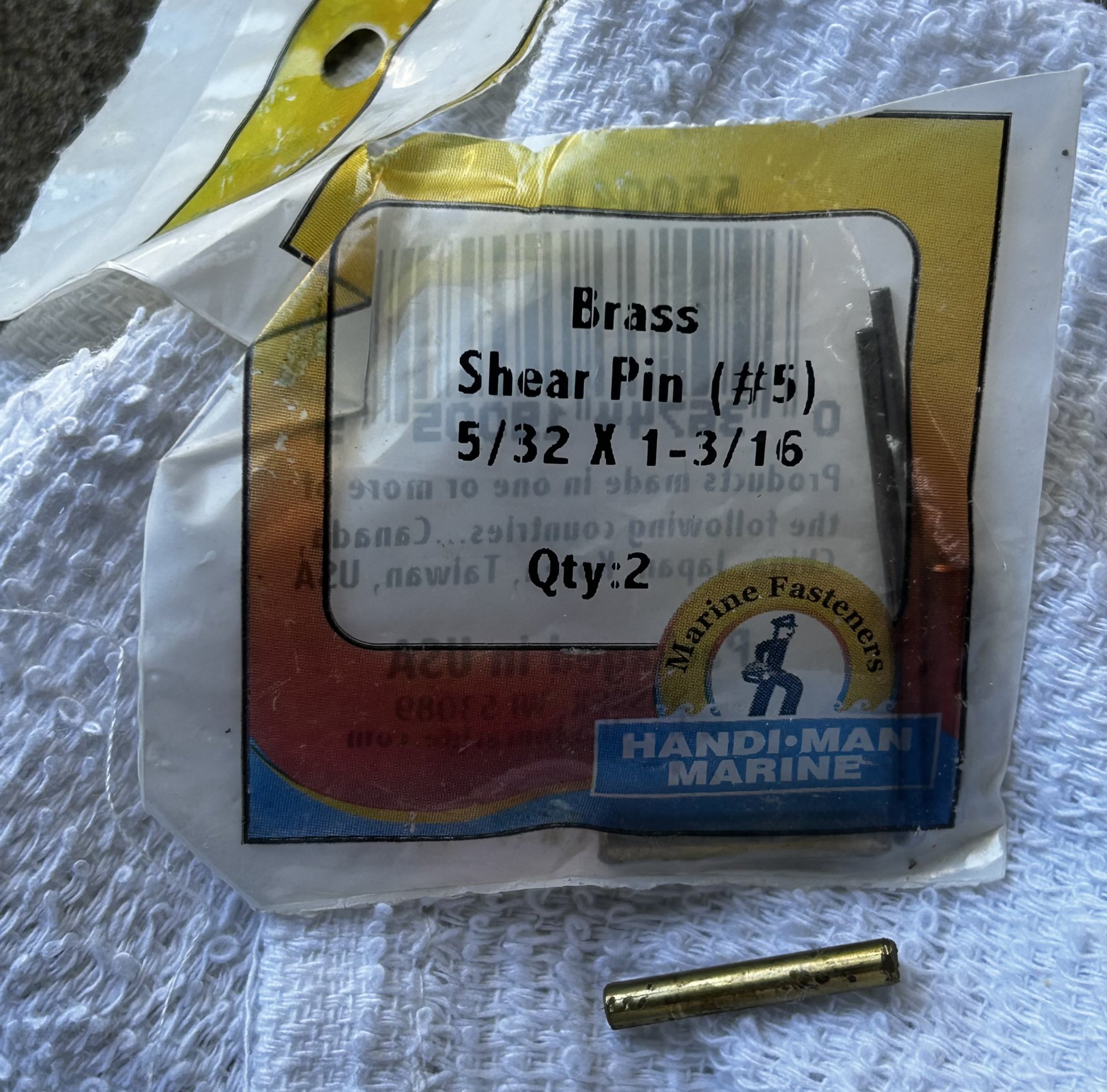

What kind of alien xenomorphic mutant metal did they find and from what planet did it come from! I have brass sheer pins for my Mercury 3.5 HP outboard. Now those work as they should.IMG_1974.jpeg And they’re from the planet Earth.

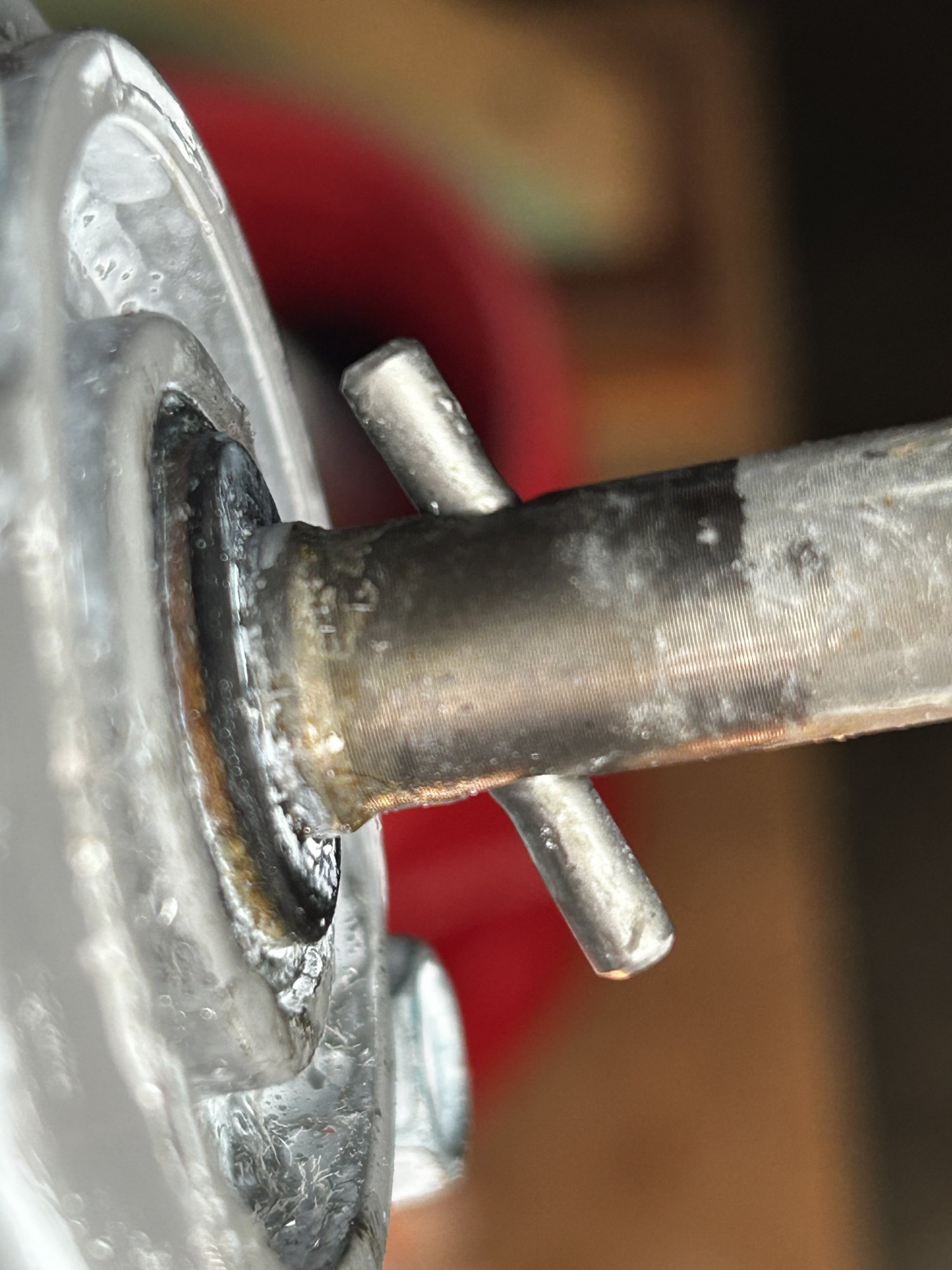

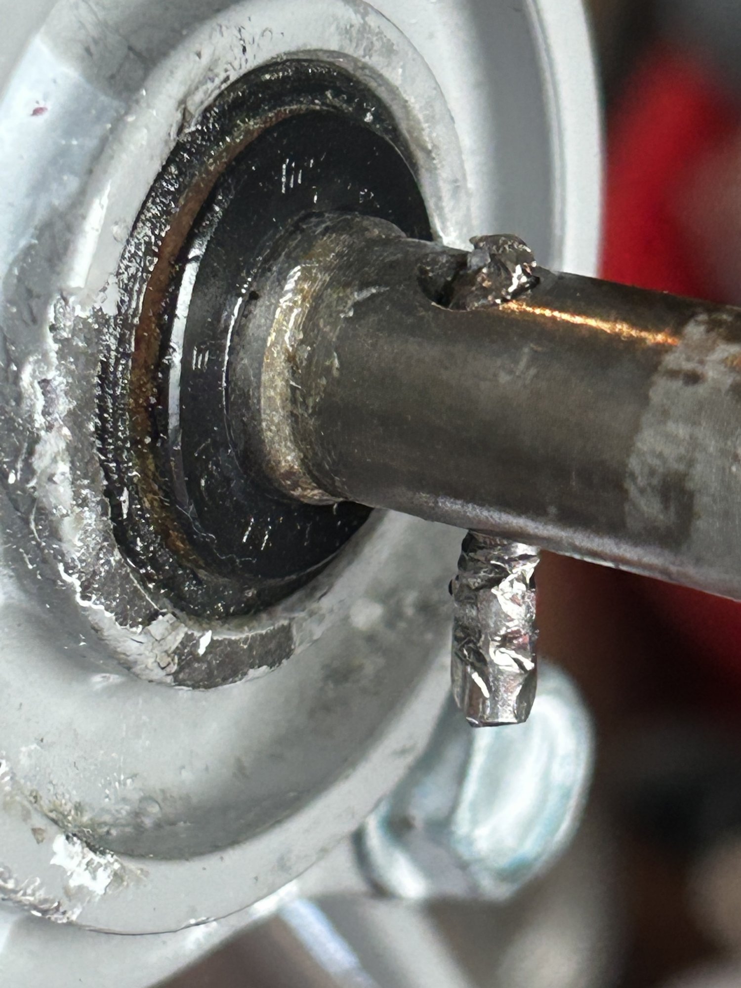

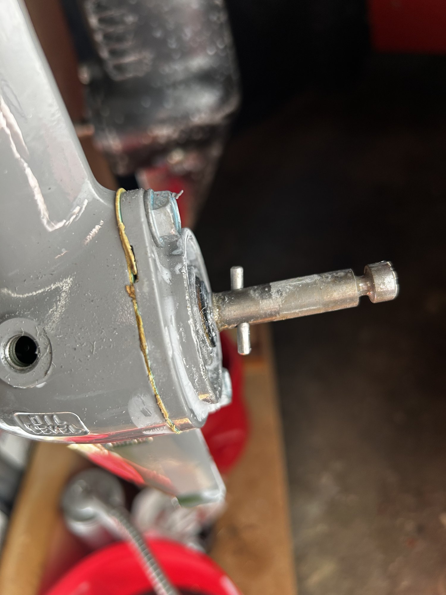

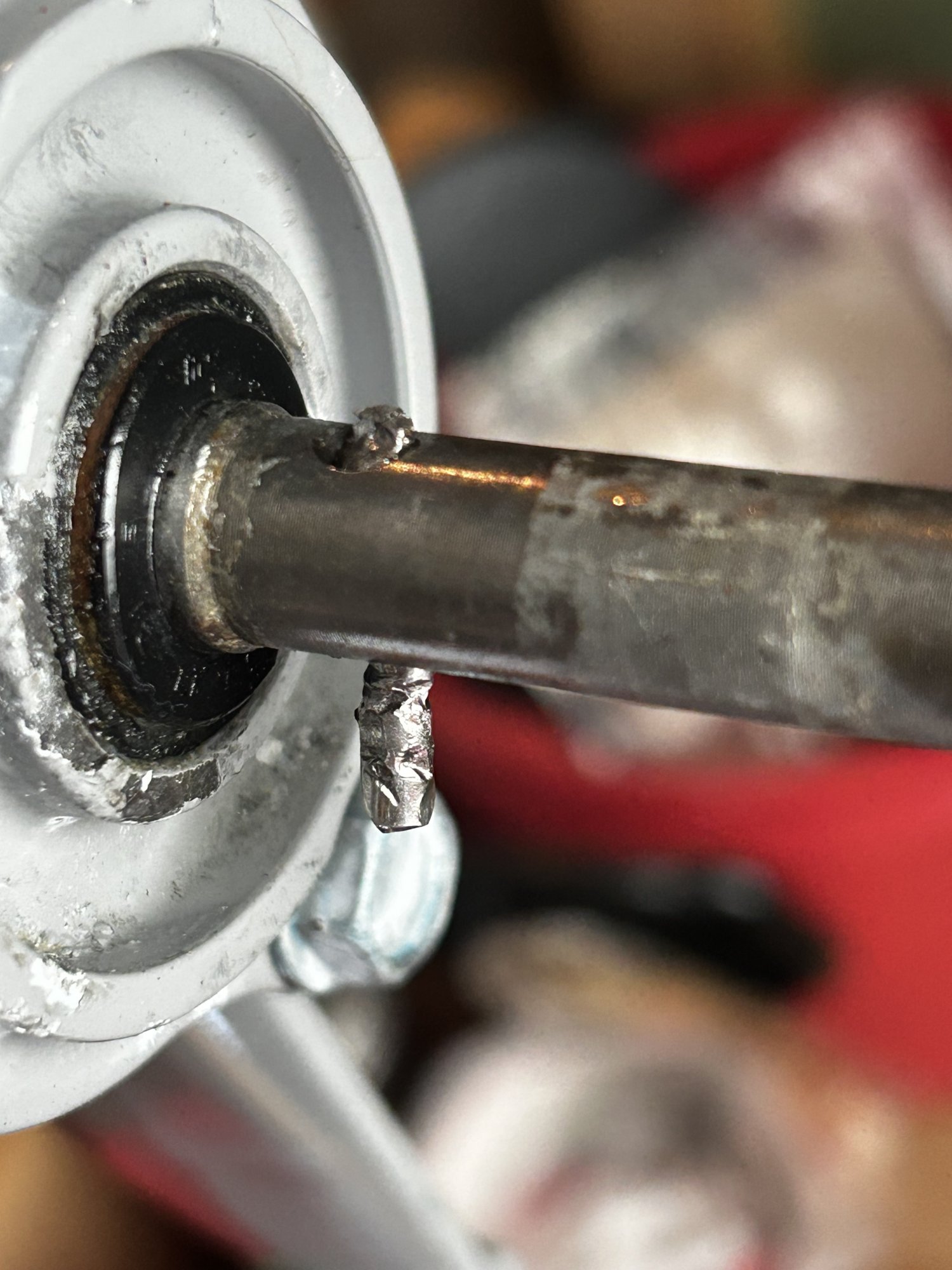

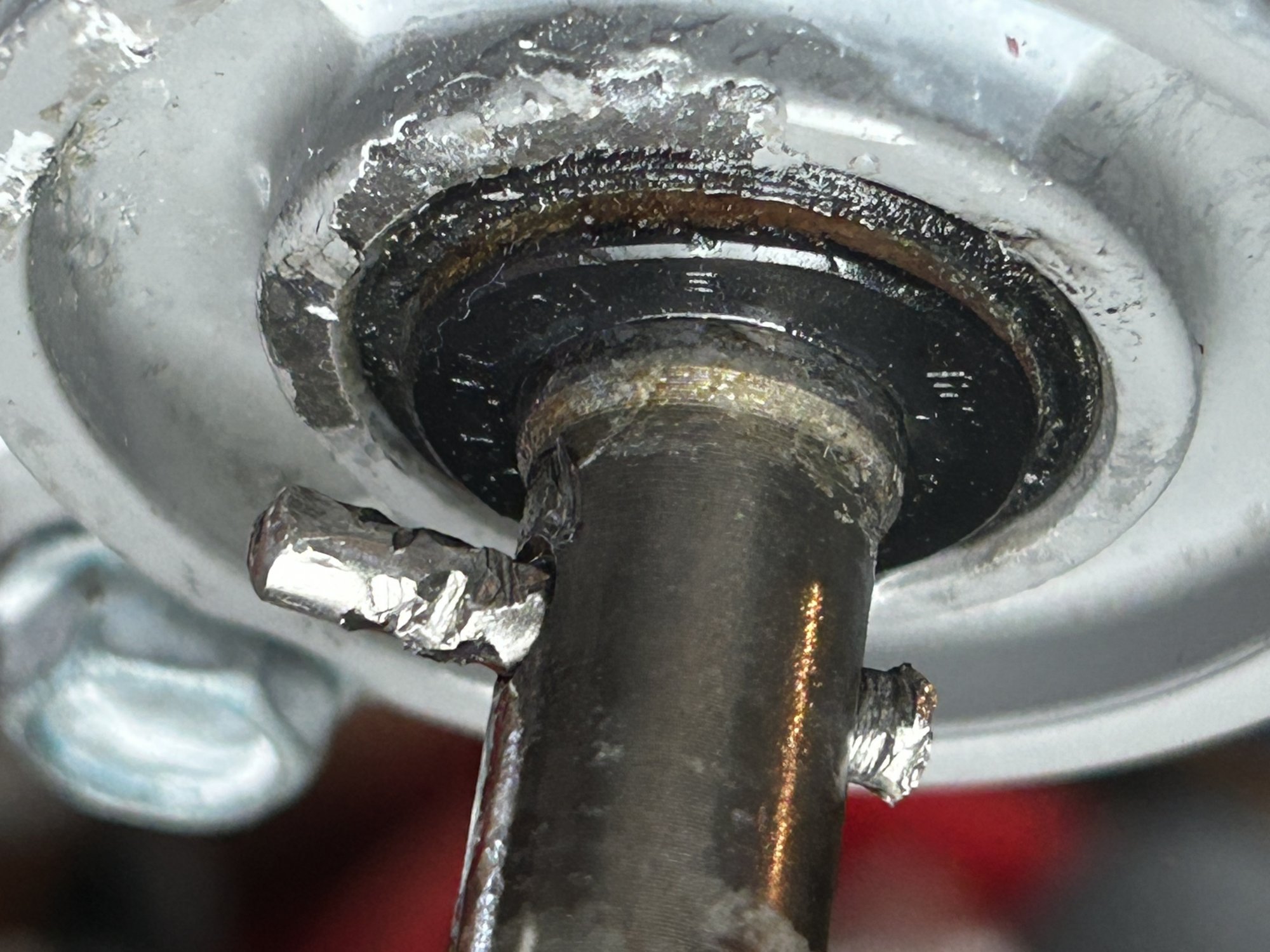

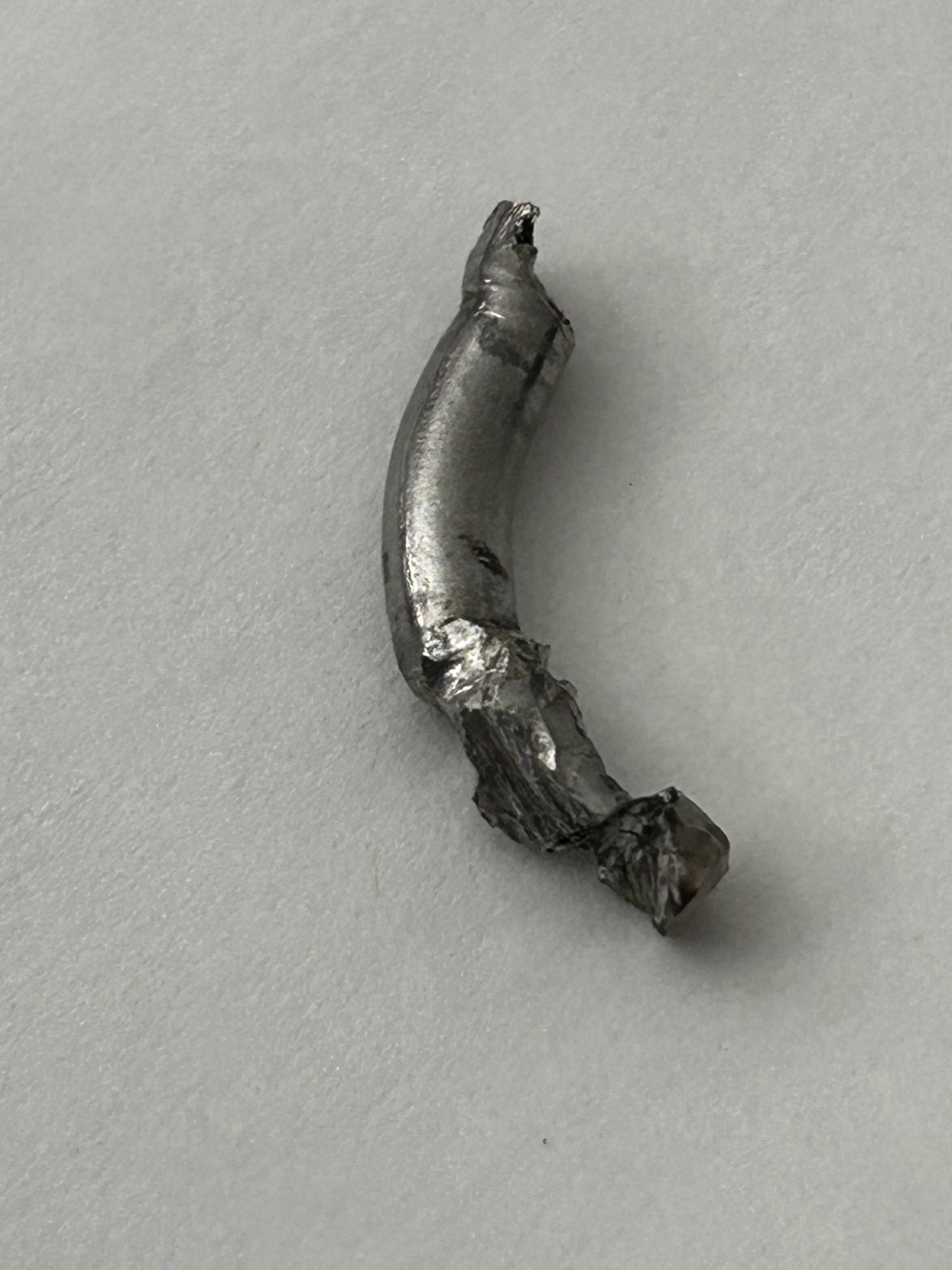

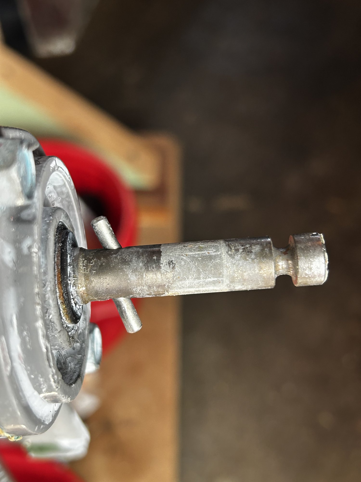

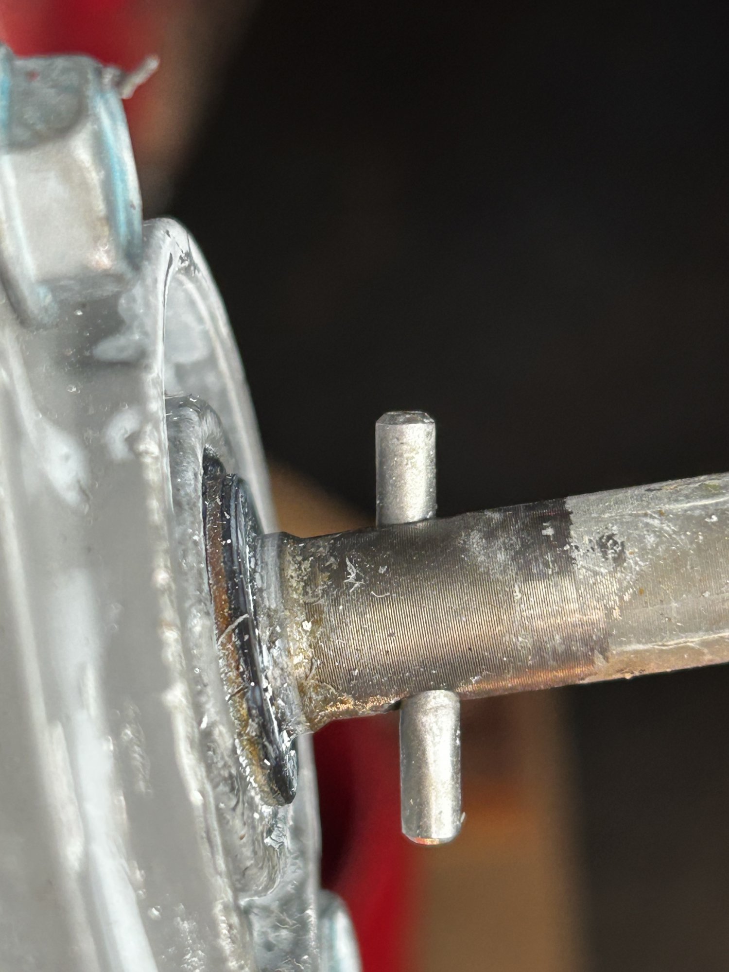

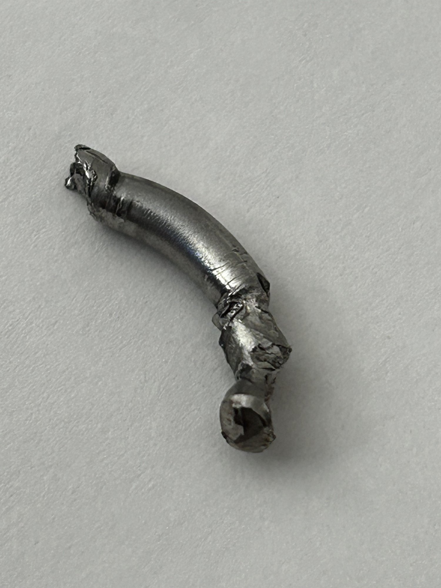

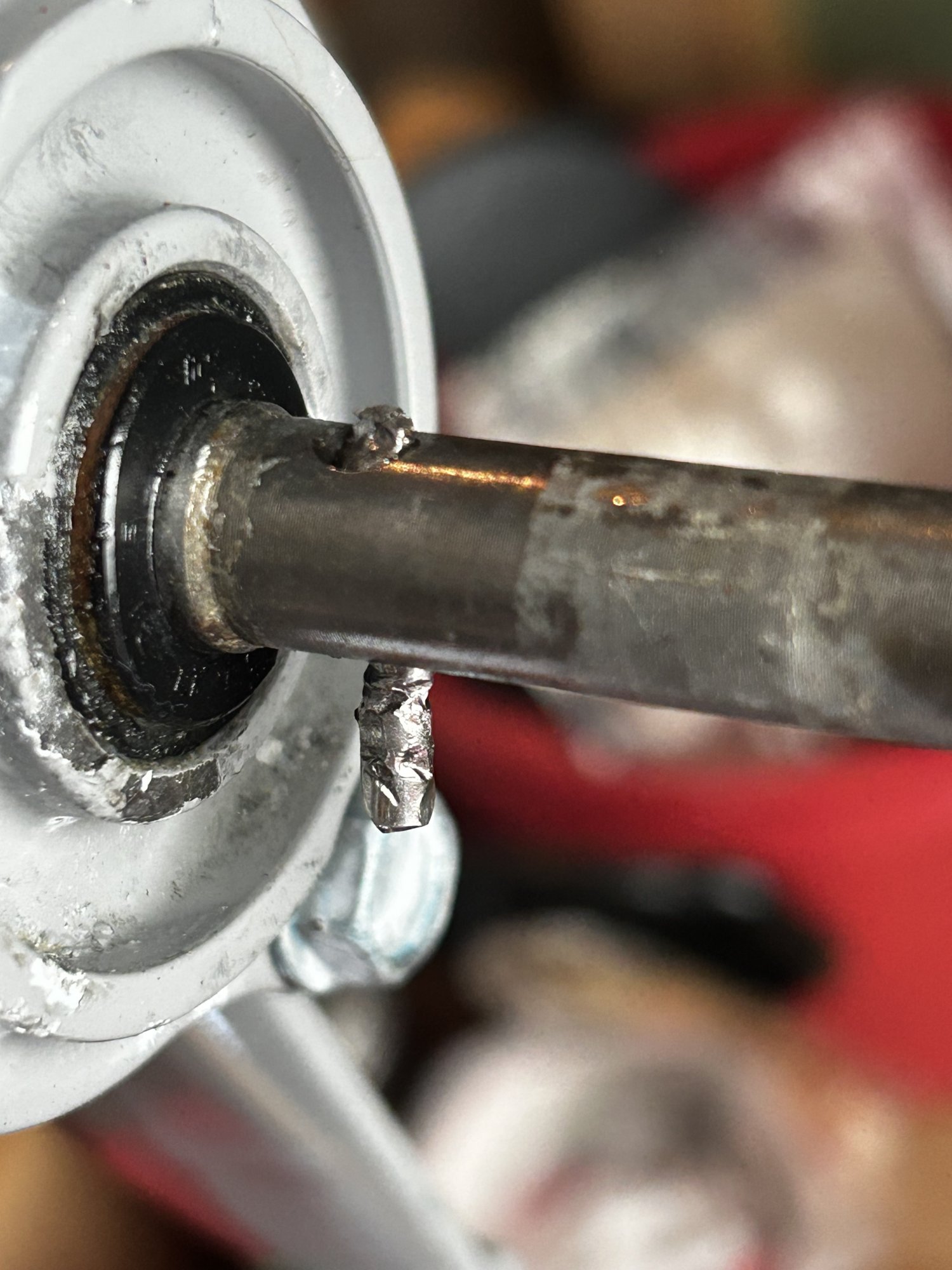

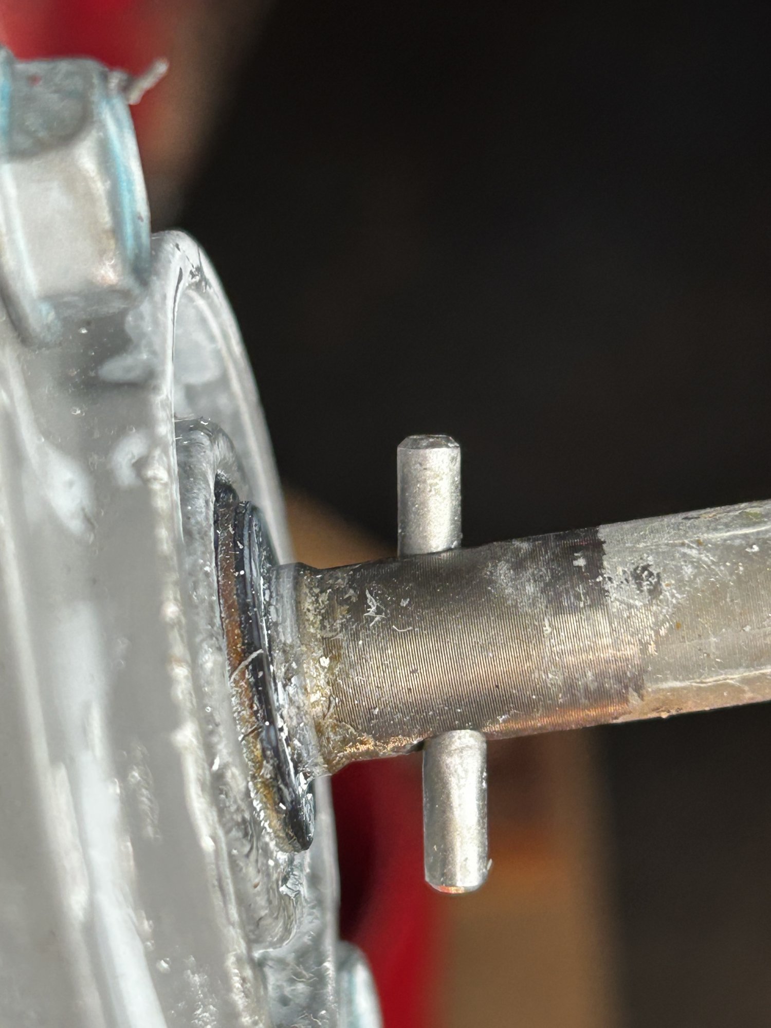

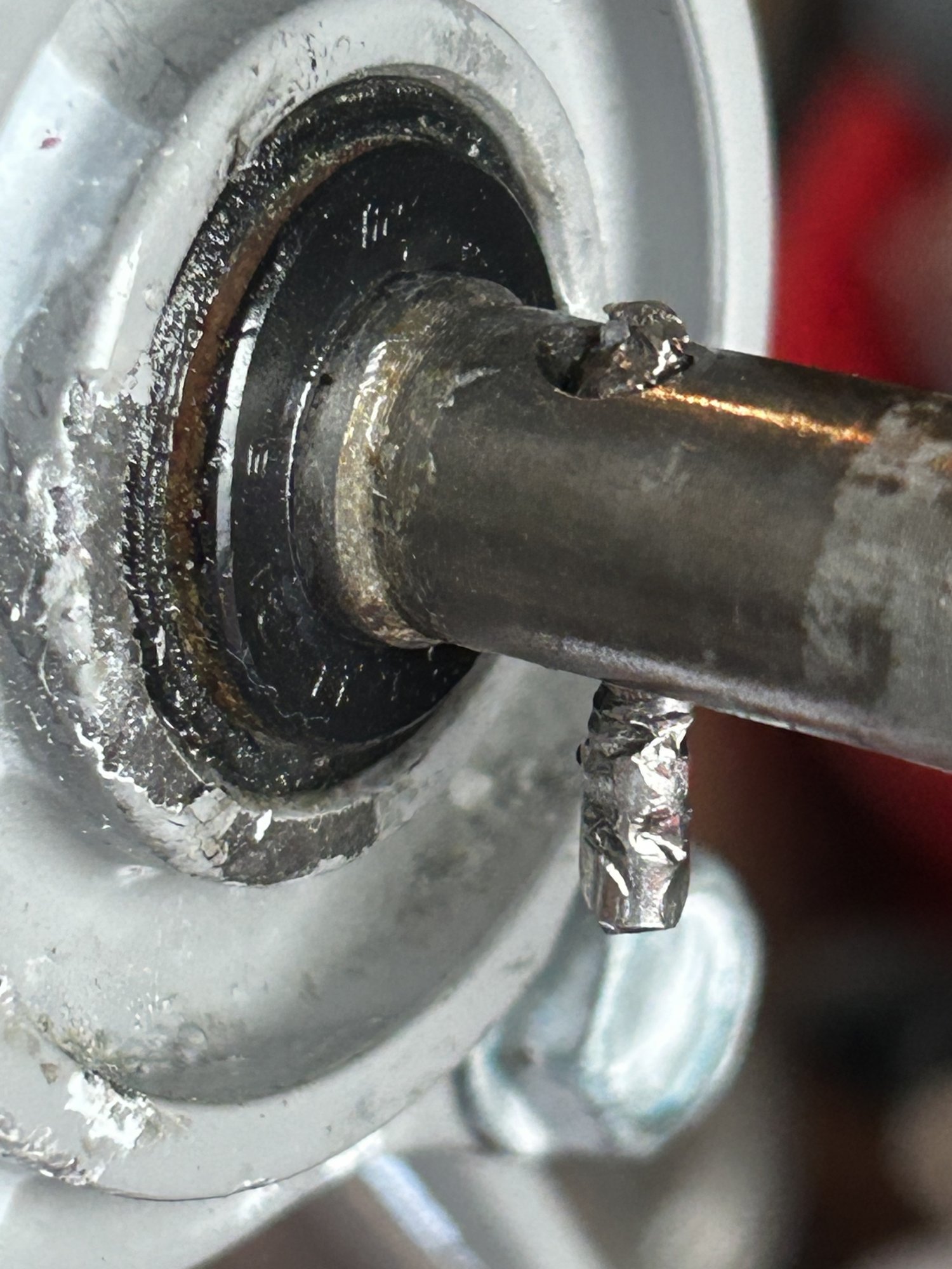

I finally got the pin out. It took over an hour +……. I had to drill into it and that broke bits, and it bent, it did not break.IMG_1964.jpeg IMG_1967.jpeg IMG_1971.jpeg
I have never encountered a sheer pin like this and hope I never do again.

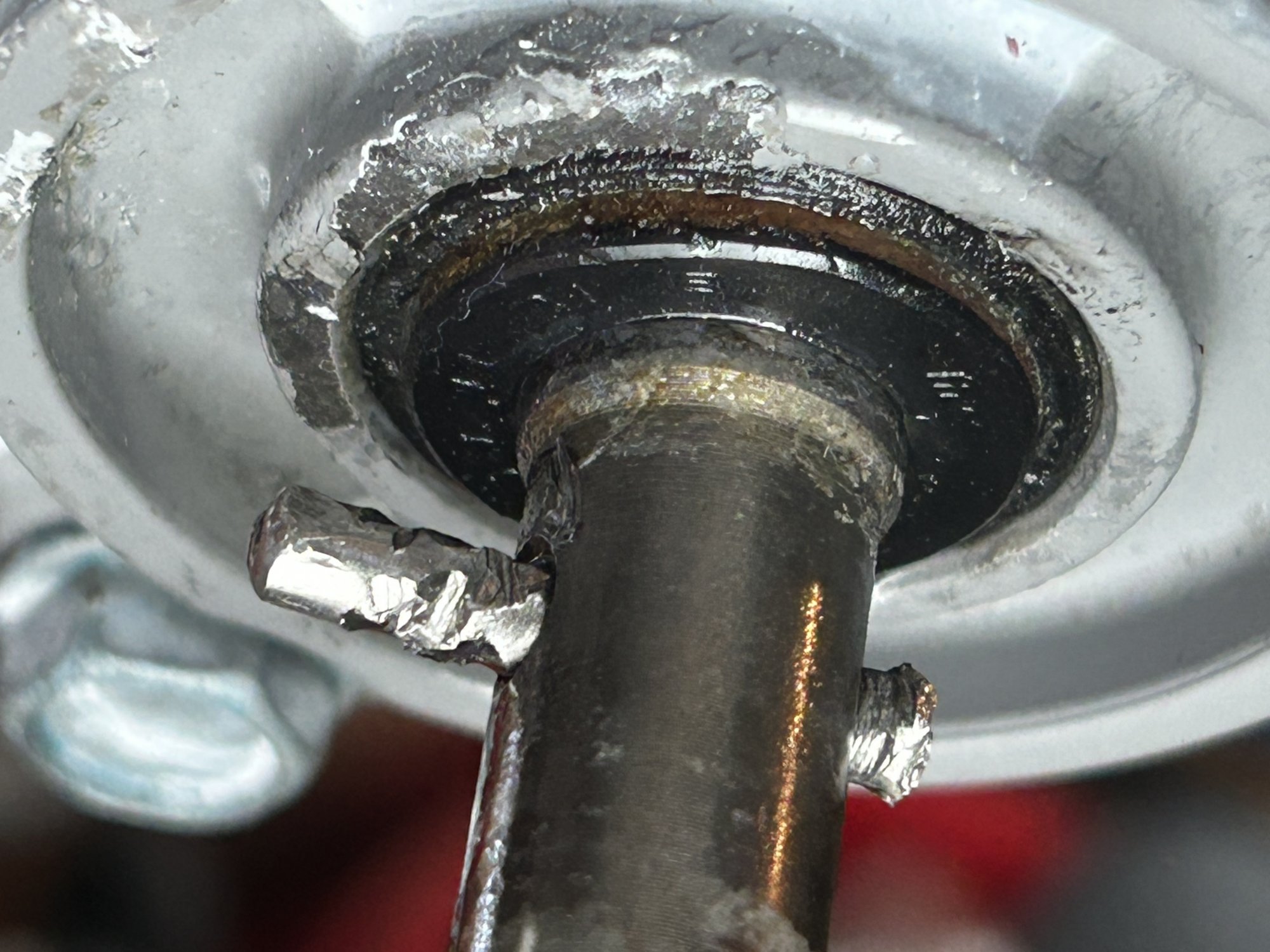

Now on to a new propeller. DJ, you’re right, even after hitting the mud the blades were only scratched not really nicked. So it holds up.

I wouldn't want a brass shear pin at that location. I'd stick with the OEM shear pin. Now if that shear pin doesn't have shear lines, you could machine two of them in. But the current setup sure seemed to work well..might have been hard to get apart but that can happen no matter...

Same here, these items were always carried as spares. Even for the snow blowers. That’s why I still have 2 brass pins for my Mercury 3.5HP.

I have a Honda 2.3 - I snapped the shear pin cleanly when I hit some rocks so they do work correctly sometimes. If you haven't noticed, Honda put a spare shear pin and cotter pins under the front of the engine in a little rubber holder.

Well, I heard back - enclosing the email for you to read as well.
It looks like my Honda performed as it was intended to do. Bend and not break. And they say that protects the propeller shaft and internal gears.
So how I left it is:
Sent photos of my propeller they wanted to see.
I asked for guidance as to how Honda removes a bent stainless steel sheer pin from a shaft.
What tool does Honda use to remove bent stainless steel sheer pins from shafts.
I’d be more than happy to purchase the tool and avoid the hammering that was needed. I’ll let you all know what I hear back.
Good Morning,
After reviewing with our model specialist, they confirmed that the sheer pin is designed to bend when the propeller encounters an impact.
It doesn’t bend on its own; rather, it responds to external force, such as striking an underwater object or obstruction.
This bending is intentional and helps protect more critical components like the propeller shaft and gears.
If the sheer pin is bent, it typically indicates that the propeller made contact with something during operation.
To better understand what may have occurred, we’d appreciate seeing the condition of the propeller itself.
That will help us assess whether the pin performed as intended.
Honda has 1 type of sheer pin for your model and recommends using the Honda Sheer Pin, part number 58131-ZV0-000.

Regarding removal of a bent shear pin, there’s no easy or universal method.
In some cases, service dealers had to carefully cut one end of the pin flush with the propeller shaft, then use a punch tool to drive it out.
The most important thing is to support the propeller shaft during removal to avoid bending or damaging it while applying force.
