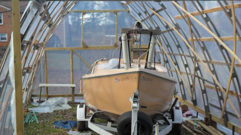

Its a sickness.... I built this two winters back with the intention of building a 29' sharpie. But work and life got in the way... but I still have plans....
I've since sold the boat seen in that shed and now have a Balboa 26'. It is trailerable but raising the mast is a chore. So that is what got me thinking about a lighter mast.
