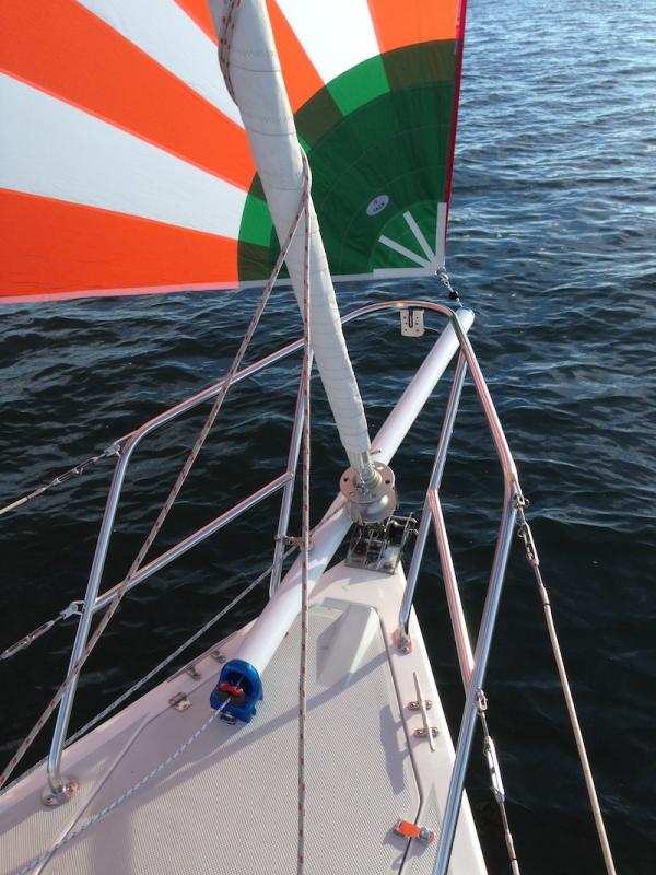

I am in the process of making a top-down furler from the smallest Ronstan "regular" furler for the kite. The furler is a continuous line unit, quite small, and will extend from the sprit that was installed earlier this year. The reason for constructing the top-down tack swivel is that a package of Harken Torlon bearings is about $10, the furler was about $400, and the cheapest full blown top-down units start at about $1200.
Oh, and the lathe paid for itself many years ago.
