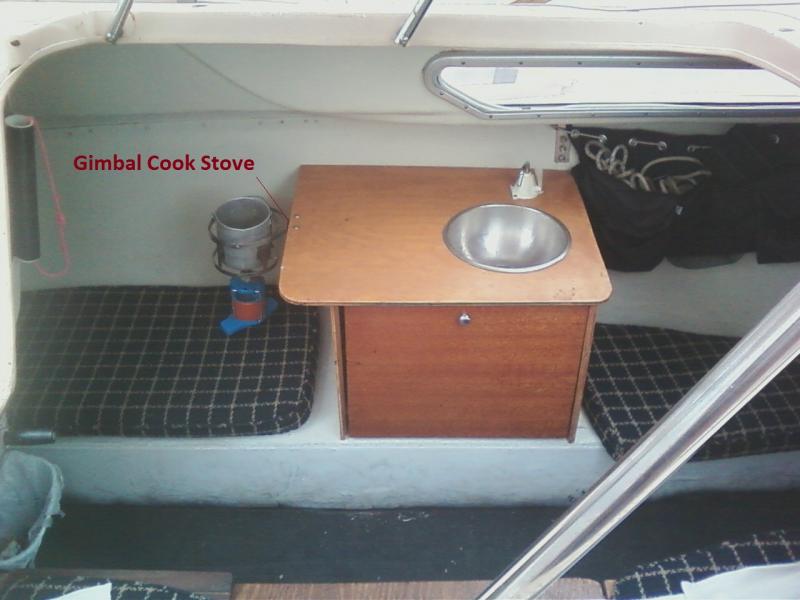

My last boat (Mac V22) had something like this in it. I don't know who manufactures it but it is the same design. You can just make it out in this pic.

Looks like maybe the ForeSpar Mini Galley. Pot size is rather limited, where on the one Lezlie built, there is no practical limit. BUT there's also no real pot holder other than the upper frame.
Yep
I think you are correct. I did an image search for the ForeSpar and found this
It looks a lot like the one I had.
