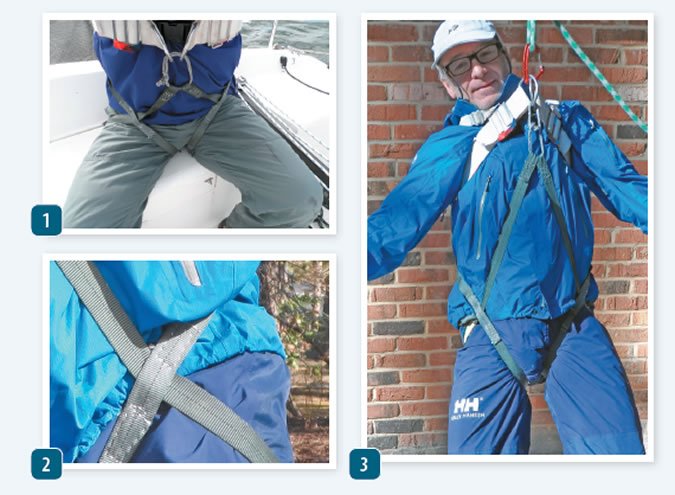

Yep, nice kit. Good idea to put crotch straps on your inflatable PFD too, keep the harness from riding up even when the vest is not inflated.
13,006
In the December issue of PS, there was an article about leg straps and with a design that was both safer and more comfortable.
