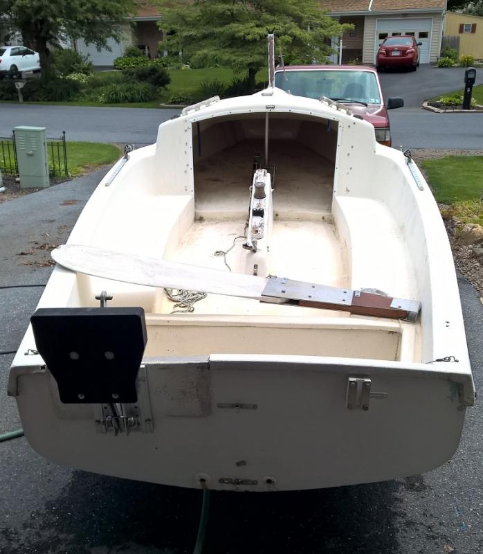

You didn't want to see it when it was dirty. Pix(Hope they attach) are post-power wash.
Brought it home from a friends house(Moving to where he could not take it.). I hated to just leave it there to be trashed. My neighbors are not loving me with two old boats and an old pop-up camper on my small, neighborhood, lot - yeek! Can't say I blame them.
The last "free" boat I got(Luger Leeward 16)... is sitting beside my garage - waiting(Covered, good shape, hull/fittings/rigging/sails, but waiting for new foam floatation and "mod's" to make it into a teeny-tiny cruiser.). Already have about $1,500 in it(New Dwyer Mast + fittings, etc...). Like to get it's sails to Sail Care for evaluation/repair. So I got that to do, already... But, when done, I'll still have a 16 footer.....? However, I have this 20 - or do I?
Question: Try to save the Holiday 20, or take it to the dump, now?
Been sitting outside for some years(?) - uncovered.
Seems a very light-weight boat - very light. IOW: How likely is it that the fiberglass is still in good shape? I can see "dents" where parts of it sit on the trailer rollers. Cleaned-up nice. Decent sleep space for 2 "rugged campers", under the cuddy. Only the one drawing(On the web) to guide me with rigging(Really like to eliminate the traveler?). Will get the sails out of their plastic tub, today - cross my fingers.). Trailer seems "OK"(Proper trailer? From Texas? Boat from Virginia.).
On the H20 - Rigging, fittings and lines(Need replaced) seem very light, as well? The cleaner it gets, the more I worry. If a bit of glass repair and some new ropes would do it, I'm good - but? Rudder is "all there", looks OK, but - it's old, contoured, thin - wood. CB appears to be some sort of metal? Winch for same - I don't know? Don't really like the looks of it - would rather do "something else" with that, I think..?
FWIW: I believe I could just pull it off the trailer, myself and turn the thing over in the yard to fool with the bottom?(Or to watch it compost itself into the lawn?). Just feeling I could do so, fairly easily, worries me. Light is good, but, light, ancient "Sun-Struck" fiberglass, maybe not so much..?
Can have less than a foot of draft(Board-up), so, great for doing the tributaries of the Chesapeake --- though I'd wonder about the bay, itself - so darned light.). Newest, best thing about it is the motor mount - sigh... My British Seagull(1972? Starts first pull! Incredible.) would look dangerously "vintage", hanging on it!
Have cell phone, can do more photos...
What do you think?
Thankx for all comments!

This new boat of yours sure looks like a Rhodes 19 or one of the early Oday Mariners. Not sure of the quality of the fiberglass, but my Mariner was very thin, and even though it was a 1973, it's held up very well during swift sailing. My current nut shell (had to down size), is a Newport 16, and it too,had the trailer induced warps of the fiberglass hull. Once I put her in the water, fixed the trailer bunks, it straighten out almost within a few weeks. This spring I uncovered the boat after sitting on the trailer all winter, and it was perfectly fine.
Do yourself a favor and plan on new stays for the mast, I had the rear stay (thankfully) go under sail, but it still scared me $&/less! Also check the keel bolt is solid, I took mine out with the boat on trailer while I jacked up the keel with a hydraulic jack just to get the tension out from the bolt.
Trailer looks good, bearings and bunks are the main thing.
If you sail by yourself sail the 16 footer, if you have help raising the mast, go for the Holiday!

If the important pieces... rudder, mast, centerboard and hull are good , I think you have a sporty day sailor... I'd get a tiller extension and rig some hiking straps so I could sit on the coaming and steer. I'd love to have a boat like that for bay and lake sailing with one or two crew and a little spinnaker.
BTW the motor mount looks fairly new.. what happened to the O.B?

Yeah...... The pretty little tiller was, unfortunately, left with it's end in a wet area(Rotted-out). It will need to be replaced - or maybe just the bad(Rudder) end cut-off? Always nice to have a tiller extension - though I am rarely a "hiking out" sailor - more of a "falling in" sailor...
The motor(s) were, both, "blown", I believe..? One left un-rinsed after salt water use(Someone other than the owner using it at the time.)... The other was one of the Briggs & Stratton "lawnmower outboards", which could have been cool..? I think it got "hot & boomed" though, from a lack of oil..?(As I recall, the owner owned-up to this tragedy.) These things happen --- sigh... Will try to pick up an old OB at an auction as I can... My British Seagull is cool like crazy, but, with no reverse and the "open", rope-pulled "widget" spinning madly on top, it is pretty darned dangerous. No reverse, either - ha! Some BS's one could "turn around" in their mount, I think(?), but, not this one.
Rudder looks OK. However, as I was, just this morning, trying to repair an old outdoor rocking chair rocker, and found the wood had "dry-rotted" under what was left of the paint - "snap", I am hoping the same is NOT true of the rudder. If the CB is all metal(Can't pull it out to look at it, at this time.), should be "fine", but, if not..? Who knows? Sooner or later, we'll see...... BTW: I believe I may have replaced the BIG CB bolt, on the 16..? I seem to remember some wear..? I did do some new, heavier reinforcement on the 16's CB trunk(Lots of stress over the years), as it also handles the main sheet blocks, straight down from the boom(No traveler). Like to do the same with the 20(?).
ALL will be carefully examined before anything other than cleaning is done.

When we got our 20 first thing we did was take motor and mounts off. This boat was not built for holding a motor. The mast is held above the trailer with a mount that slips in your gungeon and fork up on your trailer. I will take picks of mine and post so you can see. It's just piece 1" square tubing with y shape at the top. It has two bolts welded to it that slides right I. Gungeon

Yes, I ripped that motor mount off, too. Hard to see in the transom pic, but, someone had cut down the transom a bit, on the left side(Looking at rear of boat) and bent a big piece of metal(Aluminum?) and put down over the transom to hold a motor. Looks horrible, though plenty enough for a light-weight motor like the Seagull, an old 2 cycle, or an electric. Also de-installed the fancy ladder mount(I have the great big ladder, too.). Will try to sell both.

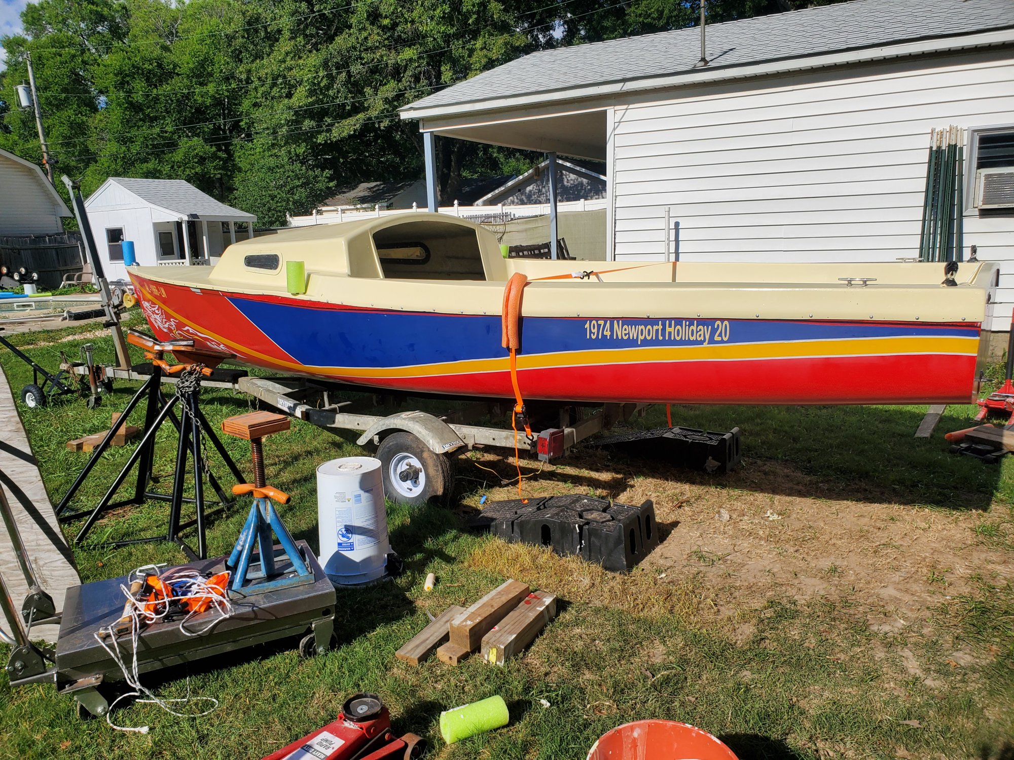

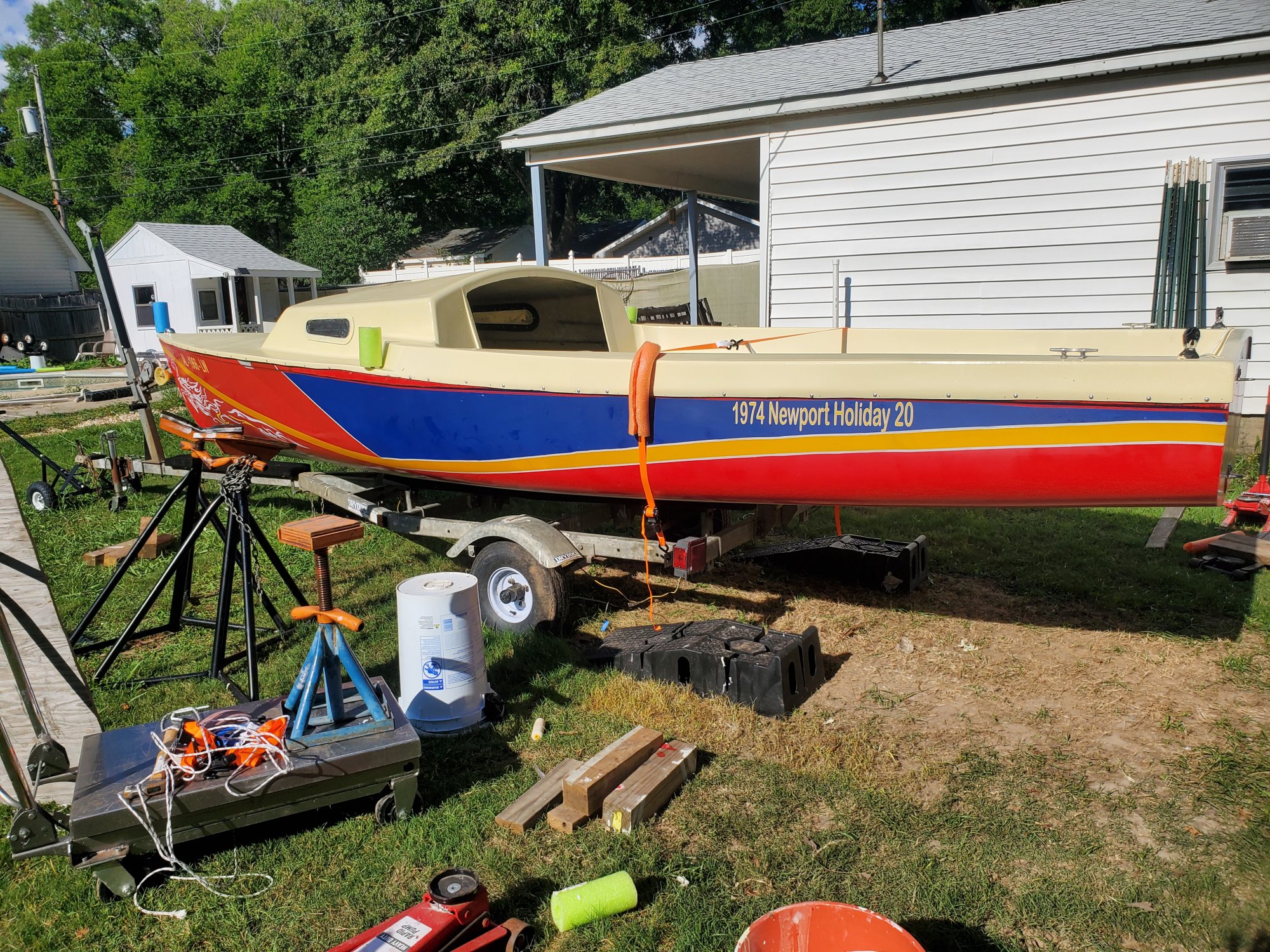

The 20 on the site owner is me..lol sounds like you would enjoy a motor sailor boat instead of a regular sailboat. Some of those are made where you can beach them and you can sleep below.Macgregor makes a nice motor sailor. You mentioned not being a racer so that one you can take three others for the weekend and be comfortable.
