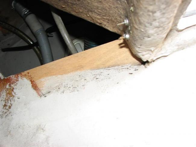

Copy of letter sent to Beneteau, they did not offer any help with this problem. All 390 owners need to check their boats, especially those built in France. Let me know what you find. Beneteau says that the boat was modified ( holes in transom ??? ). You must put your head in the locker and look towards the hull and up. Check enclosed picture.Midnight Sun, a Beneteau 390 built 1987 in France. Serial Number OCE 390 N 0080 While sailing in the Bahamas, in 20 knots of wind, on a broad reach, and 15 degrees of heel, I went below and found six inches of water over the salon sole. After pumping water overboard, I could not find the source of the water and returned to Florida. After a lengthy search, I found that there were openings in the transom on both port and starboard sides, between the lockers on the swim platform and the engine/ fuel tank compartment. These openings are triangular in shape and about eight inches on a side. The transom/bulkhead was never completed during original construction of the boat.
