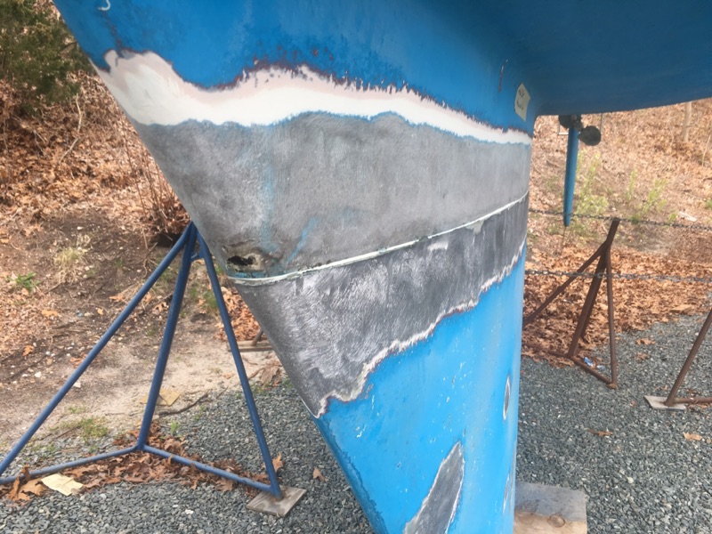

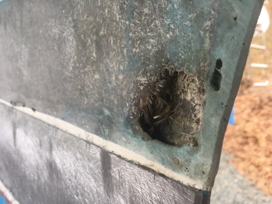

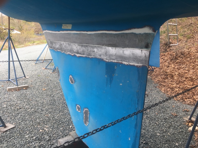

I have these troubling holes in my keel, discovered after sanding out a crack along the base. Marina is tightening bolts and filling these holes. How much will this affect the boats speed? What should be the next thing to look for? Any suggestions? Advice, thank you.

That probably happened during layup of the fiberglass. So you have been living with that defect since the boat was new. Once filled, it will be better than new.....

Thanks, that layup was 30 years ago...better than new sounds great. I will continue to treat her like a lady and hopefully she will continue to bring me home safe.
