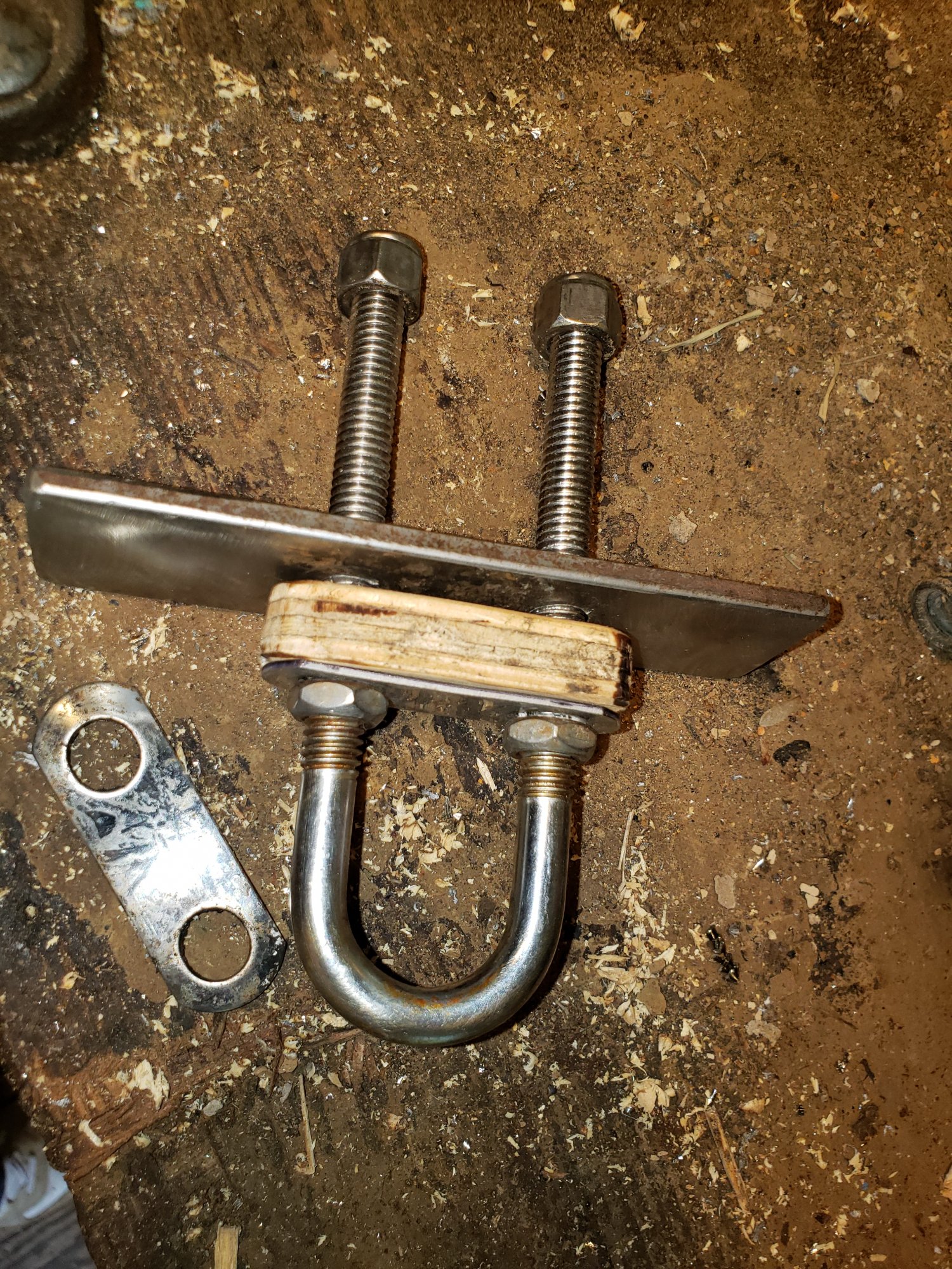

I have a 19' trailer sailor. I did something stupid. I thought I would snug the boat up to the trailer with the winch, but forgot it was strapped down in the back. The result was that the bow hook-eye ripped right out, and now there is a hole. I bought a fiberglass repair kit but I have never done fiberglass work before and am a little intimidated. I was about to begin when a friend of mine told me of a different way to approach it. He said just use a bigger backing plate and make a stainless steel front plate that has two bends and covers the hole and damage. Then use marine caulk and be done with it.
The above pic shows the extent of the damage.
The pic above shows the old backing plate (to the left). It was so tiny. You can see where I made a 5 inch backing plate. It is on the u-bolt. The plywood is just a filler piece I cut to plug the hole (it's probably too thick still). There is no pic of the front plate, as I haven't made one yet.
Should I attempt the fiberglass repair, and if so, would someone give me an idea of the steps and procedure?
Should I make the front plate and do it the easy way, and if so, any suggestions?
I plan to sail this thing for a few years and sell it, so I definitely will make the thing safe and water-proof.
Thanks for reading!

I have seen some youtube videos and the problem is that it is either some yahoo doing some cosmetic repair or if it is a hole in the hull, it is not in a location such as this. I am under the impression that you must cut out a hole (completely through the core and all) and then lay in circles of glass in ever decreasing sizes until you have completely filled out the patch. Considering this is my first attempt and it is in the bow, this seems like one hell of a job. Correct me if I am wrong about the procedure.

Another thing is that I am in Louisiana and it is 95 degrees outside and the humidity is always high. I might need some of the 209 hardener, if I want to take my time. Really though this is a $3600 boat I bought off of craigslist and I am not building a clock :)
I'm thinking I will make use of the west systems kit that I already have, as basic as it is, and buy more stuff when/if i need it.

This is a reasonably serious repair. To respond to a couple of comments.
The boat was laid up using either polyester or vinyl ester resin. Hunter would not have spent the money in materials and labor to build this boat with epoxy.
The idea of just putiting a SS plate on the hole is not a good one. The stress on the bow either needs too be distributed into the hull. The plate won't do that.
Andy on Boatworks Today, just released a video about patching a hole in a hull. This is the method you want to use. Basically, grid back the hole to get a 12:1 bevel on both sides of the hole and then lay up glass on both sides of the hull and rebuild the hull. When it is done you will have to put paint or gelcoat on the repair to protect from UV, especially if you use epoxy,
I would use epoxy because it has better secondary bonding properties than polyester resins.
