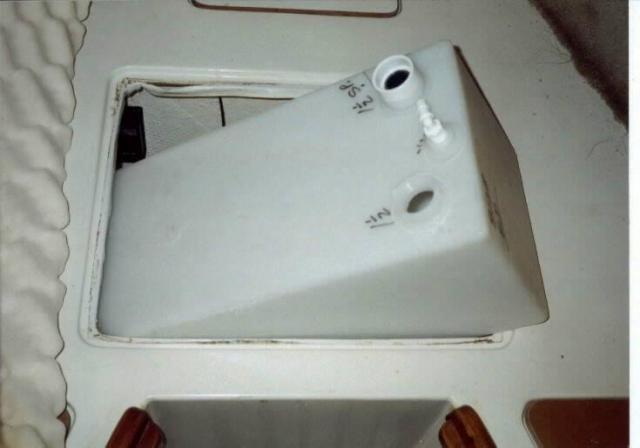

Here's my Ronco 22 gal. tank going into the v-berth, in 2000 I think. Like Peggy says, solid and the hose connections are right where I asked Ronco to put them.
