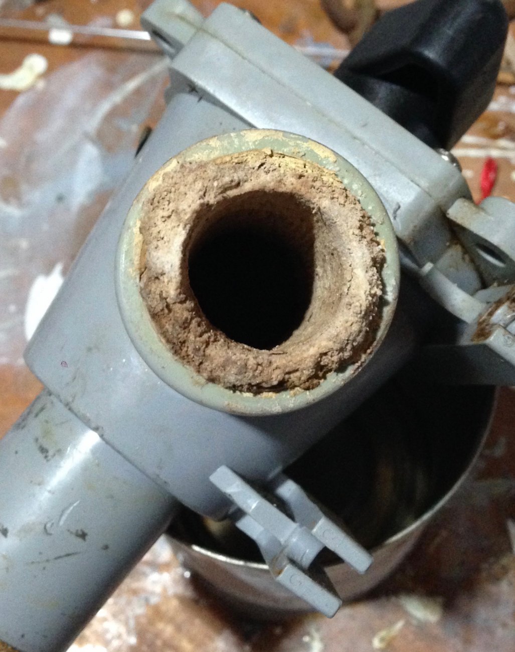

Use about a 15% solution of muriatic (available from any hardware store) to dissolve any buildup in the toilet discharge hose. Pour it down the toilet and be sure to CAREFULLY followALL directions for handling and using muriatic acid. 3. Lube the toilet.
What effect if any does this have on a joker valve or wye valve?
5,764
It should have no negative effect on the Y-valve and probably not the joker valve. Since a joker valve should be replaced every year, running the acid through the system prior to replacing the joker valve would alleviate that issue.

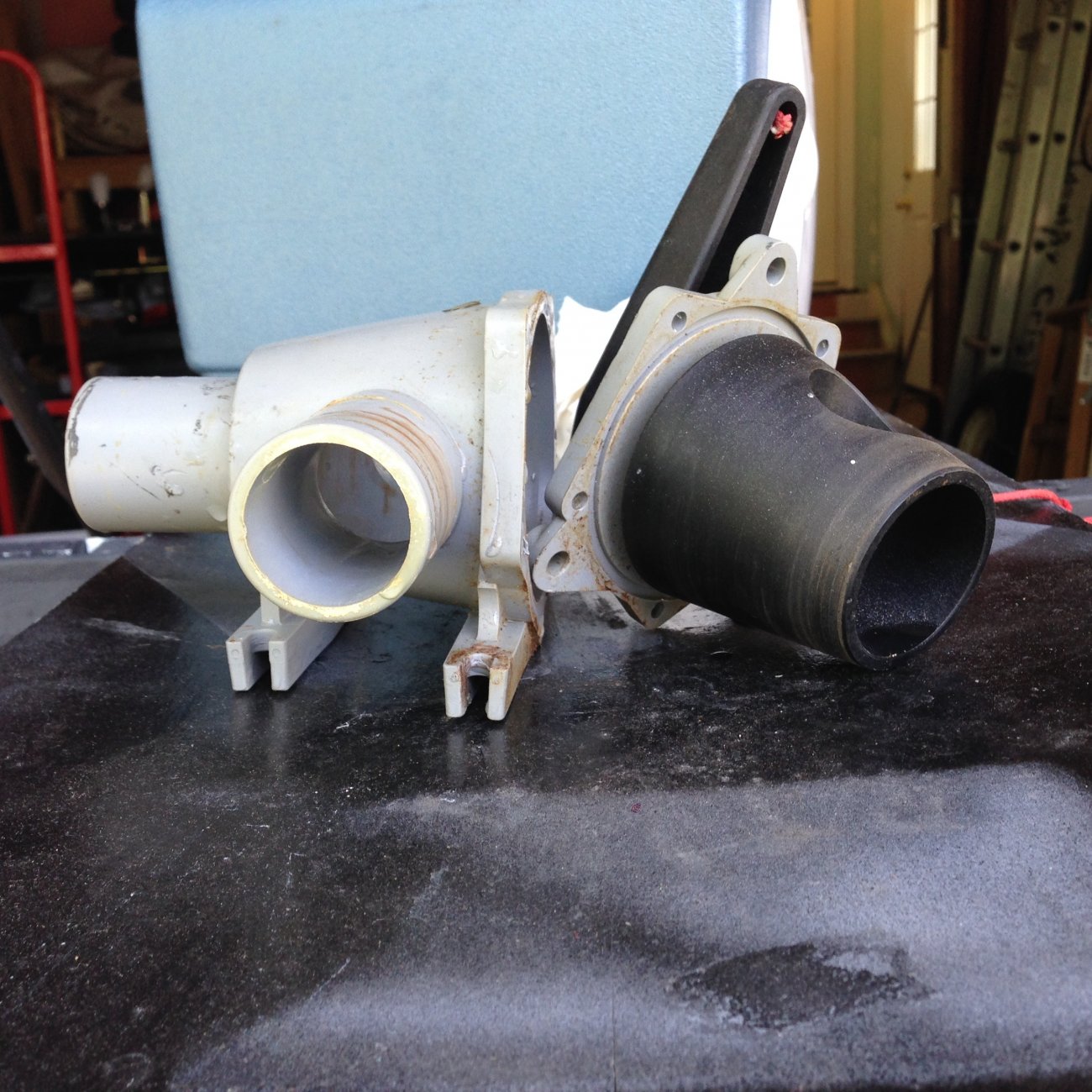

While it is more work, removing the Y-valve from the boat and cleaning it at home is way more fun!
Before:
During:
After:

I don't think there are enough bottles of a vintage adult beverage to woo me into traveling to New Bedford MA to wrestle with smelly sanitation hoses. All of my hoses are less than 5 years old and I'm thinking the next owner can deal with them. :biggrin:
When I took a look at the Y-Valve and saw the calcium build up I was quite surprised. My boat has lived most of its life in fresh water and the overboard discharge has been disabled. It did spend one or two years in salt water in the Caribbean early in its life. That seems like a lot of crud to build up in 2 years and I'm not surprised that the prior owner didn't clean it, cause he didn't clean much on the boat.
It was kind of fun making calcium chloride and hydrogen gas in the back yard. Reminded me of the fun days in the Chemistry Lab when I thought I wanted to be a chemist.

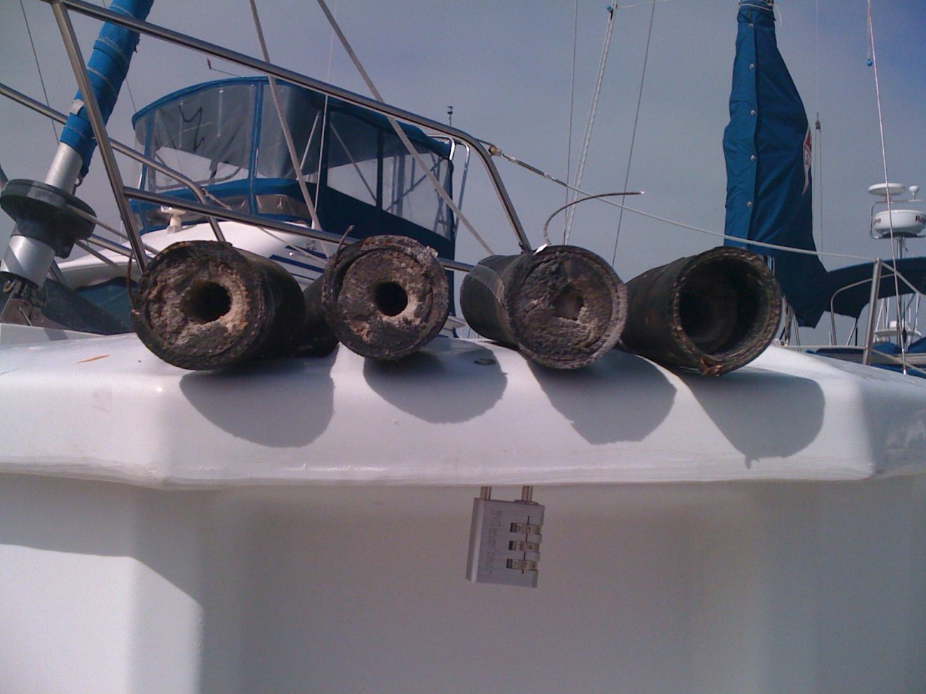

Bob doesn't indicate which state his home is in and Google Maps came up with no fewer than 3 New Bedfords including one in NY.
You'd be amazed at how quickly sea water minerals can clog a hose, especially in warm waters. I posted this photo to another thread just a few days ago....what you're seeing took only few months.
