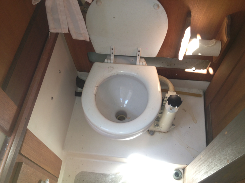

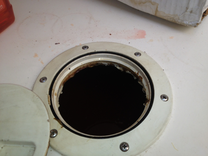

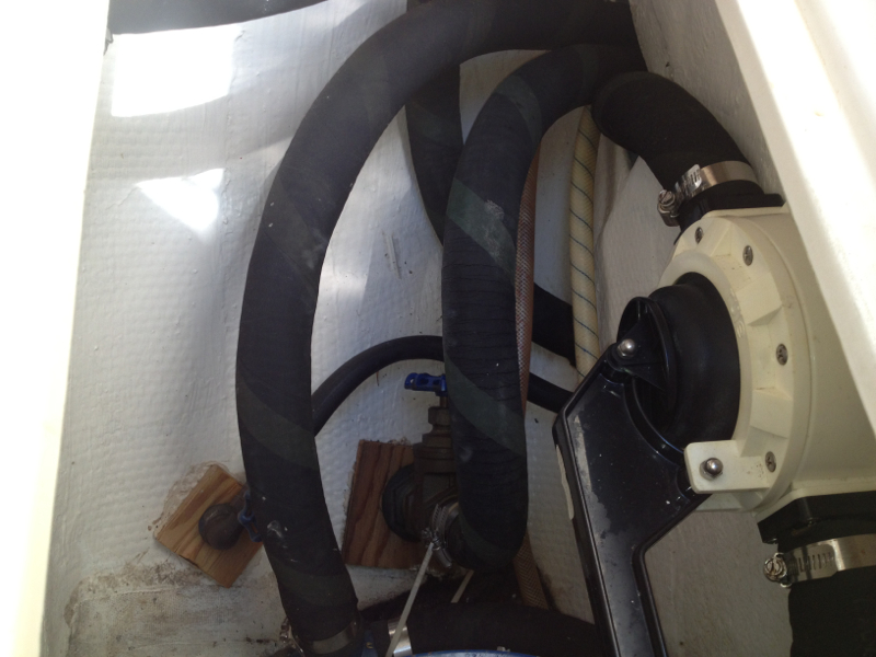

Here are some shots of the tank
Full. Wasn't that bad since adding the enzyme last week. Can't believe whaler pump works still. All flushed and cleaned. Now I can remove the head for replacement.
Not a ratitan.
