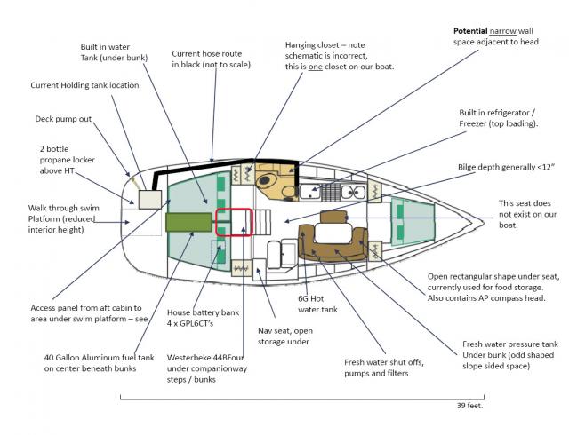

I did reply to Peggie off-line but thought I would share this schematic here with all in case there are other viewpoints. As you can see there are setees but on the other side of the boat and most already have something under them. The two exceptions are :
- The nav seat, maybe 3,000 cu in or 12 gallons, certainly smaller than the current HT
- The setee marked 'open rectangular shape under seat'
Shelley - Yes we already flush with fresh water using the shower hose to do so, however I still have the leak in the tank requiring replacement and I still have the long hose that detrius diluted with fresh water can build up in. Flushing with fresh water is one reason I am hesitant to sacrifice my rear fresh water tank - I use approx 10-15G of that the water in that tank to flush with. If I were to convert that fresh water tank to a holding tank I would need most of the water in the forward tank (both are around 45G just to flush the head with and would have no water left for other purposes - problems, problems, problems. :)

Great schematic. Is there additional space forward of your "potential" space behind the head, which looks to be behind your galley fixtures?
Aug 30, 2010
12
Beneteau 381 Portsmouth, RI
That area is cabinetry - plates and stuff. See pic of another 381 scavenged from the web. The wall behind the head is the one just showing on picture left.
There might be space under those cabinets with the doors open and behind the top opening fridge - I just wouldn't know how to get to that space (it must have refrigerant lines and propane lines running through it currently)
