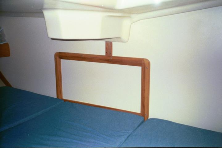

Sooner or later you will have to cut the opening in your back bulkhead. Check the archieves for the instructions on how to do it. Once you have the opening,then you can do your maintenance and be ready for the next step. That is replacing the tank when it starts to leak.
