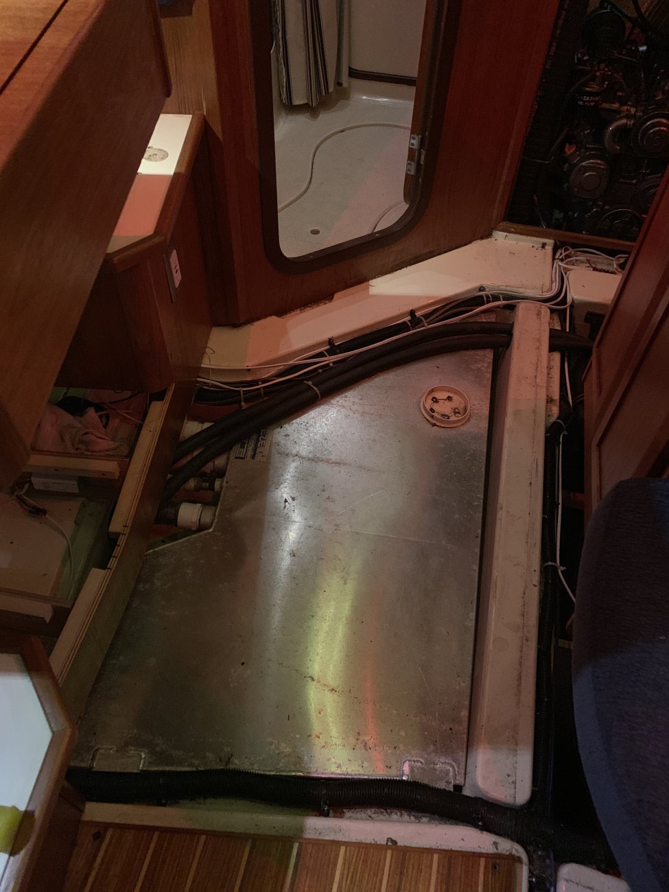

Hi All
Finally replacing my holding tank on Pardon My French.
I think we have the work plan figured out with some help from some of you.
Do you know where/how to change the forward head hose?
The hose to the aft head is cracked, so I assume the forward one is as well or will be soon, so now is the time to do it.
any insight very appreciated.
thanks!

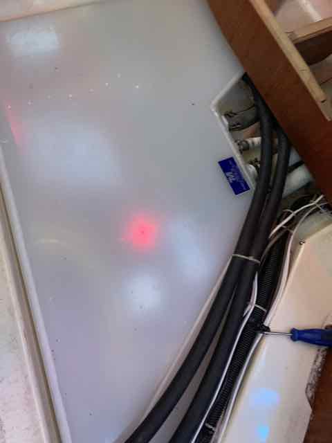

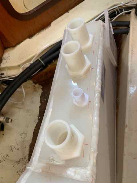

Thanks all for the replies, they are very appreciated! The tank is replaced!.
After careful inspection, I decided not to change the forward hose. Not really a shortcut, the forward head is lightly used and the hose appears odorless front and back. The aft one tho was cracked (!!!). The rest of the project went according to plan. I think I had the same issue as HU40.5 with the tank not being emptied at pump outs. As you can imagine I thoroughly cleaned and emptied the tank before removal... only to find it was not empty when we lifted it out. Disaster was averted but there was a bunch of stuff still remaining in there. We also found out that the vent was completely clogged. I used the common TripleM replacement, Trident sanitary hoses, the fittings from Fisheries Supply in Seattle, and a SCAD tank monitor (we'll see how that works). It took about 8 hours to complete the project with two people. Amazing how quickly the odor disappeared. Very happy to be part of a graduate for the holding tank project. Thanks again for all the tips. Feel free to PM if you have questions.

Use 3M 5200 when attaching fittings
Sorry, bad advice. Assuming that you're referring to installing female fittings in the tank 5200 is the last thing you'd want to use, especially if the tank is PE, which 99% of 'em are 'cuz neither 5200 nor any other sealant or "glue" will bond permanently to PE. And while it may be "permanent" on other materials, it can--and will--leak. But it shouldn't be necessary to install fittings. Ronco Plastics, Triple M and other tank mfrs install tank fittings in the sizes and locations specified by the customer when they make the tank. There are people who order "blanks" and install fittings themselves, but using anything except a Uniseal UNISEAL is doing it the hard way.

The tripple M tank is made of polypropylene with threaded female connections for the PVC pipe that the hoses are attached to. I did several trials to make sure that threaded connection was leakproof by filling the tank with water. It leaked maybe because I cross threaded the PVC threaded male into the tank or a bad thread. In any case after cleaning and applying the 5200 I have not had a leak in 5-7 years when the job was done. If it had been leakproof I probably would not have put the 5200 on the thread but at this point Happy it was applied.
Likes: Rick D
Sep 25, 2008
7,495
Alden 50 Sarasota, Florida
When I got a replacement tank from TripleM, it had no fittings intentionally omitted to facilitate installation. I used 5200 simply because that was the only stuff I had at the time and didn't want to bother shopping. It held fine with no leaks during pressure testing so I wouldn't be too finicky about it.
