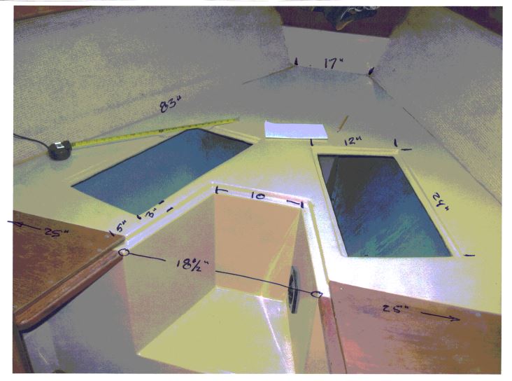

I have given consideration to cutting the pan under the V-berth to leave only a 2" flange and the stringers, and then to cover the whole thing with two pieces of 3/16" plywood cut to conform to the shape of the current V-berth cushions. I would then screw the plywood into the flange and the stringers to hold it in place.

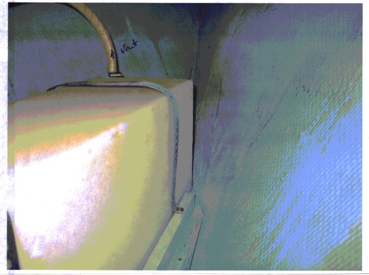

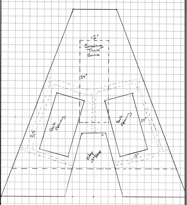

Below is a drawing and two pictures, courtesy of the PO of my boat, showing the dimensions of the standard pan and tank in an O'day 34/35;

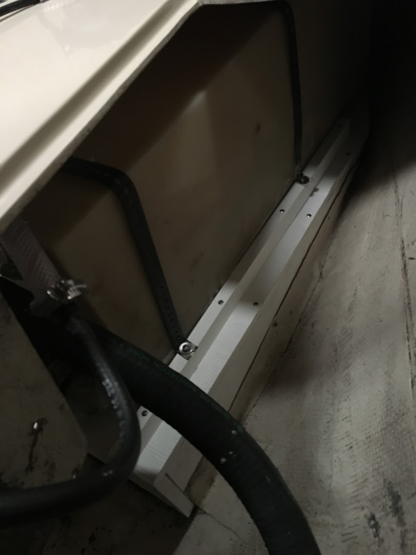

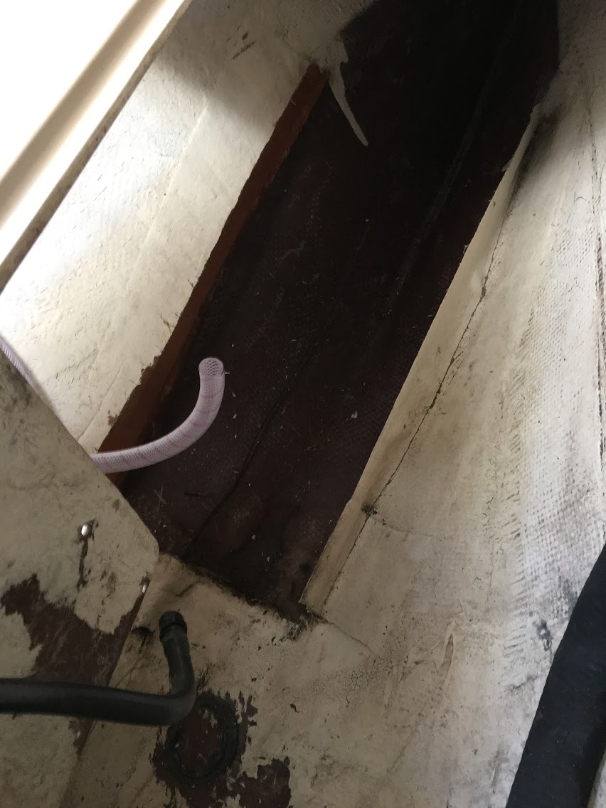

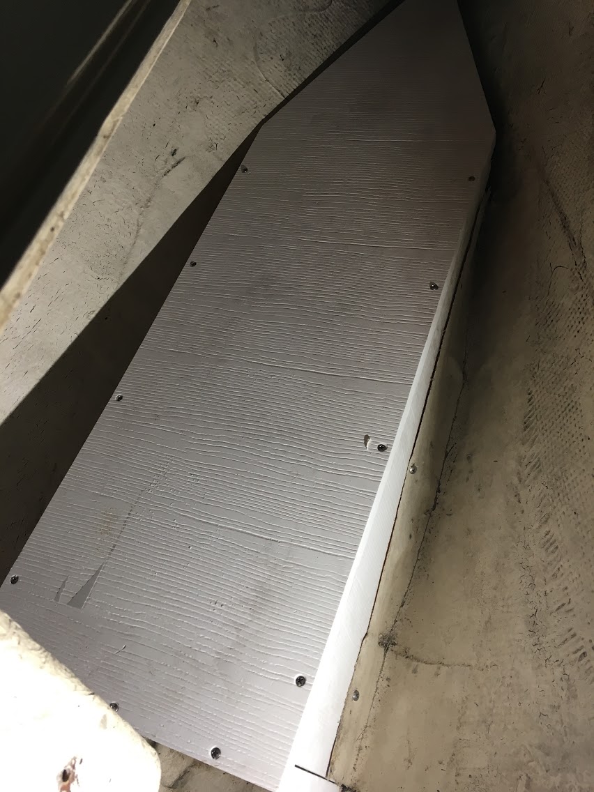

The dark area is where I removed the old pan area. It was made from plywood and was totally rotten. Once I cleaned up the area, I built a new pan to replace the old using PVC board. No rotting, no smells and easy to clean

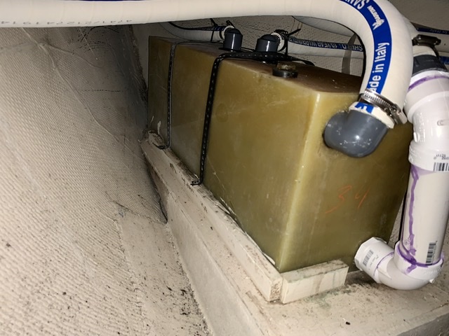

With the clean tank installed with retaining straps

Thanks for the measured photo. I am considering putting an a.c. unit where the v berth step is by cutting the step side sides away and putting the air return across the opening.

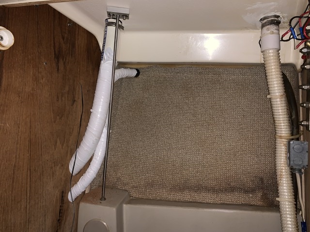

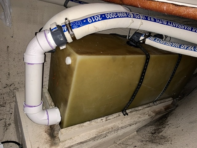

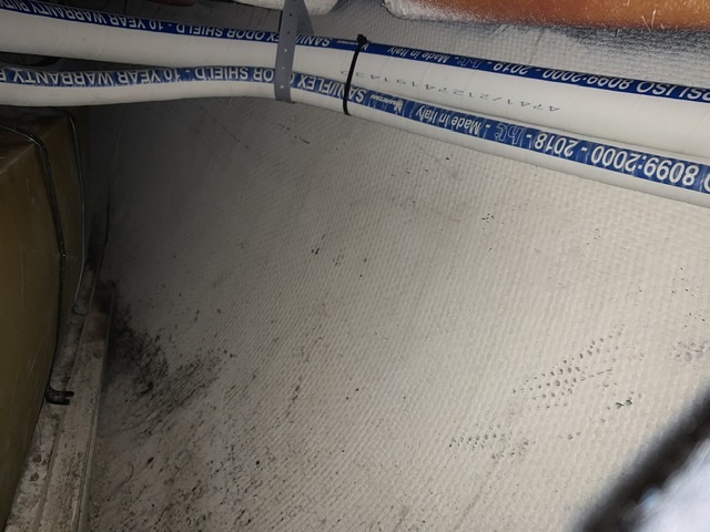

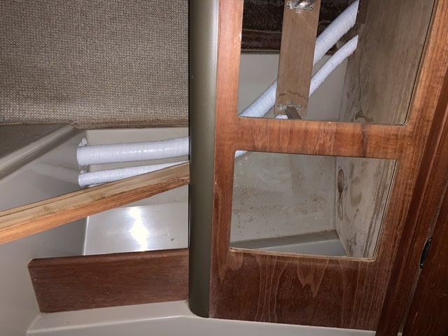

Do you recall which Ronco tank you installed? I couldn’t find one I was confident would fit so I replumbed the original tank and rerouted the new hoses to avoid the low spots. Here is the pump out and old vent hoses.
4D4D6F2E-C048-4FDF-A455-6607C4BABE81.jpegD4297833-D791-4506-A7E2-54AC54F1BCC0.jpegDF9BCCB9-9786-479A-B966-61B70A4BB0C9.jpeg5B2669F3-CDD6-4317-9C17-90BA16E0A577.jpeg

Best bet is to have the hoses enter the tank through the top, and use dip tubes for the pump out and macerator (if equipped).
Hoses that enter through the bottom will eventually start to smell.
I like the PVC tubing pictured above, but would want to support them to prevent any possibility of their breaking.
I agree, it wasn’t my first choice but was easy to fabricate on short notice. It is sturdy with the hoses zip tied together but I think I’ll add a 1x3 protective shield around the PVC in case something starts rolling around in there.

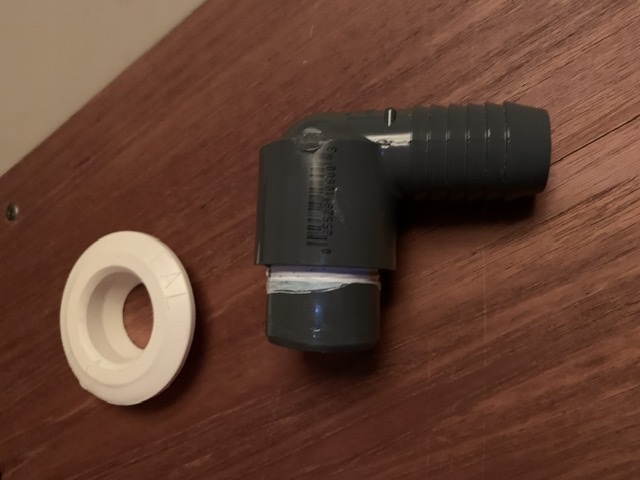

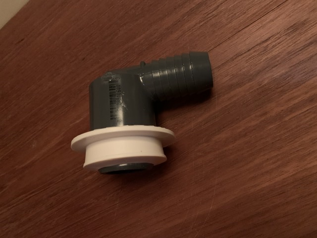

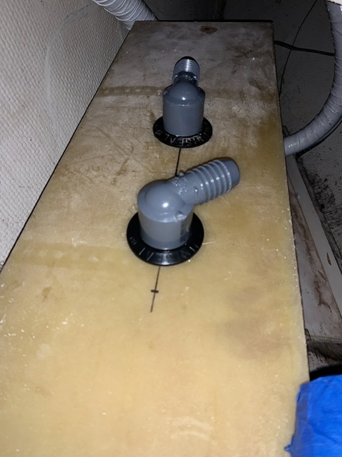

BTW, I upsized the vents to 1 in and moved them to the top of the tank using Uniseals and elbow fittings. When’s it’s warm enough for 4200 I’ll install the forward bow vent through hull. Wasn’t confident enough to do that with the head discharge line (Uniseals are press fit - not threaded) but may consider it if I don’t replace the tank.
524FFB0C-7EDF-4073-84F0-0D02BE1F5EC2.jpeg6DFFBC56-9649-4260-AEB0-5EFDBA481502.jpeg0A6F53CE-8B94-4575-BB26-324E3DD1A5FA.jpeg727143E8-57E8-4BCD-BDE0-F92CA46E620F.jpeg
