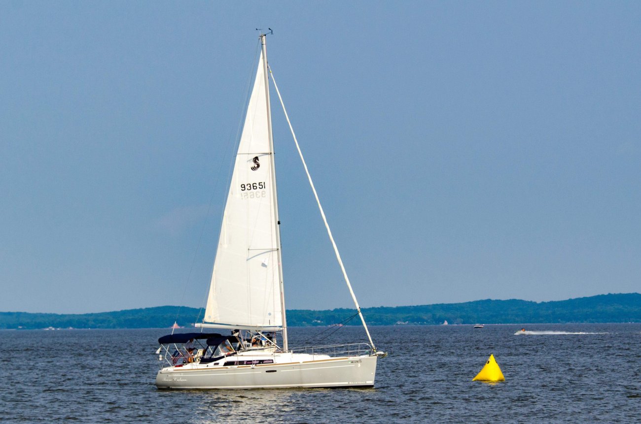

3. I raised the main to the top of the foil and found the main sail tack to be a good 12-18 inches higher than the tack connection point on the furling drum. Had to lower the sail back down from top to connect. Seem the main sail luff could be extended a bit and still leave room to tension the luff sufficiently on the foil. Is this amount of gap standard on all furling mains.
Here is a picture of our main fully hoisted -
At the top of the mast you can get an idea for where the top shackle goes relative to the black band, and where the band is relative to the masthead. There is certainly some space there. I don't know whether that's to prevent interference with the backstay or to accommodate future stretching or measurement imperfections.

3. His explanation as to why the sail looks to be 12 inches short of the top, is as David suggested above "future stretching or measurement imperfections." He said they have a % calculation that tends to leave the sail a little shorter than it needs to be.
He did mention that this calculation could be tweaked for some added length when I replace/upgrade my sails $$$$.
