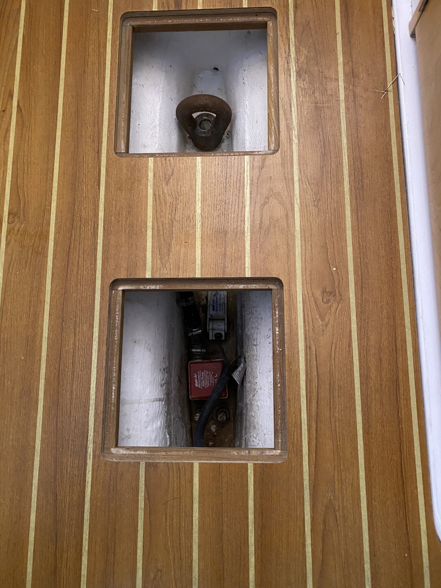

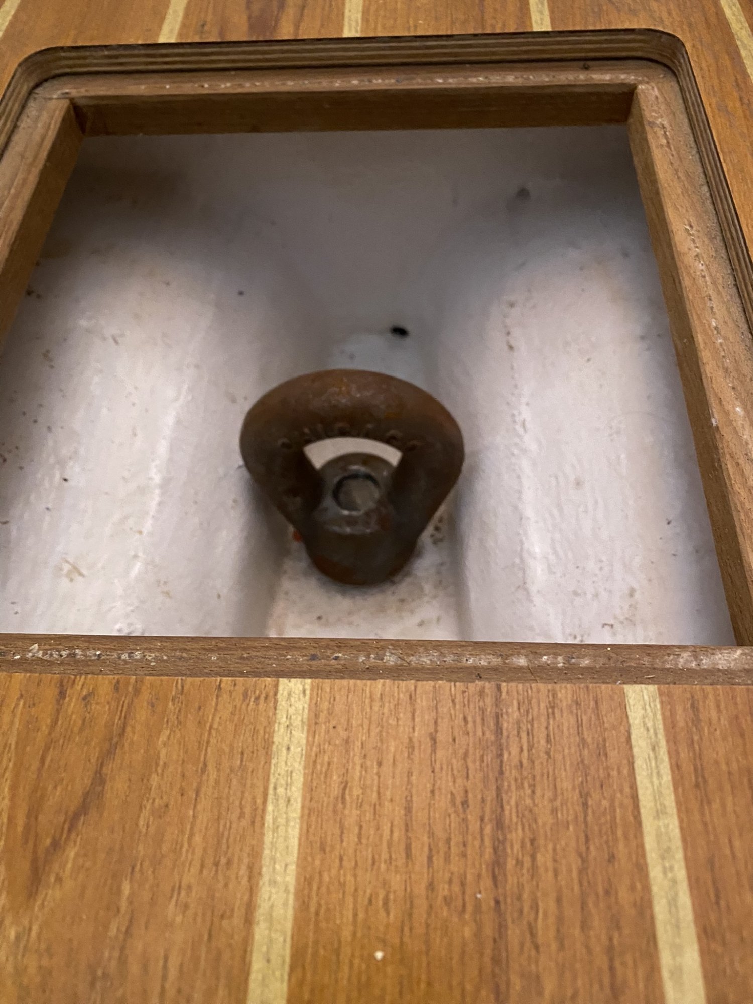

My C275 has a lifting ring in the bilge and came with a cable to connect the ring to a crane. Aren't these standard items with all C275s? BTW, I have never used mine to lift the boat, but good to know it's there if I need it.

I wish it was a standard item, unfortunatetly it is not and I'd suspect was an after market item from the PO. It would be great if you could post pictures of what you have (Ring, Cable etc) so I can look into replicating it.

Thanks so much for sending the photos along. In my boat the bolt that you have the ring mounted to extends all the way up to just under the the wooden hatch that you have open to see it. I wonder if that means your bolt is pushed further into the keel or its just shorter than mine. In any regard I'd have to shorten mine if I wanted to leave the ring in place. Question on the length of the cable. is it just long enough for it to peak out of the over head hatch once hooked onto the ring. Also there are two other lines attached to the top of the cable, are they to attach to the winches to hold it up and keep it centered?

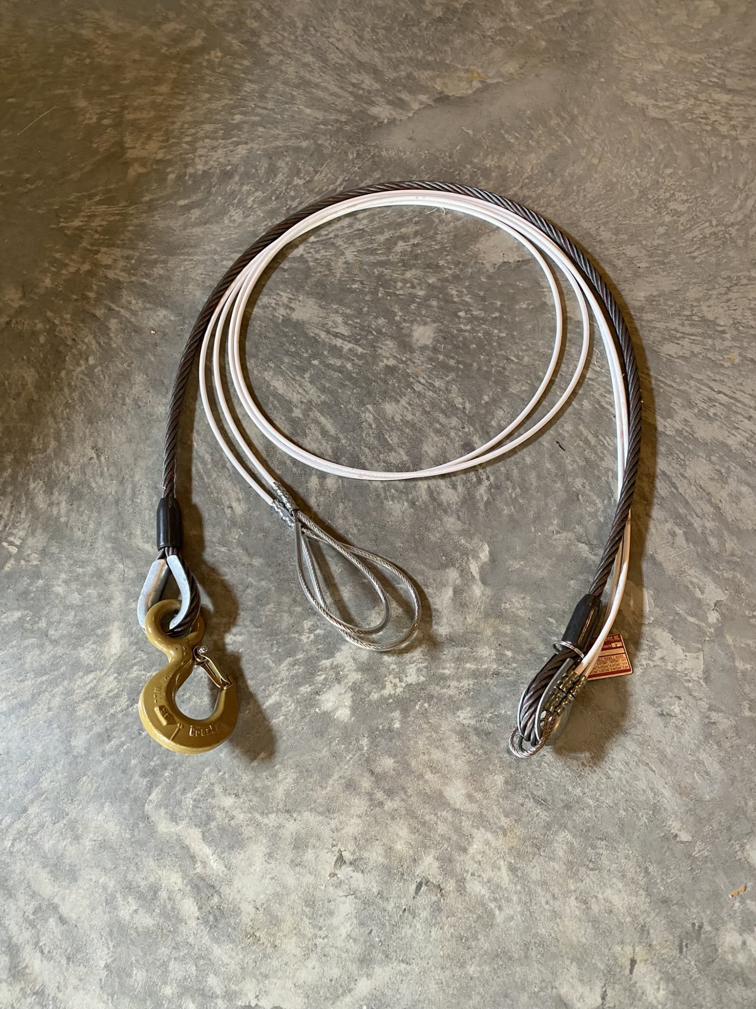

The primary cable is 7 feet long, including the hook on the boat end and the thimble on the crane end. The two white cables, with a loop on the end of each, are each 12 feet long. I have not used the set up to hoist my boat, but imagine that the white cables are manually held out to the side to stabilize and help to maneuver the boat while hoisted. The cable set up was included by Catalina with my boat, so might be best to contact them for specifications and instructions. Let us know what you find out. Thanks.
