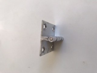

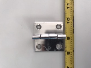

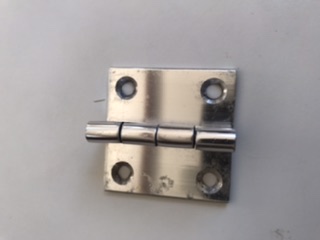

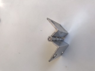

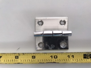

Fellow Hunter owners help me!
All I need is one hinge for my bathroom locker door, I’ve searched hi and low and it seems to be one of those elusive boat parts. Yes I could change the hinges etc etc etc. But so much easier to just install the right hinge.
If anyone can tell me where to find one much appreciated.
See pics, seems to be made from aluminium.
Joe
Jun 1, 2004
8,306
Interesting .... it's called an "180 deg inline door hinge" and you probably won't find it if you include "marine" in your search. I found this bronze version under "special application hinges" at an online hardware store.
Click on the picture for manufacturer's link. Note that nickel plate finish can be special ordered.
Of course, if you have a good vice you could probably make one yourself from a wide butt hinge.
