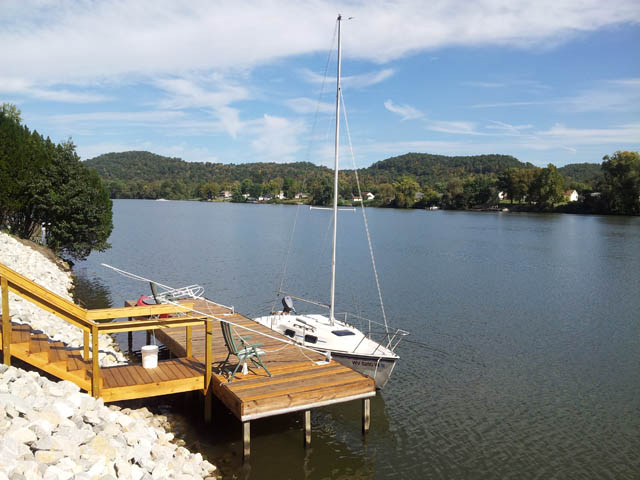

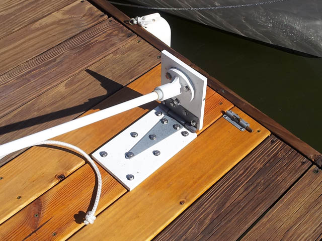

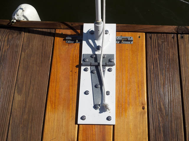

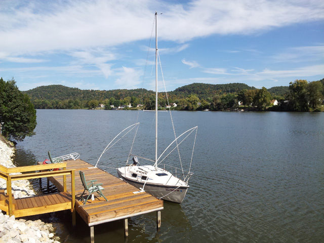

I've been using fixed bases with my mooring whips for several years and snagging shrouds on the whips periodically the whole time. There are products from various manufacturers on the market which could solve my problem, but they're kind of pricey, so I decided to roll my own. Here are the results.
