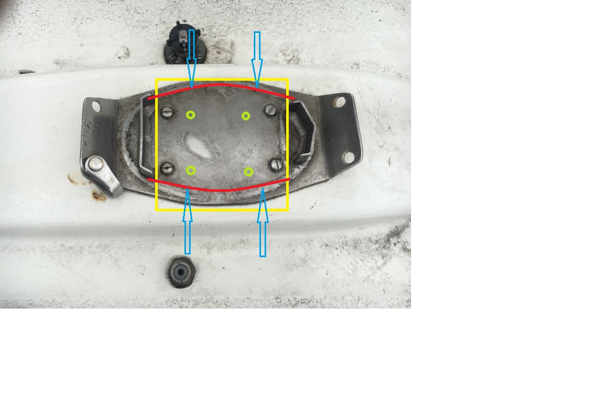

Ok, so the above drawing would be using your existing mast step with a rectangular block of Delrin to make the plug.
Yellow block - The block should be at least an inch think, 1.5 would be better and I'd even go 2 inches if I can find a hunk that thick. Its dimension should fit between the fore and aft vertical tabs and stretch across the profile of the mast section on both sides.
Green circles - This just shows that the four mounting holes may need to be relocated to match the four holes on the upper plate of the Ballenger Hinged plate. Those holes should be tapered on the bottom of that plate so flat-head machine screws come up from the bottom through the hinged top plate, mast step and Delrin plug and secure with washers/nuts, probably recess the holes with a Forstner bit in the top of the Delrin plug.
Red Curve lines - Cut the block sides to the profile of the inside of the mast. A band-saw is ideal here, but it can be done with a jig saw or even by hand with a coping saw. I'd leave a little excess material, especially if cutting by hand. Then, on a stationary disc sander, refine the curve. This ensures a square surface. The mast should slip over the plug but not have any gap or the screws/bolts that secure the mast base will squeeze and distort the extrusion.
Blue arrows - After you have a nice fit over the plug, you can drill and tap machine screw into the base of the mast to secure the mast base to the plug.

You have to make sure the hinged plate you buy is big enough for your original mast step to fit on it, I can't tell the dimensions of anything from the pics. The alignment pin has to be taken into consideration along with a clearance hole in the plug to accommodate it. If your old mast step wont fit squarely on the hinged plate, we have to start from scratch and we loose the Vang tabs.
