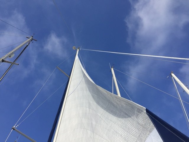

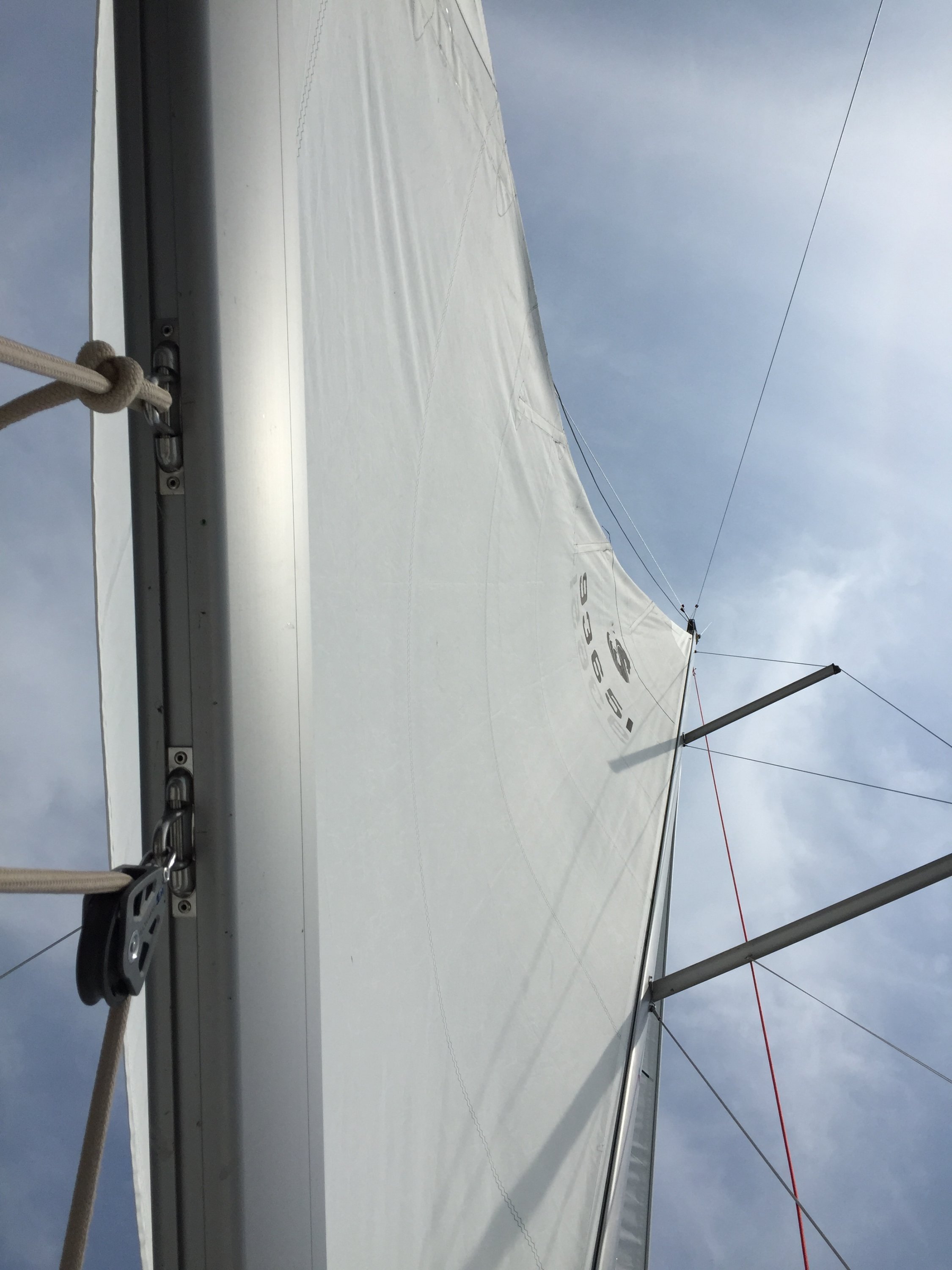

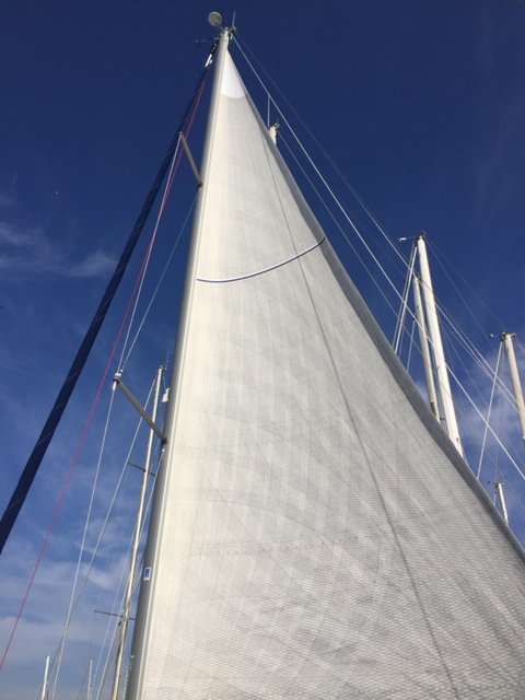

Here is a before and after they made some adjustments. Now it looks better. The reason they give for the still missing 25-30 cm is that it is a furling sail and it takes up space in the top.
THAT is a VERY good reason. No excuses there. Imagine if they'd copied your old sail!!!

Assuming Stu is tongue in cheek I'll second that. We also have a furling main and the sail goes pretty much to the black band. Certainly not over a foot short of it.
