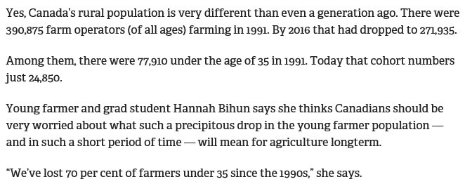

I was raised in a farming community and have a first hand perspective of how weather can impact a farms livelihood. A big part of the make or break is the ability to get your product to market when the price is high. Too many "lean" years and your out of business. A lot of that product gets moved via ships. Here is a little info on Canadian farming, next time you eat - thank a farmer (and maybe a ship owner). Oh and I live on property that was flooded in 2017 and 2019.
Does Canada have enough young farmers? | Country Guide
