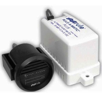

Find the alarm and work it manually if you can--see what happens. It is activated essentially by a float switch. On some, you can manually test (manipulate) the float switch with a little lever sticking out of the unit. The alarm and the bilge pump do not have to be the same unit. On my boat the alarm goes off at a water level slightly lower than that which activates the electric bilge pump. Also, there should be somewhere a switch to turn off the alarm. You do not want the thing buzzing all the time you are looking for water ingress.

This is the unit I have. The white box (float switch) has a little lever sticking out near the bottom at the back so you can manually test it. (See post #4 above.) I had to install a switch to turn it off when the water is still high enough to activate it.
