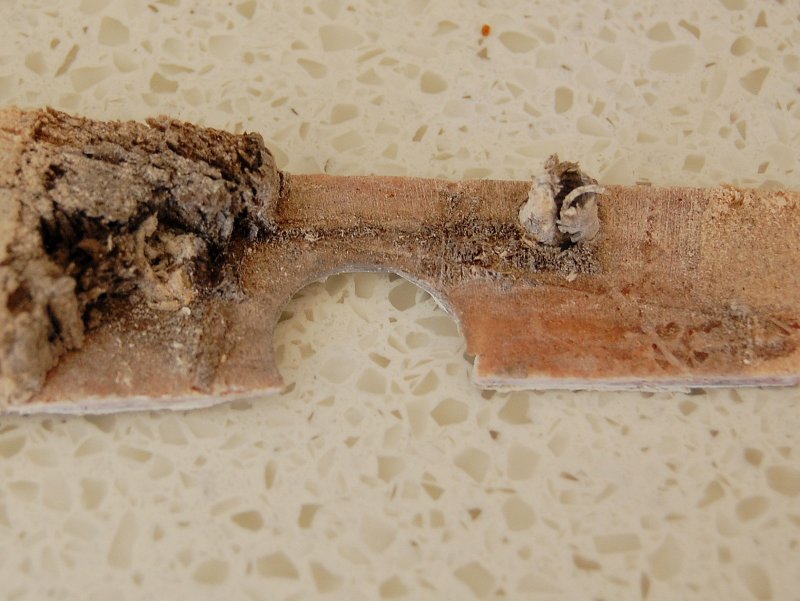

My 2005 C-310 had multiple deck leaks by the end of the 2005 season. She was completely re-bedded over that winter. Was the sealant bad, no, it was the installation and the lack of a countersunk hole that led to so many failures, over 5 leaks in less than one year from new. I actually re-bedded that boat using the countersink method, with 3M 101 and some butyl, and no more leaks.
Even this DIY band-aid of extra goop between the gasket and the hull and stanchion did not help. It still leaked and the deck was soaked!
This is a section of the deck taken from under the bow pulpit. The big hole was the core sample where they found nothing coffee ground like MUSH.
And the deck side. Note the rust right around the bolt holes and the rust under the entire gasket from the leak causing the bolts to rust.
Builders like this should be strung up by their toes.:cussing: These stanchion bases are a complete and utter joke. On top of the piss poor nature of this stanchion base the builder embeds aluminum than taps the stainless bolts into it. What happens when stainless and aluminum get wet with salt water? Yep they corrode and freeze solid, might as well be welded. Vessels like this will be MUCH harder to repair in the future because the stanchions go right into the toe rail with NO access for a nut on the inside. When the bolt breaks off due to leaking and corrosion between the stainless and aluminum the stanchion will need to be moved or an attempt at drilling the broken machine screw out of the toe rail will have to be successful. If they had at least countersunk around the bolt they MIGHT have enough elasticity to survive the piss poor construction of the stanchions that allows the movement. Even this marine sealant could not withstand the poor construction of the stanchion bases that lead to this much flexing. Every stanchion base on this boat was bent.:doh::doh:
