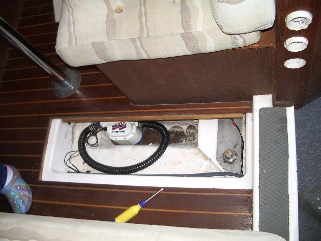

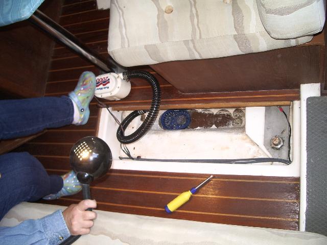

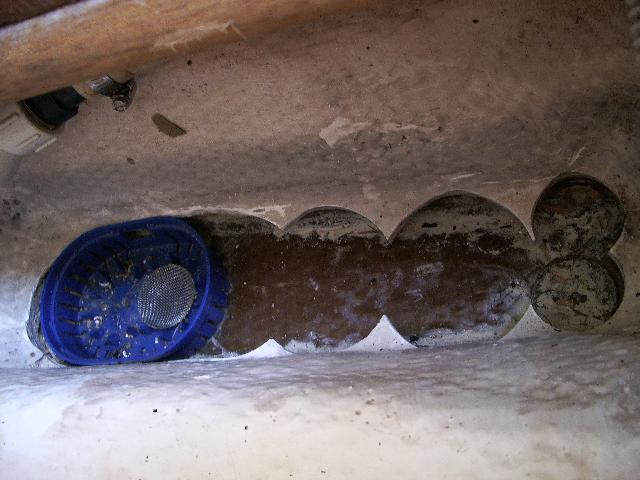

I'm the 4" hole saw guy. Here are some pictures of what I did to my "false bilge". I would strongly recommend you do not fill any area with resin. You do not want to impede in any way the progress of the water to the very bottom of the hull. Instead, you want to gain access to that area as that is exactly where the water is going anyway, right now. By attempting to block it will never be entirely successful and instead will trap water where it can't be removed and it will turn septic and stink.
The hull liner was bonded to the hull with passageways to allow water to migrate between the layers. Unfortunately there is a bottom to the hull liner forming a sump that is suspended about 1" above the actual inside surface of the hull. Water collects under there and actually is as much as 12" above the bottom to the lowest drain holes inside the perimeter of the sump area. On the underside of the hull liner is a piece of 1/2" plywood that is now rotten because it is always saturated. Cutting out the bottom of the sump allows removal of the rotten piece of wood and access to mounting a bilge pump directly on the bottom of the boat. Don't worry, the hull is 1 3/8" thick down there so you won't be drilling through. Besides, the keel is under that as well.
As you can see from my photos, I used a large hole saw and made a series of cuts. The first penetration allowed trapped water to well up until it sought its own level. It was black and really smelled. Once that was bailed out with a sponge, the rest was cut out. I used a multitool to lop off a couple of the points to make room for a 2000 gph pump. As I said, the back side had a plywood board that was rotten. After getting all of that out, it is really easy to rinse the interstitial space between the hull and the liner because it all comes down to the bottom where the bilge pump now sits. With a dripless shaft seal the bilge stays completely dry for months at a time and the contribution to odors is eliminated. The task did not take that long.....4 x 4" holes and 2 x 2" holes. Probably could do the whole job now with a multitool and a few blades as the fiberglass does dull them. Clean up and remount the bilge pump. Done.

Allen12210 thank you for the pictures….
I have a H31 of the same era. My understanding they are of similar construction.
I have drilled small holes in the sides of the existing sump bilge pan to drain the under liner area. Even though it has made a difference, it only gets so much water out and I know that there is still stinky water trapped below.
I have seen previous notes about “opening” this area up to get to the actual hull. Now with your pictures I’m sold! You say I should expect a gap of about 1” I’m sure it full of stinky water.
So perhaps if I fill just under the “true bilge” I’d still have water trapped around the slug of resin. Thinking about what the hull form looks like, that makes sense. Opened up you absolutely know there is no water trapped.

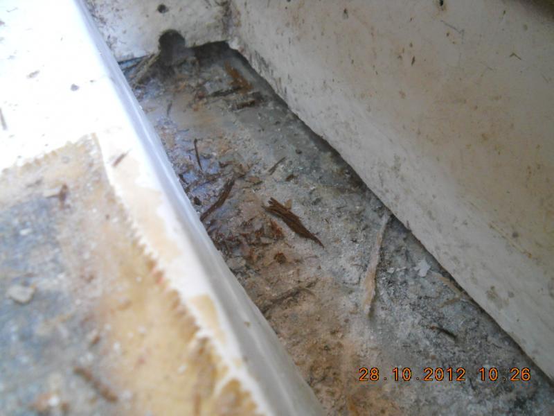

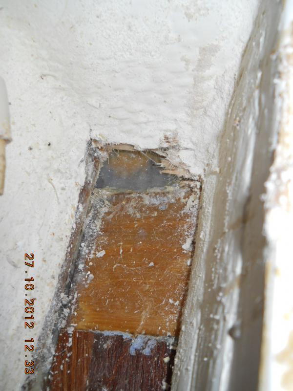

update
The 31 doesn't have a hidden bilge like the 34. I did a number on the bilge area at the week end and found in the bottom of the bilge is a layer of fibreglass, some pieces of plywood and then the hull itself. The stink is caused by voids at the fore and aft ends of the bilge and at the sides of the bilge also. To make matters worse, the ply isn't fully encased so water gets trapped between the ply and the hull as well where the bedding material wasn't thick enough. The gap is maybe 1/32 of an inch but it's enough.
I dug out the bottom of the bilge, chiselled out the rotting stinky plywood and trimmed the sides of the bilge liner 3/4" from the bottom. The water now has nowhere to get trapped.
DO NOT drill down at this stage, this is the hull. I have to be a bit inventive now to mount the bilge pump and switch permanantly and will post more pics when finished.
