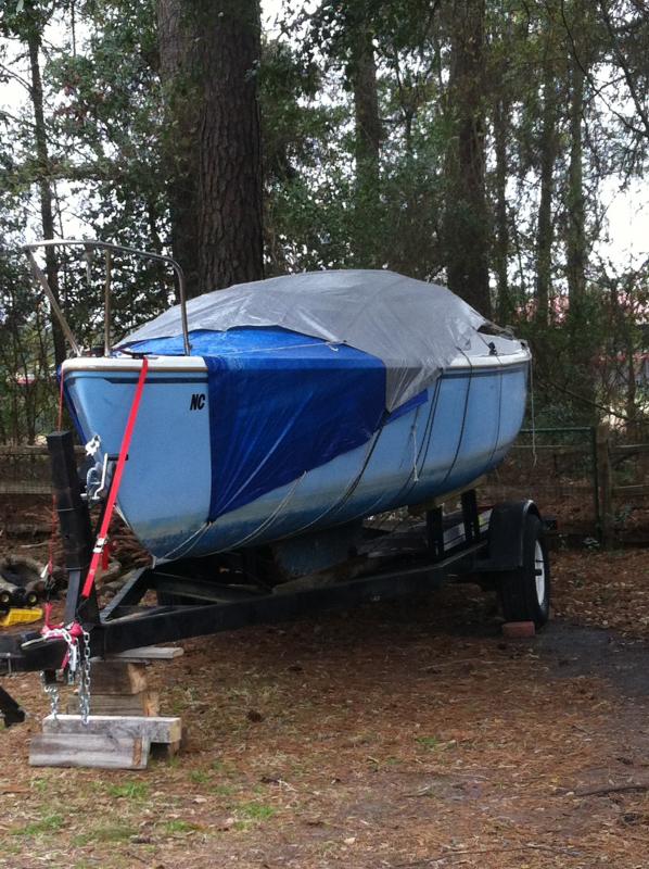

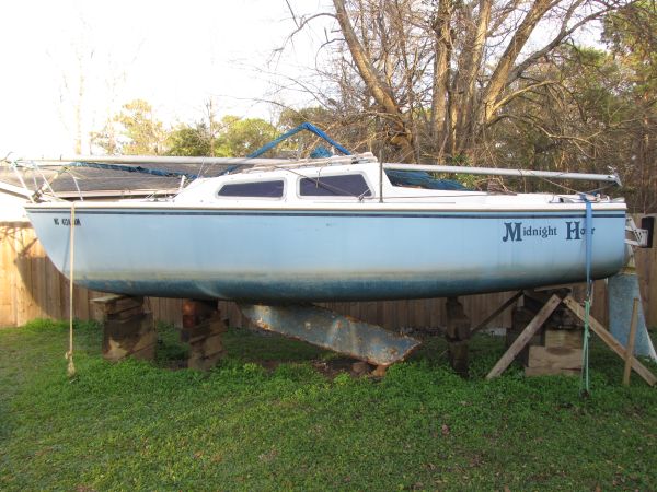

well we made it i now have my sailboat in my back yard and I'm a proud owner of a Catalina 22. this did not happen uneventful had to readjust about every thing we could but it works and now i can get the work done that i need to and I'm trying to get it ready by at least june so thanks for every ones help

Good news Rick. How about some photos? Don't forget the C-22 National Association too. A strong organization keeps our boats in demand. Besides, lot's of GREAT information and access to races or cruises, what ever trips your trigger!

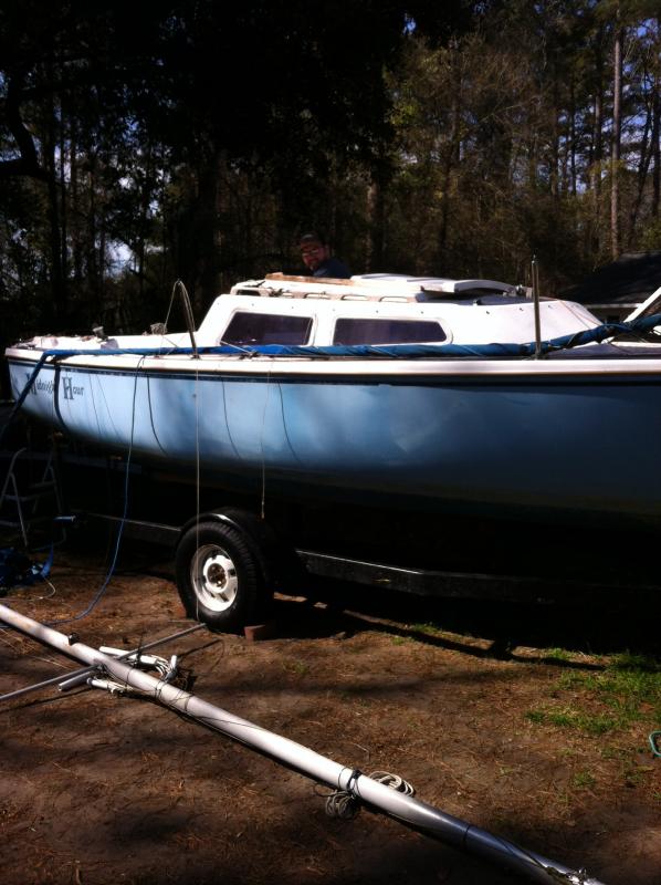

i have taken the mast apart and labeled every thing and now am trying to figure out where to start

Great deal Rick
I thought I saw a roller furler on the deck :)
One suggestion. Store the mast on the boat and drape the tarps over the mast not on the deck and cabin house. I have found that leaving the tarp on the deck will serve to help hold water IN the boat. You wil always get some rain in the boat but it will mostly evaporate... and keeping the tarps over the mast makes a sharper pitch for the water to run off.

Rick, Make sure you tape the open end of the mast closed while it is stored. I didn't and ended up with a sparrows nest way up inside. That was no fun trying to evict them.
while you are working on the mas, you might want to re wire it and while you are at it, I would recommend switching to LEDS for the steaming light and anchor light. Also, you might want add spreader down looking deck lights. I got some from superbrightleds.com
These: http://www.superbrightleds.com/more...watt-vehicle-mini-strobe-lighthead/1348/3099/
They can be wired for both solid on and with the flip of a switch to strobe.
and they could also be wired as strobes in case you want to be sure you are seen. (mississippi barge traffic, in my case) I also got an anchor lite from bebe-electronics and it is the brightest one in any anchorage.
this one: http://www.bebi-electronics.com/masina.html
It was a pain fishing all the wires, but it was worth it.

yeah i have to replace all the lights on the mast cause they have all been broken i was looking at the replacements on catalina direct but those look cool too
