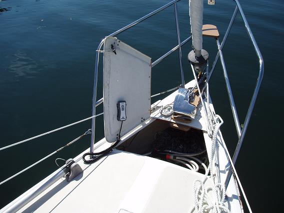

This is what mine looks like. Unfortunately, I removed my anchor because we were expecting TS Danny. It has the hump. I always open my locker to deploy or retrieve the anchor. There is a short wire cable with a clip that I attach to the lifeline holding it open. Had it shut on my ankle once. :cussing:

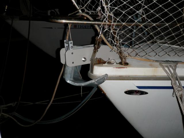

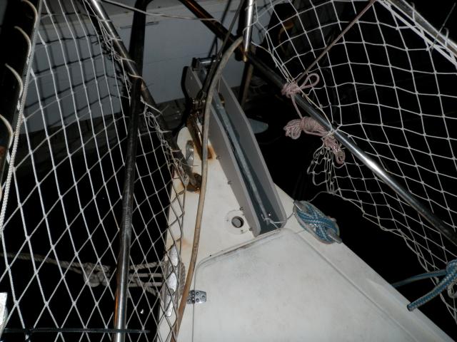

I just got the epoxy in to pot the holes. So this is a dry fit. I have to modify the aluminum part because it will cause chafe the way it is now. I got the roller really close to the toe rail but the downside is the tip on the the center claw will hit the bow when the boat moves. I'd have to put something there for it to rest on.
I have to have a support in the center of the bow pulpit going down to the chain plate for the stay.
On the port side you can see where I tore up the gel coat with the chain. This is a long way from being finished but not too far away from enableing me to anchor out.
I think it's a little ugly but I hope it works.
