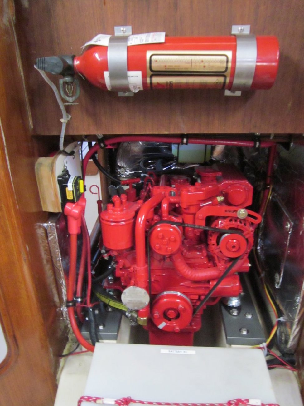

What system do you have ? Do you have a picture.
Did it come with a engine shut off and how does it work?
paulj
:hook2:
Our small diesel did not come with a "shut off" system, altho I can understand why that might be a good thing.
We do have the indicator light that goes out if the cylinder discharges. My guess is that by that time you'd know that something was wrong anyway. :(
I have a picture of the installation, with the solid engine step molding removed.
Main blog here: http://www.ericsonyachts.org/infoexchange/entry.php?677-Wiring-amp-Engine-Detail-part-2
