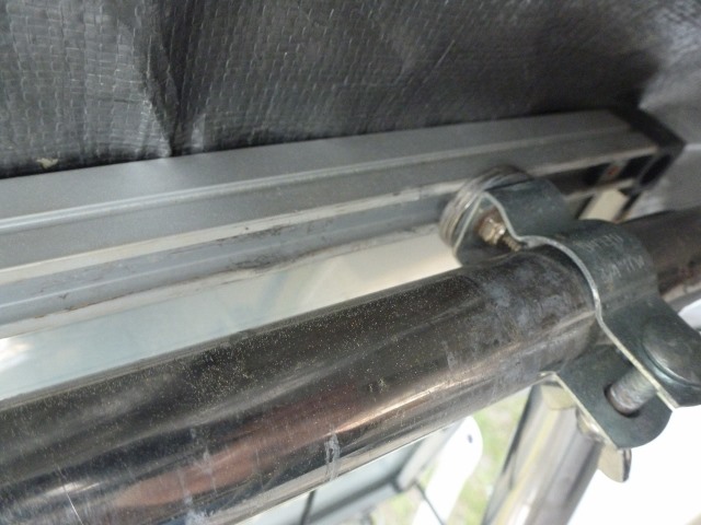

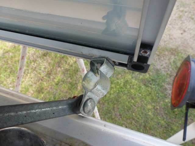

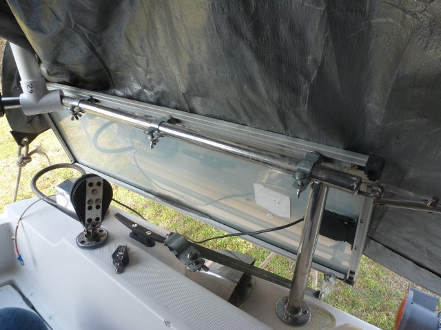

Hey dgreen can I ask.....how many watts is your soalr panel and how is it attached to the rail? I just bought 2 - 20 watt panels and I am wondering if that will do the trick and where to put them.

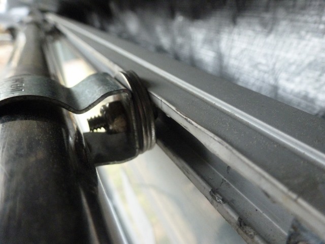

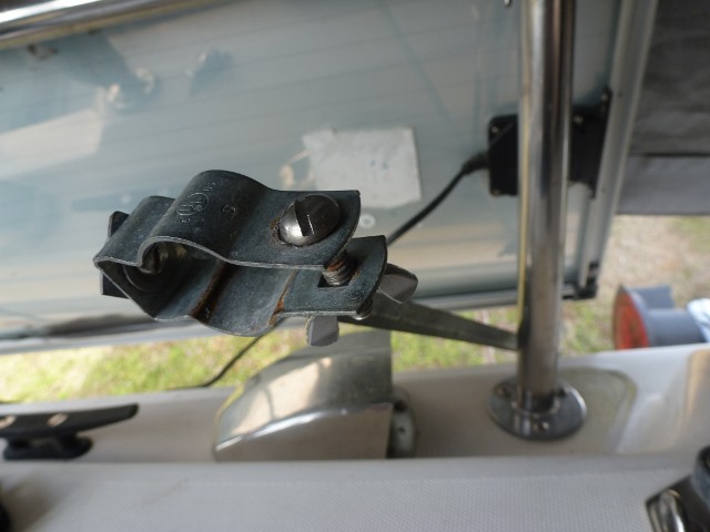

I think it is a 15 watt panel. The type that can be partially shaded and still charge. I bought it at Harbor Freight. I also added the battery minder charge controller battery maintainer. I mostly sail a week or 3 days at a time. It works surprisingly well. I paid around 60ish for it. I don't see this one on their web site any more. I used clamps from Lowes and added wing nuts to the screws. Unfortunately they are not stainless. I have had my panel for about a year. Here is how I did it. It is adjustable up and down by the arm and wing nut. Not corroded too bad yet.

Wow dgreen you are a genuis:) That looks simple and yet meets all the needs of being able to be taken off and installed easily and quickly. So you think a 40 watt total will do the trick? That ought to keep the batteries full right?
