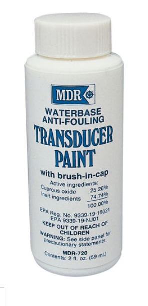

I'd keep any organic solvents away from the plastic surface as they may do further damage. The transducer bottom paint I use is a water soluble:
The stuff is powerful as every year the rest of the bottom has slime but the transducer is spotless. Rumour has it that it's recycled nuclear waste.
As far as what was applied by you trusty apprentice, I'd forget it as the worst that happened was that the plastic lens was slightly etched by the bottom paint organic solvents. No effect on the performance of the sensor as only air or disconnected layers of solid material will affect it.
