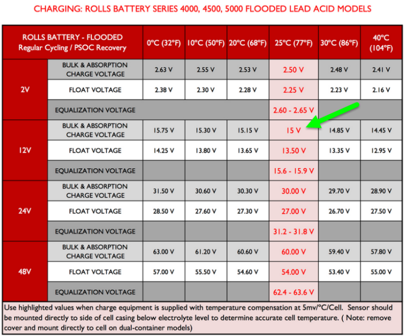

Rolls suggests 15.0V for absorption charging, temp compensated, for "regular cycling or PSOC use"... For "infrequent use or UPS / battery back up systems" they suggest 14.7V.

Amperage was showing between 3.5 and 6A. Interesting as I was using the settings based on what the Rolls booklet that came with my batteries is asking for, which is 14.7/13.15 when Temp compensated and 15.48-16.2 for equalization....

The batteries are 2016 EHW-220 which looks like they’ve replaced with a 210, but should fall into 4000 series....will have to give them a call....

Rolls just recently changed their charge guidance and were a bit late to the party. The entire industry has been late to catch onto what PSOC use does to deep cycle batteries. If not for the PV world, and the research done at Sandia National Labs, we'd still be charging deep cycle flooded lead acid batteries at 14.2V - 14.4V and getting 1-3 years out of them. US Battery changed and upped voltages first, then others like Trojan, and now finally Rolls. I find anywhere between 14.7V (bare minimum) and 15.0V makes a huge difference in FDC longevity in marine PSOC applications.
