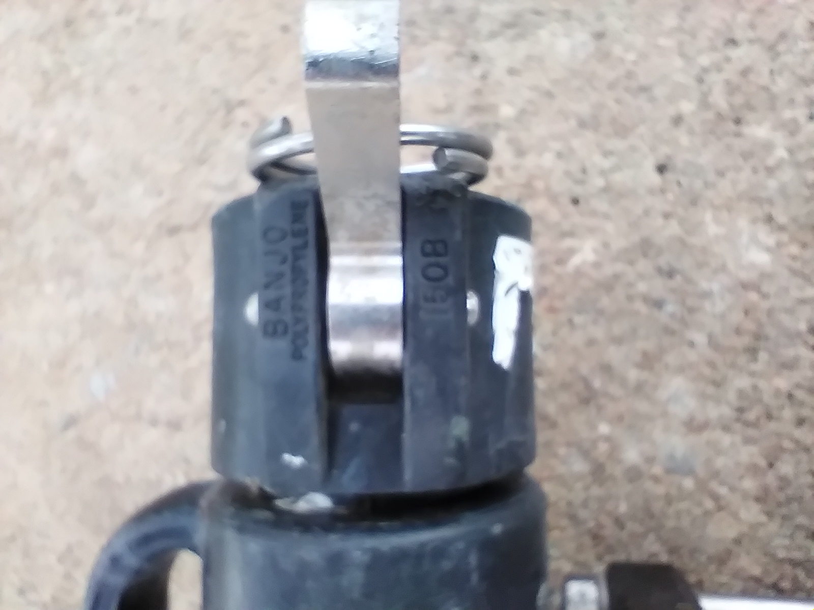

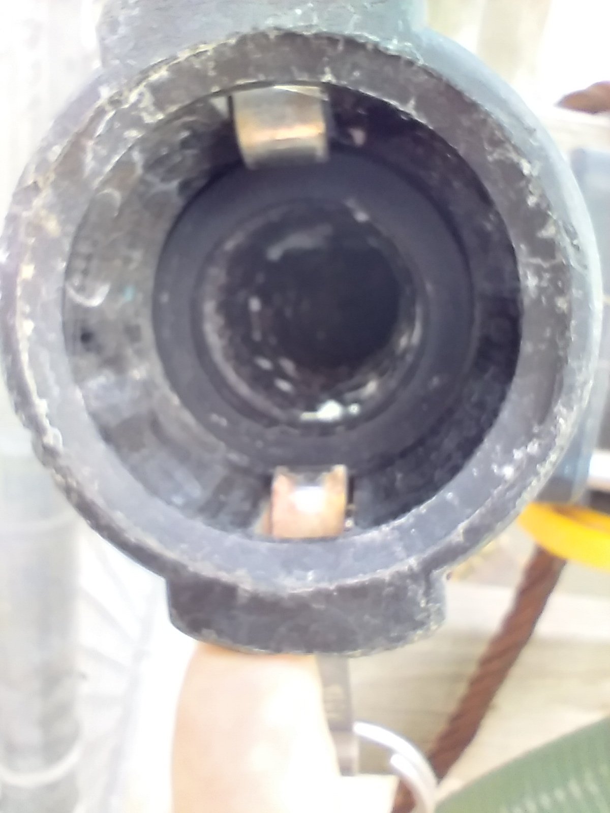

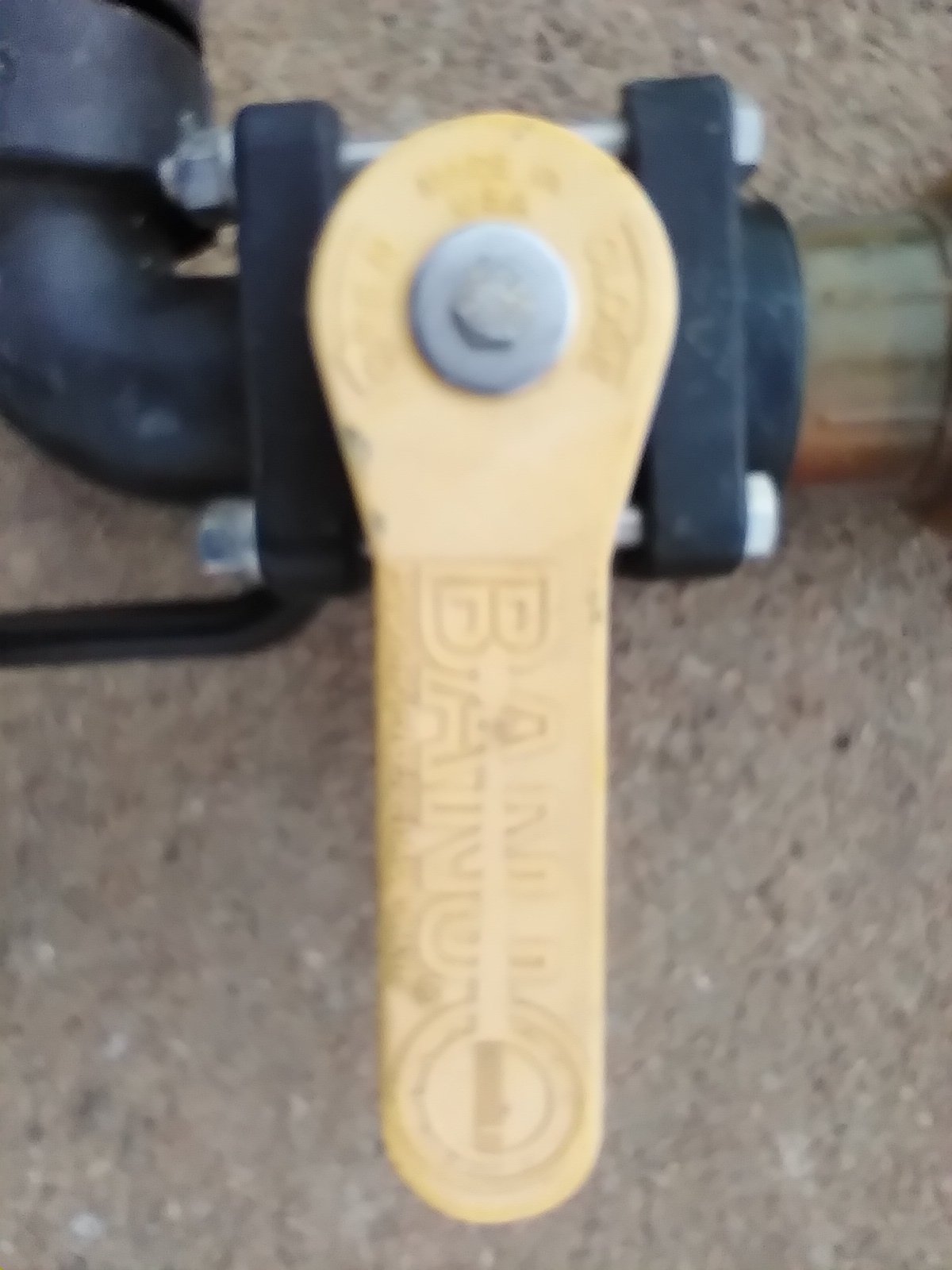

We're not clear on how far the park's responsibility goes as far as maintaining our pumpout station. I figure as harbormaster I'll just take car of this: I need a new gasket that goes inside the deck attachment valve/handle. All I have to go on are these pics I took. The have some manufacturer info and one is a look inside at the gasket/washer. Anyone have an idea where to purchase a new gasket? Looks like the manuf is Banjo? Model 150B maybe?

They are called cam and groove hose couplings. The couplings are available at McMaster.com, they may have gaskets. Otherwise pull the old one and measure it. Probably a 1.5" ID.

Thanks Dave. Looks like Grainger and Amazon have the couplings also. And they are not expensive. Need to measure...
