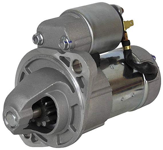

I think that was directed ate Daydreamer41 and you are asking about the solenoid in the photograph.
As mentioned, it is very rare to carry a spare starter motor, but if you need one I would suggest a generic model.
I have both an OEM starter from my Misubishi-based Westerbeke, and an inexpensive replacement starter. I can tell you that the OEM one is much better made, much sturdier, and fits much better. For example, the flange fits exactly into the plate, so you can push it in and it stays in so you can insert the bolts; the inexpensive one flops around, it' very loose in the plate hole. Overall it just seems cheap.
The price difference is huge, I know: $760 for the OEM vis Westerbeke, $109 for the cheap one, eBay.
I highly recommend you keep that OEM one, and have it rebuilt if you ever have to replace it. I guess an inexpensive one is O.K. as a spare.
