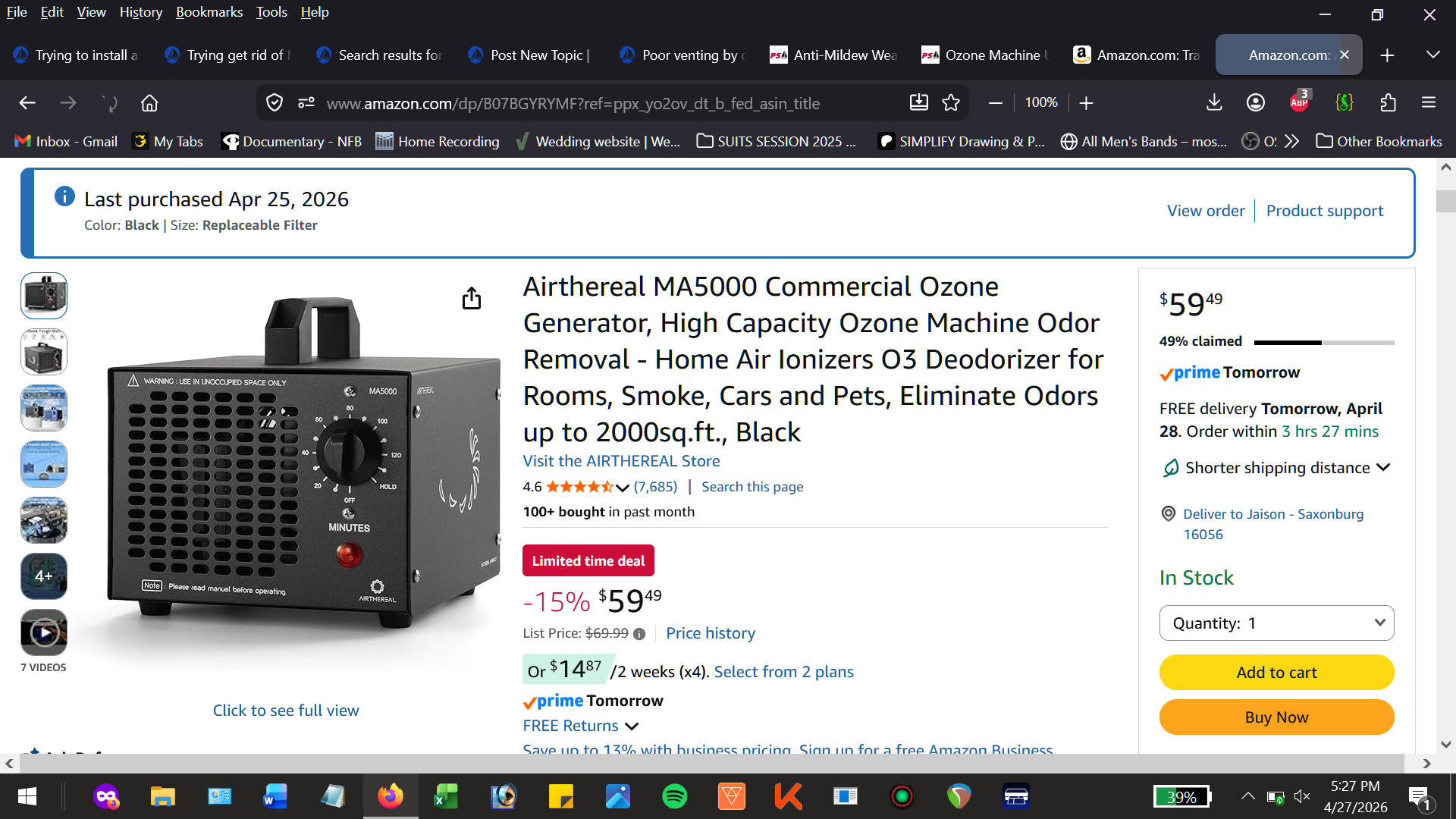

I bought this ozone in hope it will kill!! the molds in these impossible to reach areas.

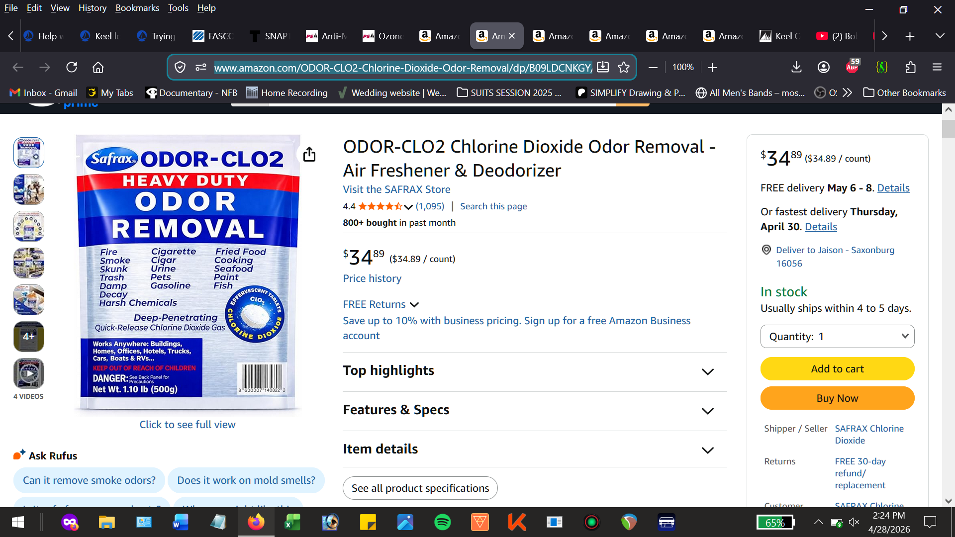

Another approach for hard to reach areas is chlorine dioxide. You can buy a kg of crystal powder on Amazon, as well as "kits" often sold as car or house purifiers. Put a few tablespoons in a bowl, add a little bit of water to cover them, put it low in the bilge then add a shot of muratic acid and close up the boat. Technically, there are stoichiometric quantities to add, but it really doesn't matter with this. Come back in a day and open the boat and let it air out. The ClO2 gas will permeate everywhere and kill everything. The boat will smell fresh, if not a bit like chlorine. Just dump the remaining liquid overboard, as it will mostly be table salt and water with at most a weak amount of muratic acid.
This is my go-to for this type of thing.

Be very careful with ozonators. The ozone produced is harmful to humans and can cause lung damage. So ventilate thoroughly before entering the space.
Ozone will also degrade plastics so use should be limited to only a short and very limited times. Amy plastic materials and boat components made of plastic can be damaged by the ozone.

I am careful and understand the health warnings and concerns with the ozone... and the boat is gutted and completely empty. Just wondering how long I should run that particular OZONE model for to hopefully kill the mold spores in the impossible to reach spots so I don't end up getting sick again from mold exposure?

I have used an ozone generator on my C-22 I let it run for four hours. I left the forward hatch unlatched and when 4 hours were up I opened the all hatches and lazerett hatches and let it air out for a few hours before entering.

Here is an example of a kit for a small space like a C22: Amazon.com
If you want to buy bulk and add your own acid: Amazon.com
I should have been more clear and said you are searching for sodium chlorite, and not chlorine dioxide. Sodium chlorite is what reacts with the acid to form chlorine dioxide.
The kits with tablets you add to water contain sodium chlorite and citric acid in the tablets, so water activates them.
