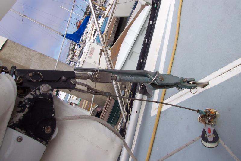

Johnb
1,505
Hunter 37-cutter Richmond CA
This is the quick release I have on my inner forestay.
After springing close to $400 for it I have never actually used it. My really big genoa needs help to get around the shrouds, never mind that forestay.
