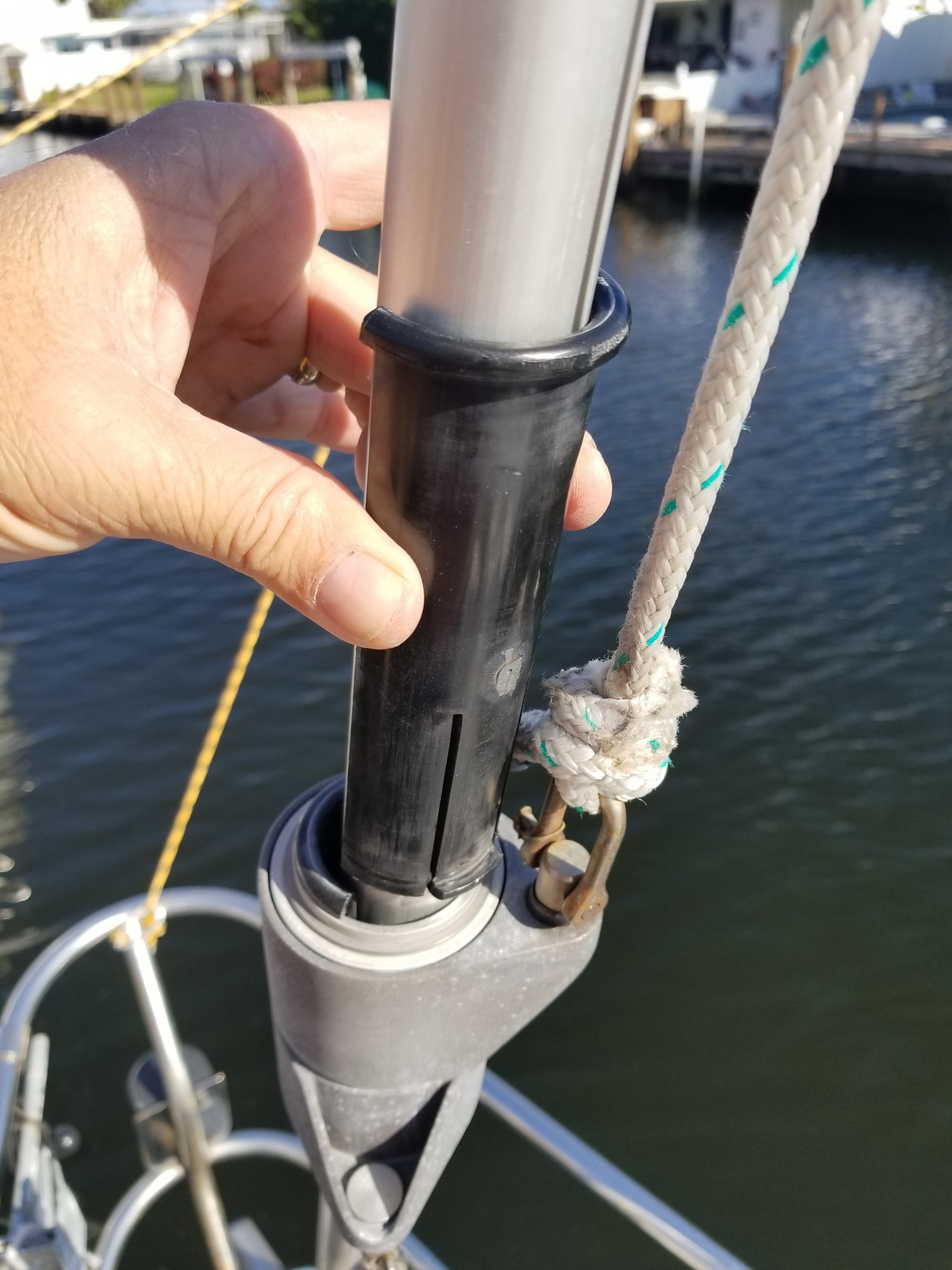

I have a different question about my Hood furler. I pulled my jib off on Saturday to have the UV sun cover resewn, but when I lowered the sail, the plastic bushing inside the halyard end swivel car fell out, and almost hit me on the head. Luckily it did not go overboard, but it took me a minute or two to figure out what it was and where it came from.
It is not broken, but I cannot figure out how to get it back on over the foil extrusion. I think I have figured out how it came loose though.
It looks like I have about 8"-10" of fore-stay at the top that does not have extrusion surrounding it, and the roller car may have been pulled above this allowing the bushing to pop out. I can probably get the bushing reinserted by climbing the mast, and pulling the car up to this position above the extrusion, but how do I keep this issue from reoccurring? Is there a way to push the extrusion farther up the fore-stay so that there is no gap there?

Based on my reading of our two manuals, 1987 and 1992, you should just be able to put them back in. Call Pompanette and ask for the manual, the installation instructions are thorough. Mine are hard copy, or I would PDF them to you.
Can't help with the prevention aspect.
