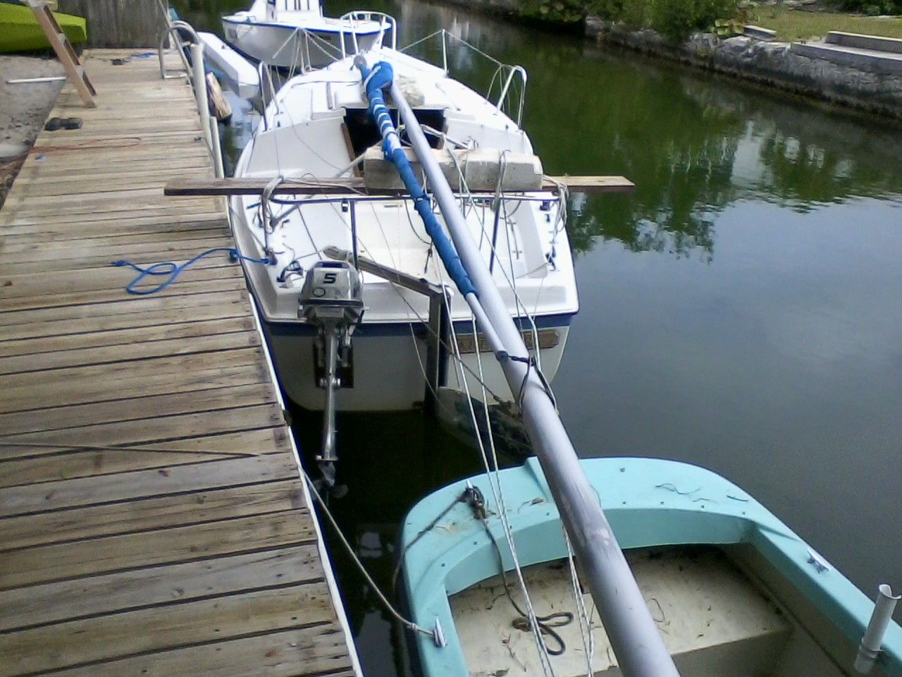

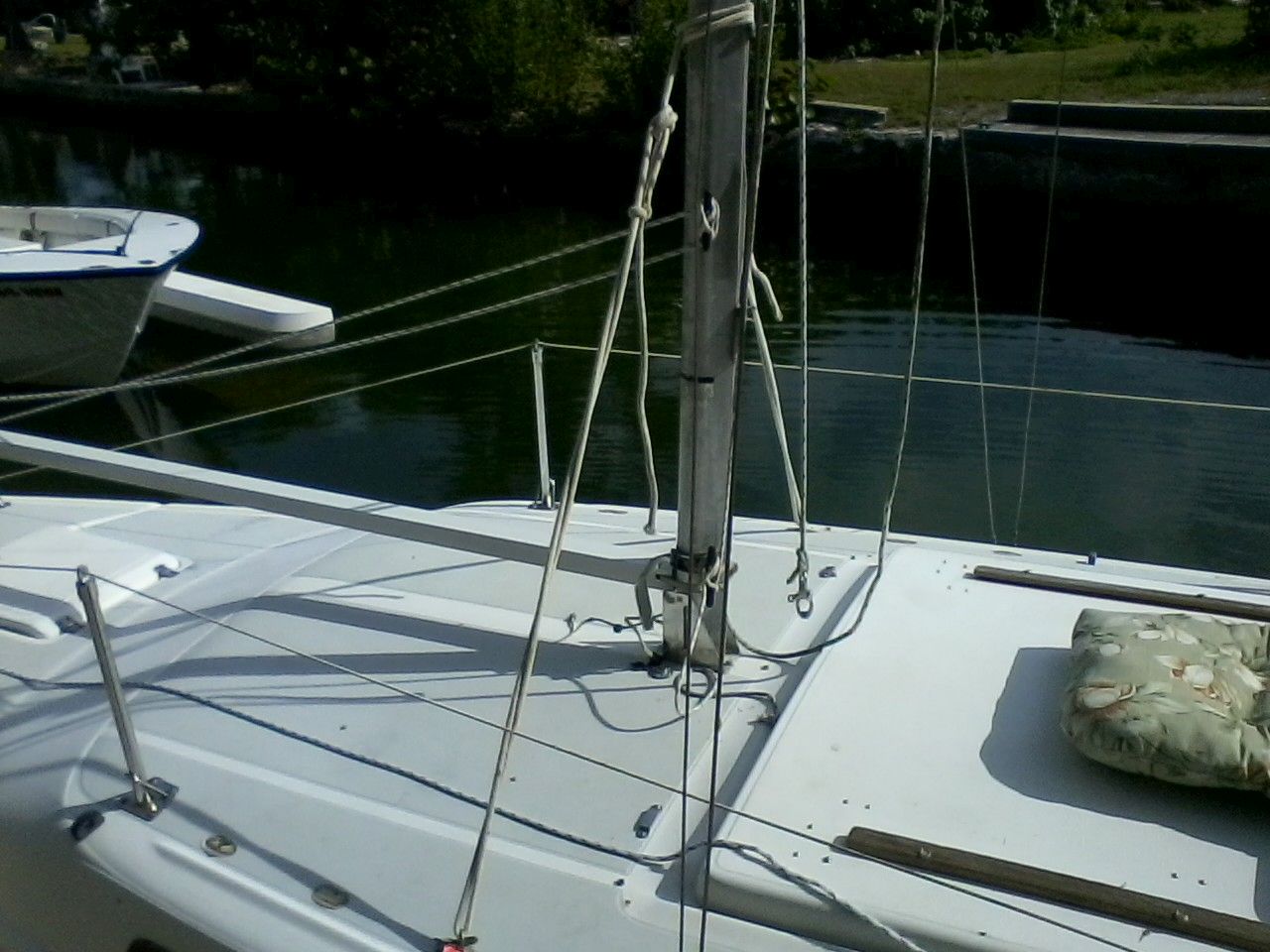

There's nothing on my mast where the top of the baby stays should attach and I don't want to drill any holes. Is there a trick to temporarily putting something on the mast to stop the stays from sliding down?

See if you can bribe a friend with a beer or two to help control the swaying. It looks like you're doing this on the water, so pick a time with no wakes from passing boats.
How can I lower this thing centered by myself?

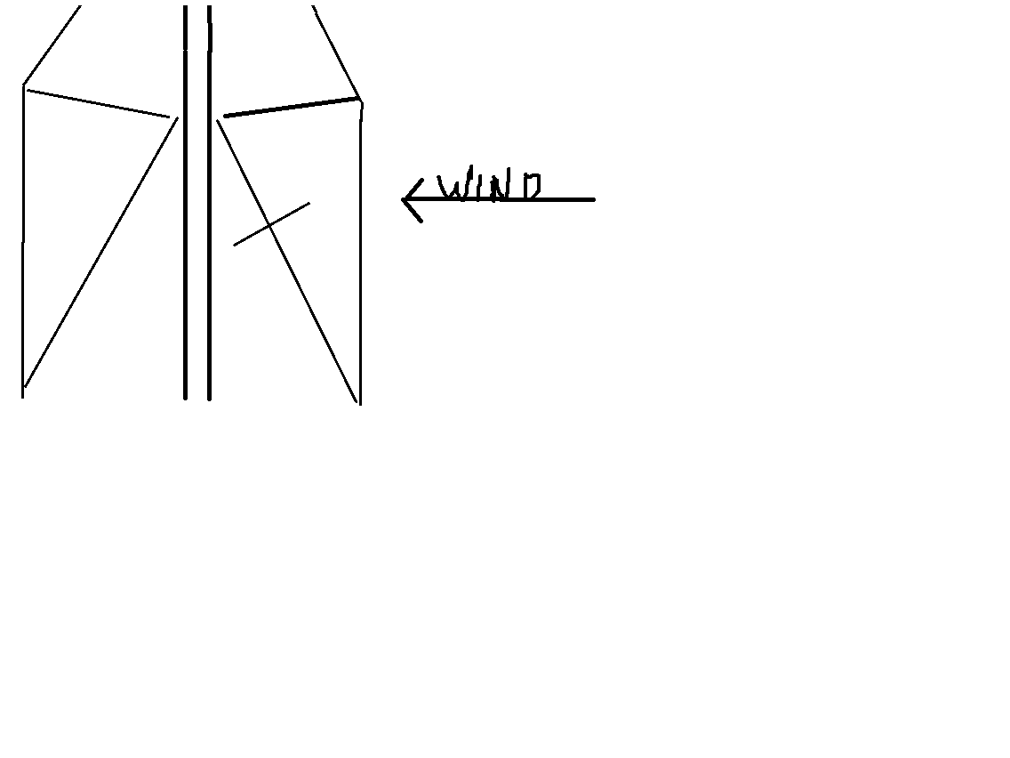

I usually just grab the windward lower shroud and pull laterally against the prevailing breeze as I lower the mast. I pull at 90 degrees to the shroud, as noted in the poorly-done MSPaint drawing attached.

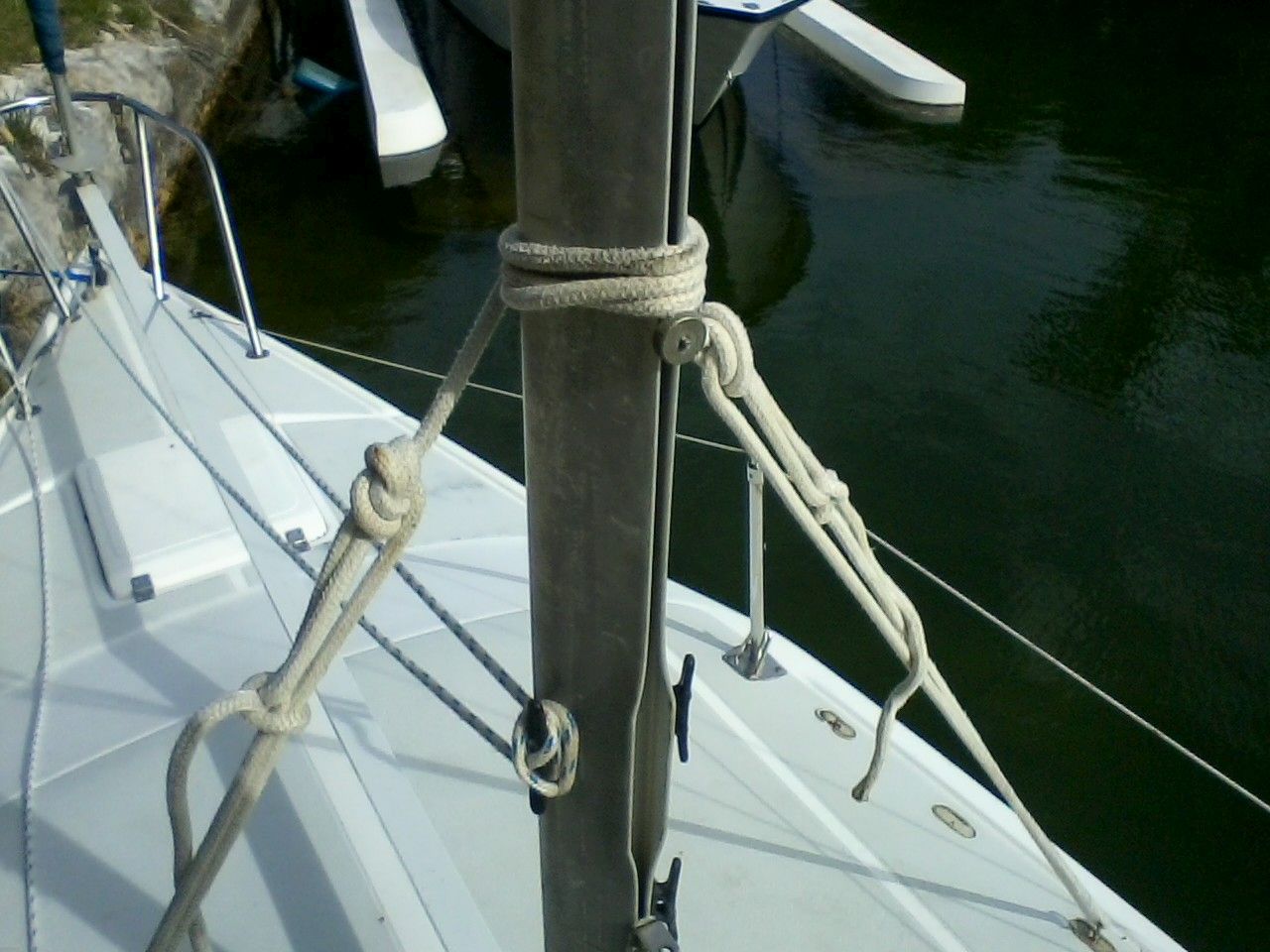

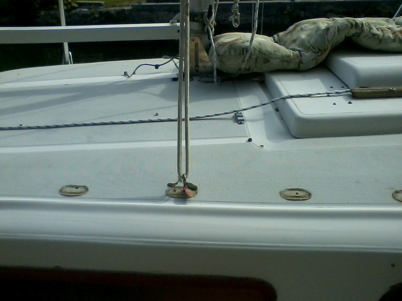

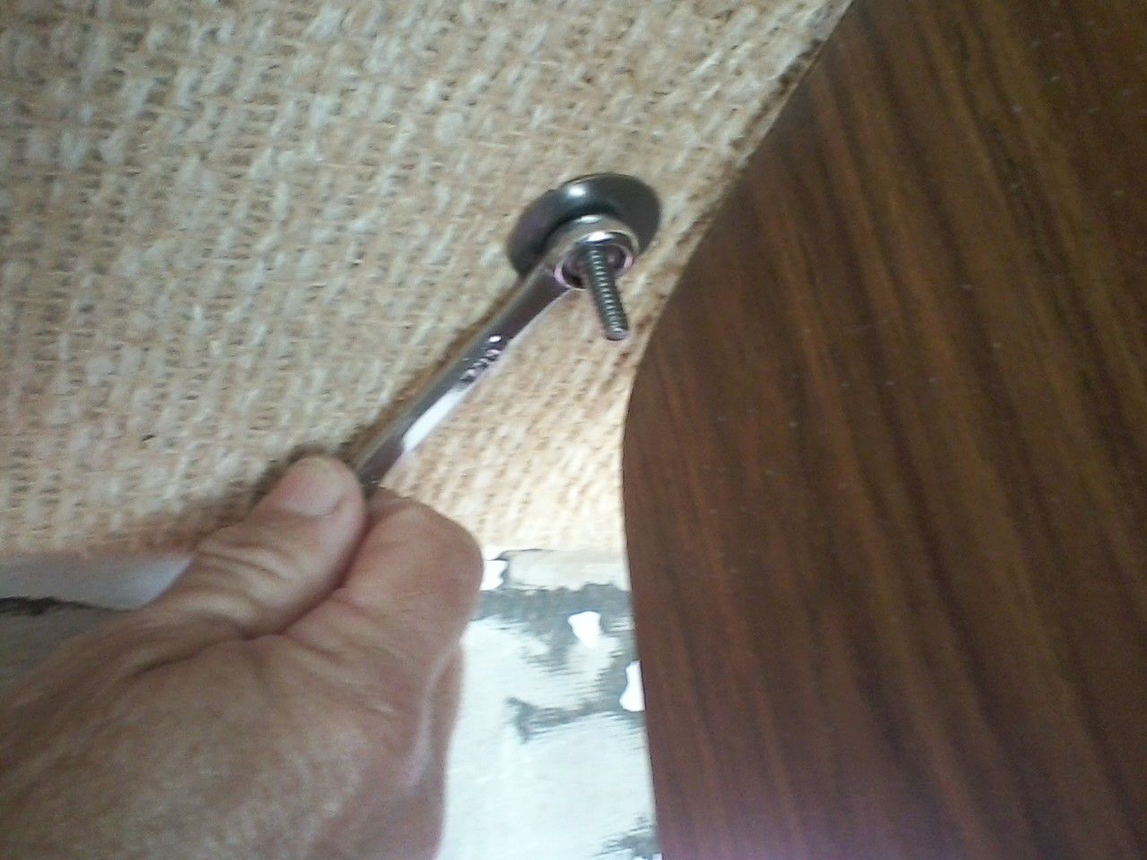

OK, I heard the deck attachment for the stays should be 2" before the mast, OR even with the front of the mast, OR centered on the mast so Since I'm using rope that will stretch some I went with in line with the front of the mast since that's where the holes from the teak rail happened to be. I tightened the stays as much as I could, then wiggled the ropes and worked the knots to gain more rope and then re-tightened, over and over and finally went below to tighten the eye bolts for the last bit of tension I could put on the stays. I could use help but I want to learn to do this for when no help is available. Here I go again...

All went well until right at the end the Gin pole decided to lean way over to port, twisting the mast and threatening to wreck something. But, I know what to do. 1 more block in the stern and I can go forward to work the tackle and steady the Gin pole at the same time. Alternately I can also add a second set of stays to the top of the Gin pole. I do believe I'm starting to get it.

Ok, with the 2 blocks as mecanimal advantage, take the tail of the line around the base of the mast and above the cleats so that the line will slide. Now once you release the forstay, you can move to the mast and control the side sway yourself without adding baby stays.

Yes, you will need baby stays for the gin pole. Looking at all your pictures you did a good job of getting the mast down on the water. Looking where you put your rope baby stays, when you remount the hand rails, just drill a hole through handrail in that location. You can then put in an eyebolt threw the handrail using a nut on top to secure the handrail. You may want to use a stronger fender washer inside as a backer plate.

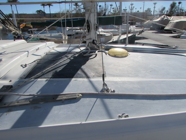

Jun 1, 2007
3,527
I was at my boat (26S) yesterday and took the picture below. The position you described for the baby stay deck attachment is about where mine are (which were on the boat when I bought it). The baby stay attachment on the mast is close to 5 foot above the deck. Always worked well.

Thanks Walt, Bill, I really don't plan to do this again except for going back up. This boat is just a project until I find my next boat. I will do both suggestions, it's easy to use a small line attached to my baby stay anchor points and the top of the gin pole. It won't have to be tight or exact, just snug and in addition I'll run my line forward again around the mast so I'm standing by the pole if anything should go awry.
