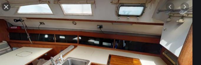

Which port window below do you want to replace? If you have not already might check with the SBO store for Hunter 34 ports and windows in the link below. Also link provided on a Sail Magazine article entitled "Replacing Fixed Portlights".

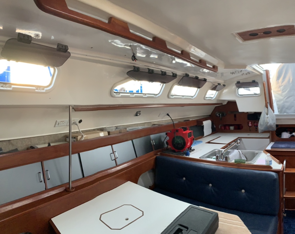

No glasswork. Just measure 3x (template) and cut once and trim to fit with deemed. Use blue tape to mark the outer boundaries of your cut. Jig saw with a blade for cutting fiberglass (not wood). Tape the portlight box to the inside of the window; template and cut from the outside. Do not cut from the inside! U need the perfect cut on the outside.
the windows fit and seal up fine. 6x 1’s; 3x 2’s; 2x 4’s; and 1x 4L and 4R.
10,152
K.. so the 4L&R 's are longer than the existing hole, allowing the radius cut instead of the point of the originals?
Jan 5, 2018
187
Hunter H34 0828 New Orleans
On my ‘86 H34, the original 4x fixed windows were all rectangular and equal in size. The outside had an overlapping plexi which gave the outside a trapezoid look.
