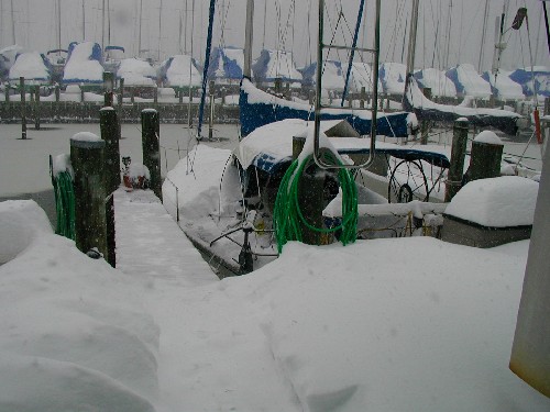

Use the empty buckets to drain the water tanks and use that water to heat up the motor and change it over to the pink stuff. Viola. My small motor doesnt use very much water in the first place, so this was easy to do. Now we stay in the water all year( shouldnt that be one word?)allyear! The marina still turns off the water later in January. Ed thats a really cool picture! hahaha
