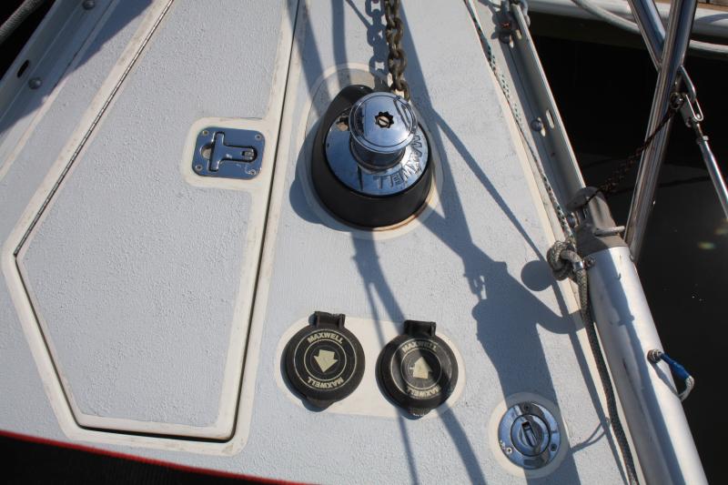

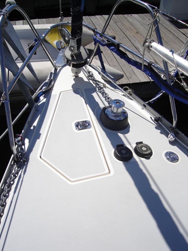

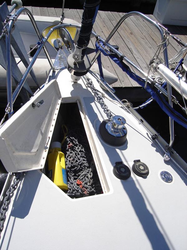

We added a Maxwell 800 to ours in 2004. Here are some of the things we had to have done:
1. Raise the roller furling above deck
2. Cut the anchor hatch in half and glass in the starboard side and made a hatch of the other half.
3. Drop the bottom of the anchor locker about 4".
4. Shorten the V-berth to where the stern portion of the anchor locker ends.
5. Added a battery locker under anchor locker.
6. Mounted the windless on the glassed in starboard side of the bow with foot controls
7. Changed the angle of the anchor roller to give a fail lead to windless.
The boat was just sold so I can't get any photos. I will search my computer to see if I have any pics and post if I find them.

Thank you Just Ducky I appreciate the detailed response and the photos! I have downloaded them and and looking at them closely.
Thanks for the help
