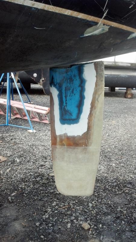

no apology needed, I totally agree.. ive been so busy doing repairs I haven't gone on the interior and spent a minute figuring out a thing.. my only time inside was spent layering glass in the bow..and in north new jersey I was a bit chilly and just wanted to turn the heat on to make it a little more comfortable..
so far I fixed a hole in the bow, straightened out the keel and added 12" to the bottom of my broken off rudder.. but ill get to it
some sanding and ready for gel coat on the bow and bottom paint.. now im on the hunt for a rig..

Looks like rely good work!...:thumbup: Did you use any s.s. all thread into what was left of rudder to add a some strength to the extention repair for normal stress loads? Of Course you still would want to keep some sacrificial break way so if you were to hit something again you would still have some rudder left to get you home...
Feb 8, 2013
92
beneteau 352 Raritan Bay

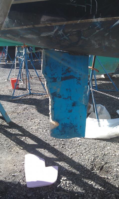

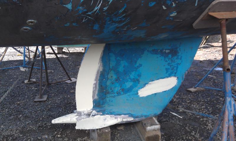

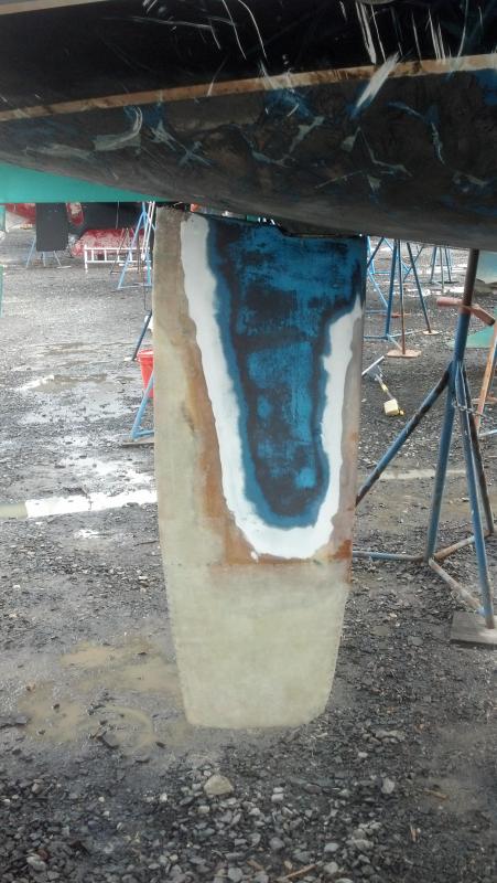

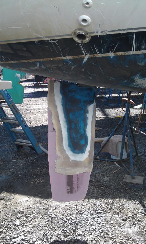

no ss.. the original design basically is a foam core with a 1 1/2" - 2" metal rod going down the middle wrapped in a 1/4" of glass.. as a result of Sandy the bottom 12" broke off, it snapped right where the metal rod ended.. personally I think it broke as it was designed to. id much rather the bottom 12" break off than the rod bend of worse the hull or rudder tube get damaged.. a new rudder is $3500.. so ill try to fix it myself first if it doesn't work out we'll go with plan B.. and I know if the S##t hits the fan I can limp back home missing 12" ..
you can plainly see that its foam core ( same consistence as "spray foam" ), no wood in there at all.. so I got the idea of regular foam board that you use to insulate the exterior of your home.. I took a piece of card board walked over to one of my fellow boater's Bene (unbeknownst to them) and made a template.. bought a 1 1/2" piece of foam, cut it and shaped it with a palm sander and layered about 20 sheets of glass, bi axle , mat and mesh.. I ground down and tapered the bottom 6-8" of the rudder and layered the glass on that to give it some meat to hold on to.. its hard as a rock and a pretty good shape..
if it doesn't work out it only cost me about $150 in material and a couple days out of my life and after I just spent my nut just buying the boat, I have more time than I do money.. but honestly im feeling pretty optimistic about it

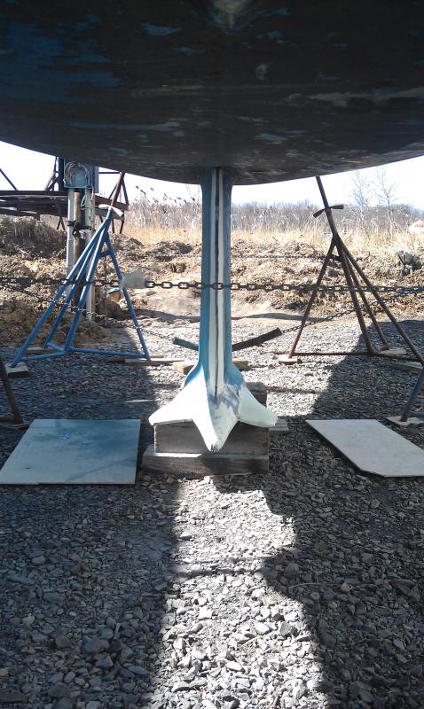

Way to bring her back knot smart! Looking at the view of your keel, it appears that the hull is deformed - deflected upward. Could be a visual thing, but if it is check your internal grid structure and make sure everything remains properly bonded to the hull. Look at your keel bolts for signs of trauma.
Good catch Gunni..... I had not noticed that before while studing the picture earlier. May need to have some similiar work done like this guy.....Lets pray its hopefully not as extensive. http://s454.photobucket.com/user/DavidJCooper/library/Hunter 356 Passion?start=all
I did notice that before I placed a bid on the boat.. I pulled all the floor boards and looked carefully.. there are no cracks around the ribs ( bulkheads?) throughout.. from both the interior and exterior there is no cracking .. where the keel bolts up everything is clean.. but still I acknowledge your observation.. I cant figure it out.. I want to say its just the fiberglass hull flexing because theres too much weight on the keel and not distributed evenly on the stands...but then everything ive read says there should be no weight on the stands.. I even saw a pic of a beached boat standing perfectly out of the water balanced on just the keel ...I don't know .. but every comparable boat I see for sale cost about 75k- 90k..and I stole this one at 8.5k...so if it flexes a bit...oh well.. :) ill get some insurance, sea tow, eperp and I have my cell phone... im going sailing!!!..
